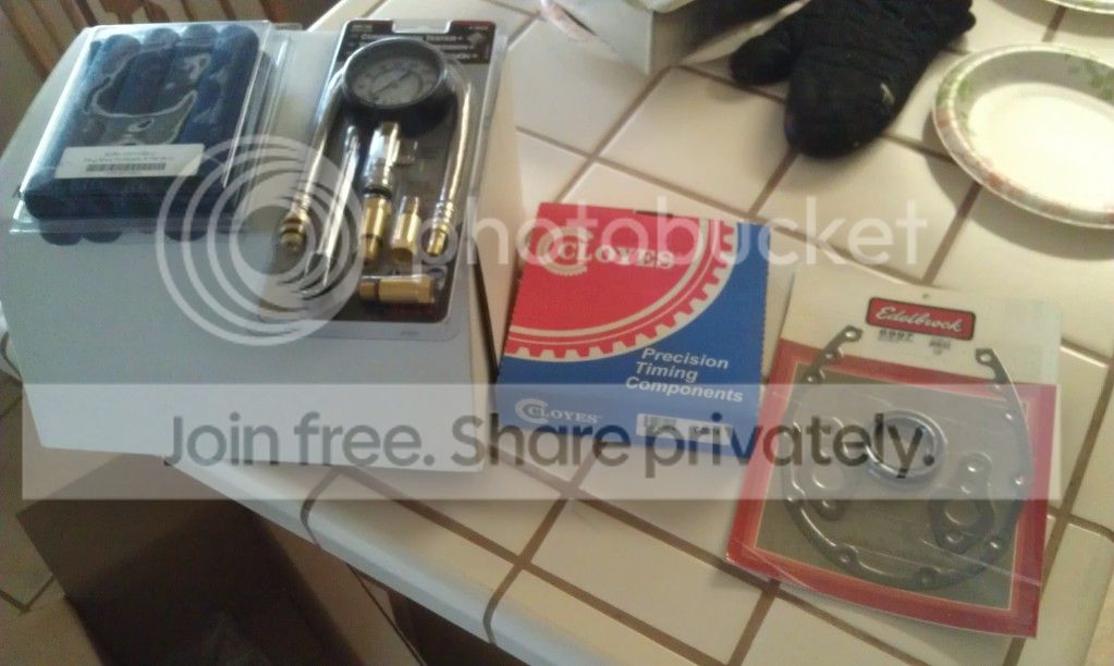

Parts showed up while I was at work today. New water pump, gaskets, timing set, spark plug wire insulators and a compression tester.

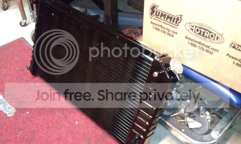

I dropped the big radiator off at the shop down the street from us today and they're going to boil/pressure test it and have it ready to go by tomorrow.

You couldn't get those gaskets cheaper buy buying felpro ones from a parts store? I rarely use summit or jegs unless it is only speed parts.
Possibly but their prices are good and its usually about $10 or so to ship it to my door so it's worth it. I can get exactly what I want and don't have to drive all over town to find it at 5 different stores.

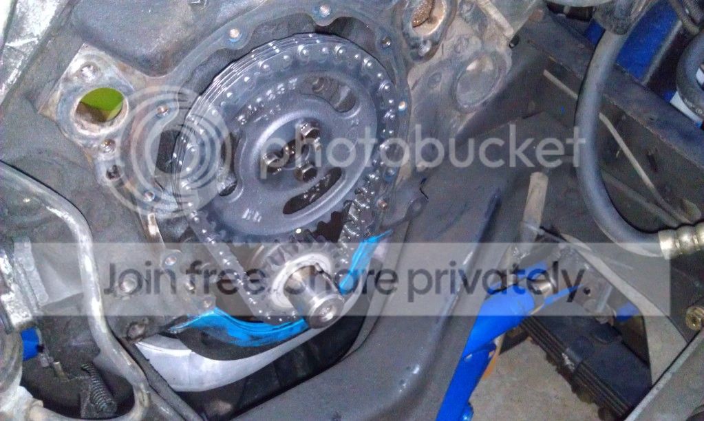

I had to go buy a small puller tonight because my puller wouldn't fit between the face of the block and the back of the crank gear. So after I got back I pulled the gear off, cleaned stuff up and got the new timing set put on. It's quite a bit tighter than the one that came off.

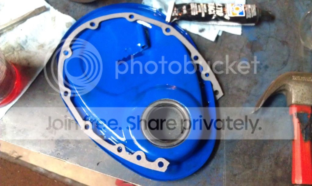

Is it easiest to loosen the bolts on the oil pan and lower the front lip of it then put the timing cover on then put the pan back up? I did a dry run with it tonight and it seems like the oil pan seal is going to fight me a lot to get it into the little groove on the bottom of the timing cover.
Also should I use rtv with the gasket? That's what was on there before but I didn't know if that was right.
Oh and I picked up the radiator today during my lunch break. They boiled it, tested it for leaks and got it all cleaned up. He said it's a nice radiator without having the plastic tanks and should work well compared to my little two core I currently run.
That's what I would do, as far as the pan goes. :D I don't think you will need the RTV.
