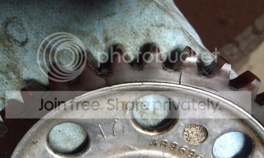

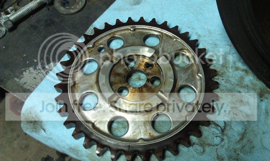

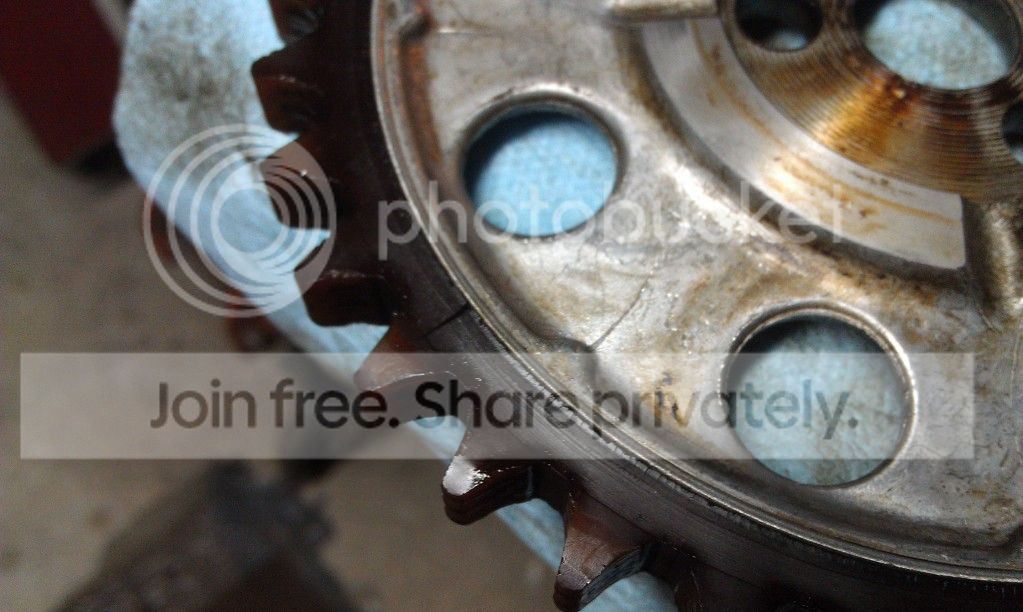

I pulled the cam gear off and it has quite a few cracks in it. I'm still surprised the outside of these are plastic.

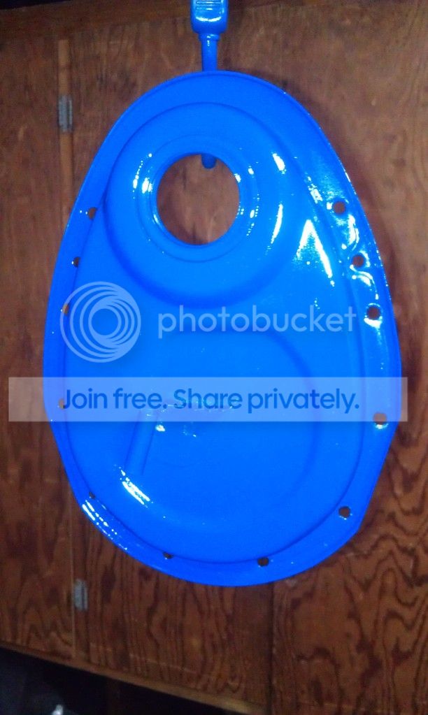

That's the old seal in the cover, figured someone would call me on painting the lip of the seal. :)
Cracks...

I like to wire a ford start solenoid to the starter and have all the wires up high and only one power wire that goes to the starter only when starting. Those stock silent timing chain gears are known to crack and fall apart. I am actually suprised it hasn't.
