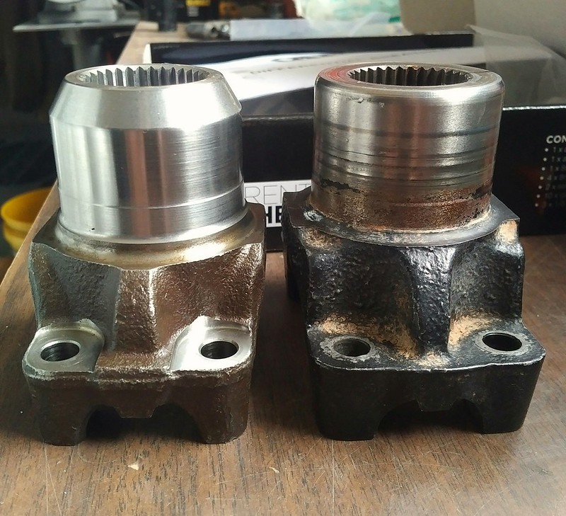

So while I’ve been crawling around under the truck and mopping up oil with my hair I noticed the 205 had been tossing some oil, which pissed me off because I really really hate leaks. The fact I jumped through my very own asshole to carefully seal this 205 makes me that much more upset. At first it looked like just the rear output seal was leaking then once I got the yoke off I had a sudden revelation about being over budget during the NV4500/205 rework back in 2013 and using a yoke that should have gone into the trash. The yoke had pretty deep wear marks in it where the seals have been riding for decades. I thought about getting a Speedy Sleeve but thought better of myself so a quick poke of a computer mouse and exchange of emails with Chris at ORD a nice high quality yoke appeared the next day.
Anxious to get the work travel out of the way to start putting this all back together. The story of the NV4500/205 redo back in 2013 is HERE starting at post 284 (thought I had it on CK5 too but can’t find it)

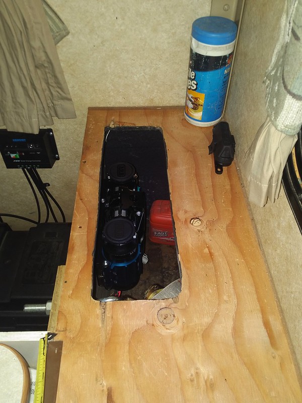

Well, things are happening slowly but surely. Finally got the ARB Twin compressor and tank mounted as well as the outside air outlet plumbed. Still waiting on a few more fittings to plumb the compressor to the tank and finish up the compressor wiring. You can see the compressor wiring still dangling from under the truck
Compressor mounted down in between the camper and inner bed wall

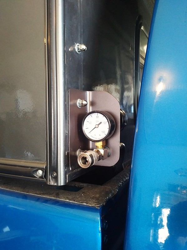

Outside air hose port

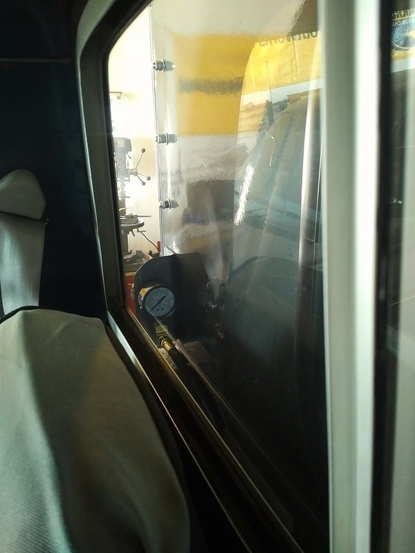

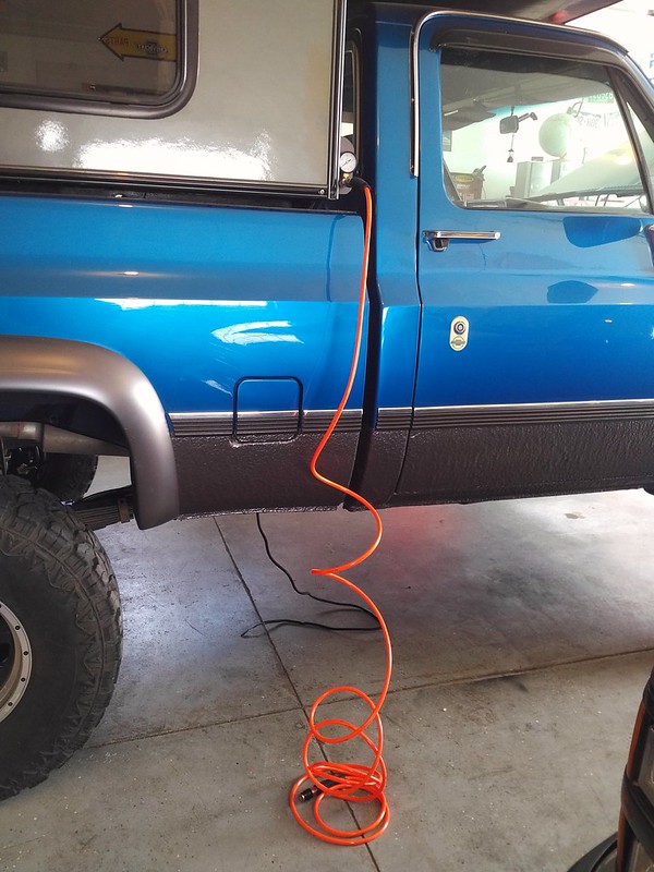

A second gauge viewable from the driver seat. This was a last minute idea as I was cobbling fittings together so I ran back to farm store for one more gauge. Sure beats running a gauge into the cab. Just hope those gauges live out there in the weather and vibration.
The nifty ARB air hose reached all four tires too!
I really like the install of the system so far. The second gauge was smart. Good work dude!

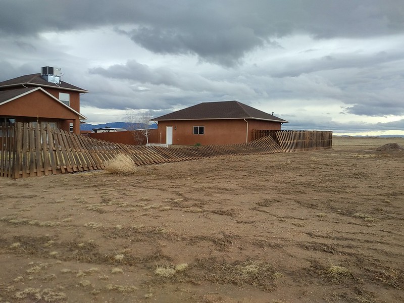

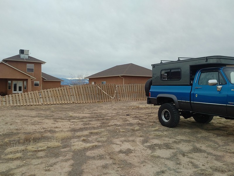

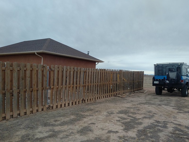

The K10 got a small test drive yesterday. The Big Bad Wolf blew down our fence last week then we’ve had nothing but rain and snow since. Yesterday the ground was finally dry enough to winch it back up without pulling the poles out of the ground. The fence is trashed….poles bent, 2x4’s and pickets broken everywhere but at least it is standing up and will make due until I have time to rebuilt it in a few weeks. Always something! :mad2:

Once the fence was pretty close to straight up each pole had to be pulled to the West

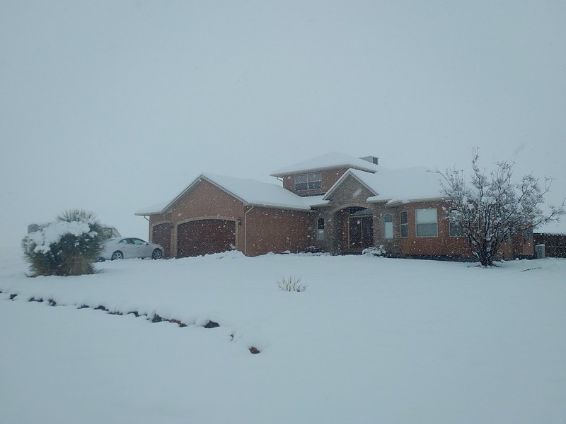

Then today we got this! So glad I got the fence back up before this big soaker came in.
It was heavy wet soaker that we desperately needed. Also a good excuse to saddle up the Polar Bear to take the little one to daycare with detours along the way :biggrin:

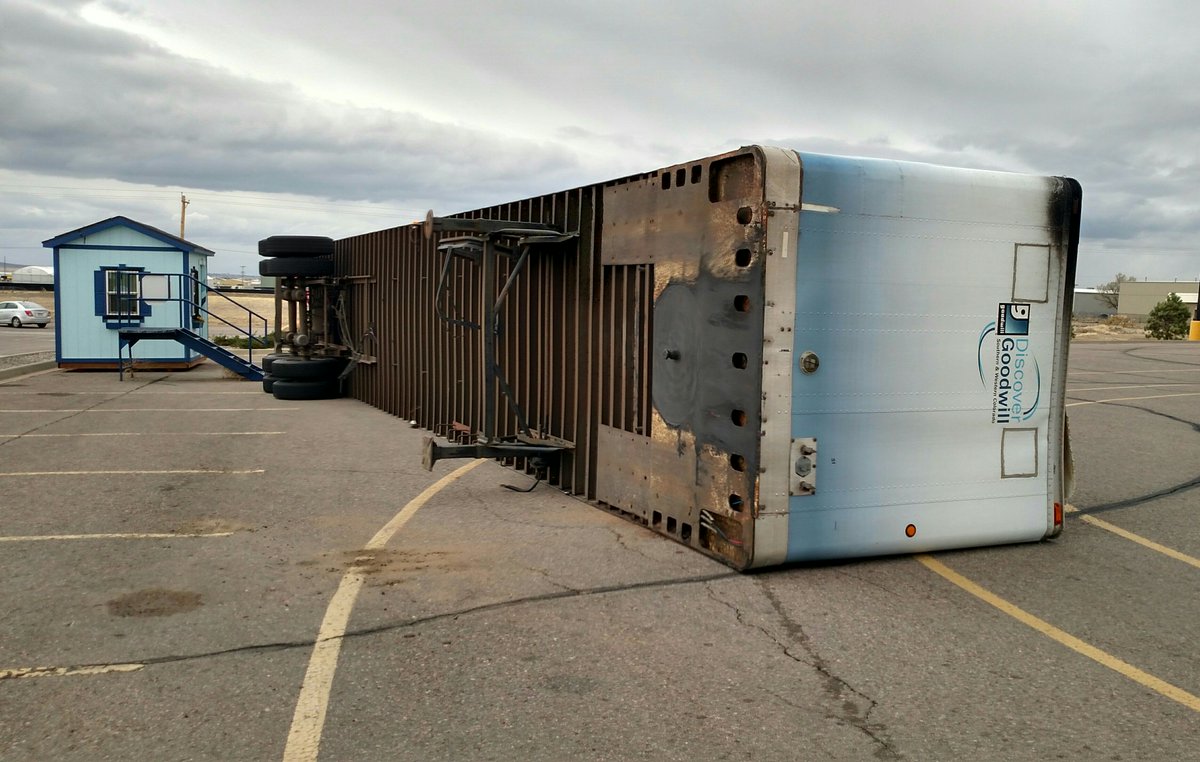

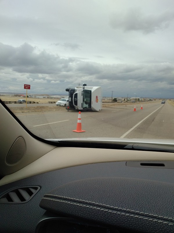

Frito-Lay truck got blown over on Hwy 50 last Friday morning. One of many high-profile rigs that got blown over
Employee smoke shack at our local Wal-Mart
Goodwill trailer at our local Wal-Mart
