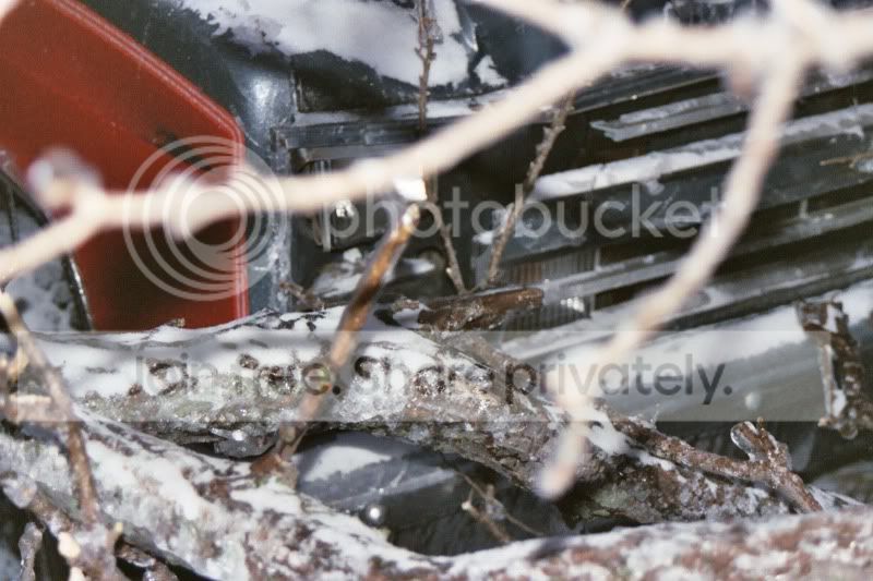

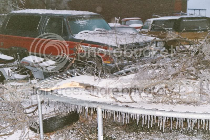

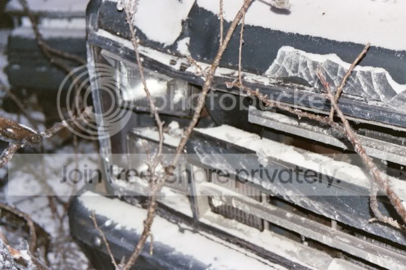

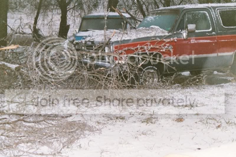

Some neat old photos of when the tree fell on the truck 5 years ago. been trying to get camaro done by the first, so nothing done on k5. as soon as finals are over and camaro buttoned up i wanna tear into this.

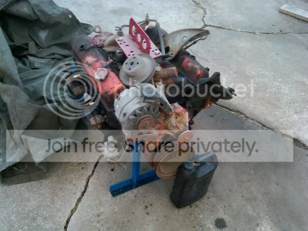

picked up a fuel pump water pump and timing chain, already had the gaskets at home. Need to move dads 66 then i can get at the A frame to get the motors out of the junk truck. getting closer, but have been waiting for a week for dad to touch his 66, but he keeps refusing to do anything to it and its getting old fast. For whatever reason after changing the radiator he never put coolant in it, yet he wont go look it over make sure he finished everything and put coolant in it so i can move it. I dont wanna go against him and move it and really piss him off, but im tired of waiting on him to do it. Times like these make me wish i was out of school, working 8-5 with my own garage. Dont need a house ive got couches and bench seats :D
