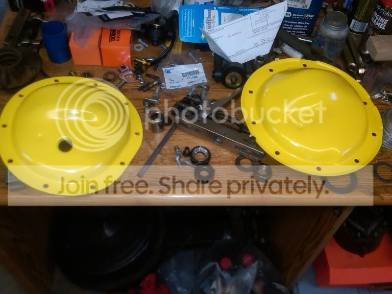

KansasTwisters 86 k5: (8/13/2011 axles ready to go in, Diff covers painted)

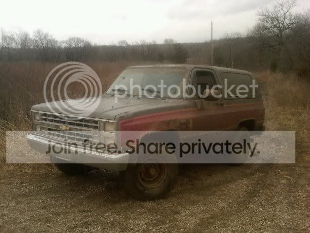

These are from a few weeks ago, but finally posting them, been part busy, part lazy. DD'd the k5 till it started getting 90+ this week, and the 83 has ac. Kinda debating if I wanna fix the ac on the k5 or not, but the c10 is going just fine for daily use, and gets better gas mileage anyway.
Current goals for k5:
Take carpet out, fix rust, make new side panels from abs and install new speakers
Brakes are making a little nosie and I want to replace the rubber lines because I dont think the rears are working but everything looked good both times I had them apart so it could be a line collapsing from age.

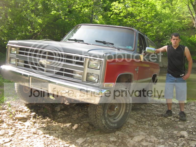

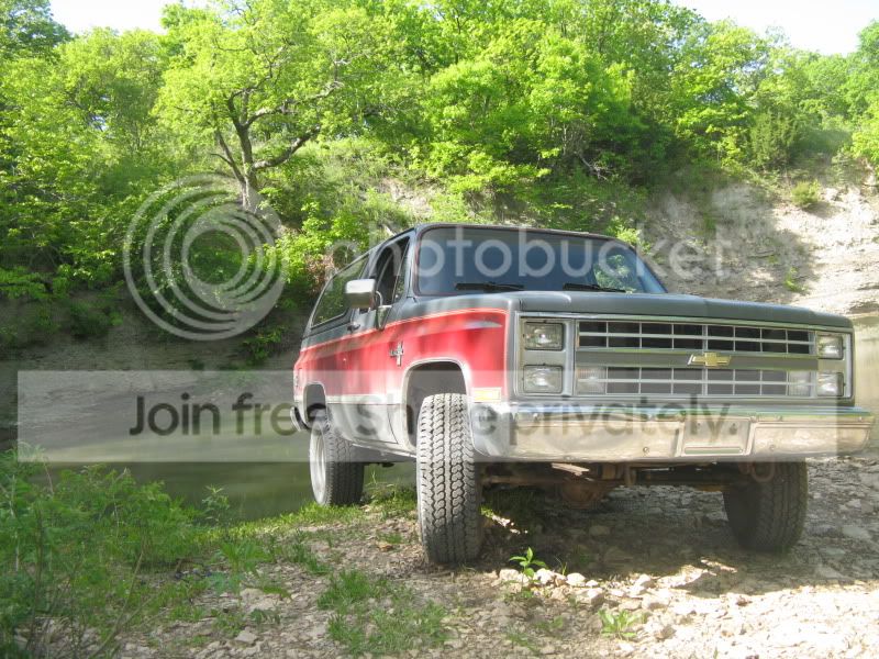

Photos were taken for a photo class on a low maintence/abandoned road south of town (As you notice the creek took over the roadway), and the first picture was at another creek but around the same lake. Figured id post a shot of my ugly mug with the truck, I had rolled out of bed grabbed the camera, picked up my girl and my sister and hit the highway so im far from dressed to impress.

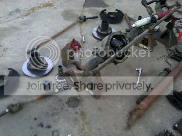

Bought a 4.10 rear with a powertrax no slip, stock rear driveshaft and a front 3.42 with a set of new warn premiums from willie (Wheels87k5) and took some time today and tore the front end down so I can swap it to a 4.10 setup. I'm debating either leaving it open or swapping in a second gen camaro limited slip unit, would be better than a locker on the front as far as steering goes but I'm not sure if it would be of any benefit. I got more than a few spares laying around so it would be free to swap in and I'm gonna be in there anyway. Thoughts?
Never tore a front axle down this far, It was a good learning experience.
Heya....I know you'll really like the 4.10s. And we made it home safely and lighter. :waytogo:
If it's anything like the dana 60, swapping gears won't be that bad....unless the front 10bolt has the crush sleeve. Still not bad...just gotta know when to say when for the preload. Go past the limit and you'll have to do it again. :whistle:
I did some searching a while back on this and it seems Detroit and Powertrax were the choice. If the Track lock in the dana 60 doesn't perform then I'll try one or the other.
I like the powertrax no-slip that's in the rear 10bolt. So maybe the same for the front?

Well since this is gonna be my winter driver, aj and russell have convinced me I'm just gonna leave it open up front. Ideally an air locker or e locker would be perfect, but I'm not gonna drop that kinda money down for this axle, especially since it will kill front shafts like 12 gauges on zombies. Eventually I plan to dana 60/14b it so these axles won't be in forever.
