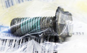

It just occurred to me small block Ls flex plate bolts need to be thread sealed. Do our L18 8.1L bolts have the same design being the one piece crank seal? I changed my seal carefully and it wasn't leaking till it was fired again.
I don’t follow the LS world enough to know what you’re talking about by “Thread Sealed”. But, probably not…….when you received new 12563485 bolts from GM they have a thread locker patch on them and that’s it. Not sure if that bolt part number is the same for automatic flexplates as it is for manual trans flywheels.
Just thought it may be worth discussing when the engineering could be shared as early Ls engines were known for leaking this way
Leaking oil out of a blind hole in a crankshaft? I guess I’m not follow how that is even possible :dunno:
8.1s did have an issue with the intake bolts that were threaded into open holes into the intake valley on early engines that caused oil consumption, but not leaks. Around 02 or 03, they made that hold blind to avoid the oil from creeping up the intake bolt
I
Remember the bulletin about the intake but apparently the crank holes in Ls cranks are not blind. I didn't think to check when I installed my new flex plate after installing the main seal. I still have a slight leak at the bell so before I drop the entire trans etc I thought I'd check
I
That’s the craziest thing I’ve ever heard but Google says its true. It looks like there are some threads out there on the interwebs of guys having such an oddball oil leak on LS engines. I have a L96 6.0L sitting here on a stand that has blind flywheel holes in the crankshaft. That leak must be something with early ones :dunno:

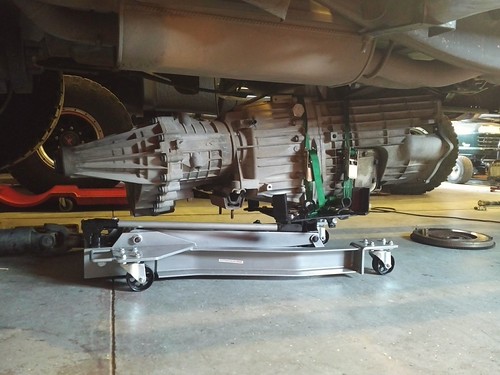

friend of mine scored a 05 2wd 8.1/6 speed stick truck for the drive line .
he wants to know specifics on making the trans take a t-case or just go divorced ?
and who is a good solid place to send harness and computer to to make it stand alone and a little power bump .
Wow, that’s a pretty rare combo to stumble across. I don’t know what it would take to convert a 2wd ZF to a 4x4. It maybe as simple as changing the rear cover, adding a different tailshaft or as big of hassle as replacing the main$haft, etc. Some parts catalog researching and part number comparisons need to be done to determine that. In the end, a divorced transfercase would probably be the hot ticket.
As far as a harness, I’m not a fan of paying anyone to rework them. Some guys have done it with great success and others have been a total nightmare. My preference would always be to start with a brand new stand alone harness from someone like Howell, etc.
Here is a picture of the ZF in my Silverado when I popped it out a couple years ago to replace the rear main seal. That trans is huge!
