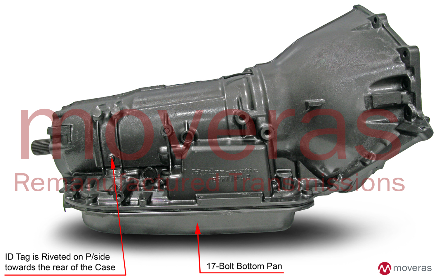

That by chance the 4l85e? Being behind an 8.1 I could see it.
It should be a 4L85-E, which started in '02 or '03 and this was one of the platforms for it. AFAIK, the 4L80-E and 4L85-E share the same case, so you'd have to find the tag. It's not a sure thing because some 8.1L trucks came with 4L80-E. The differences are basically different planetary gears and some say an additional clutch plate in 1 or 2 of the clutches. This moved the torque rating from 440 to 460ft-lb, not to be confused with the rebranded from "Hydra-matic" to "SuperMatic" 4L85-E, which was rated as high as 690 ft-lb. (If you're searching). I'm not sure what's different internally, but GM underrated the '80 and '85 to begin with.
FWIW, my 4L80 has the recessed drain plug, as do both of my 4L60's (although I'm pretty sure one of those came with no plug, so I drilled the hole and added it).
