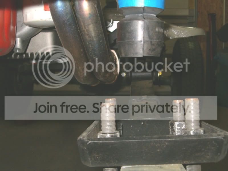

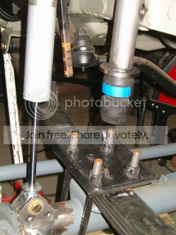

I'm diggin my Timbrens....never harsh like poly or rubber bumps I've had in the past.
The blue tape line is how much the timbren compresses...in this case about 2"

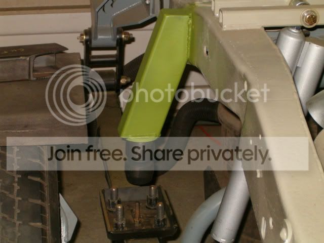

The rear setup:

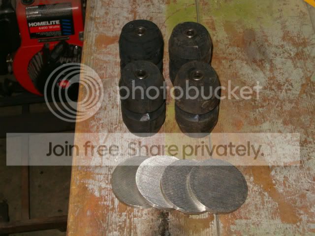

just for the record, they mount with a bolt through the center into a mounting plate of some type,(I made my own plates)...I had to carve out some of the access hole to get a socket onto the bolt. Or one could use a socket head capscrew and a long allen wrench.
