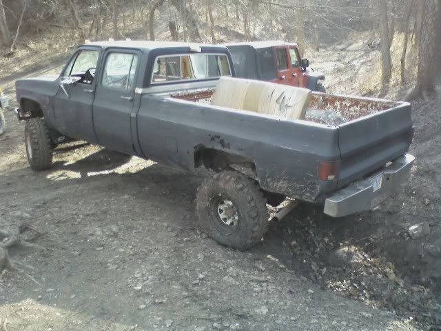

Lifted crew cab dually. C to K conversion.

tell me what you think; 1979 crewcab, 6bt cummins 15 speed eaton fuller, rockwell 200, 2 ton front and rear, with 24.5 in wheels wrapped in continental rubber.
Im lookin at gettin the 35X10.5 Swamper SSR's. They would fit on the stock rim and I could get away with using a smaller spacer, much cheaper and can use actual hub studs. Considering the other truck I am building is completely ridiculous I figure I should probably keep this one a c-hair under the radar.

The 2WD TH400 was fresh when I bought the truck. Rather than mess with it (i.e. rip apart for a new tailshaft) I figured i could find this T-case, mount it somewheres down the frame rail, get some shafts cut and balanced, stick it and kick it.
