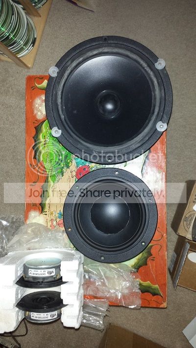

So, first round version of door pods has started.
I want a more flowing design. But I'm new to the UV fiberglass resin, and still a novice with fiberglass in general really. So I'll go this route first, and fancy them up some day when I'm more confident if I feel the need.
Red is 7" placement, purple is the 6.5"
