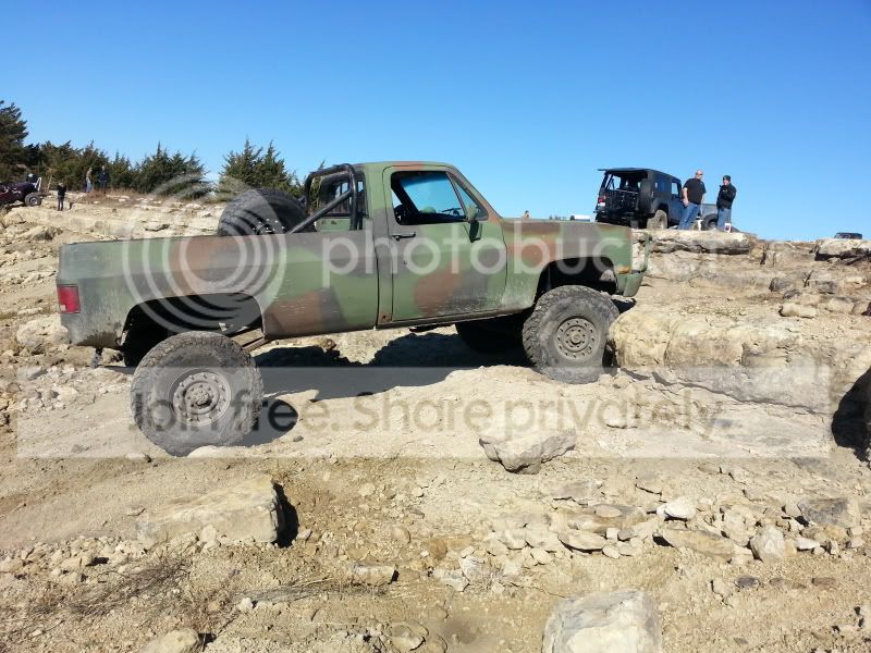

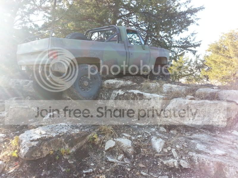

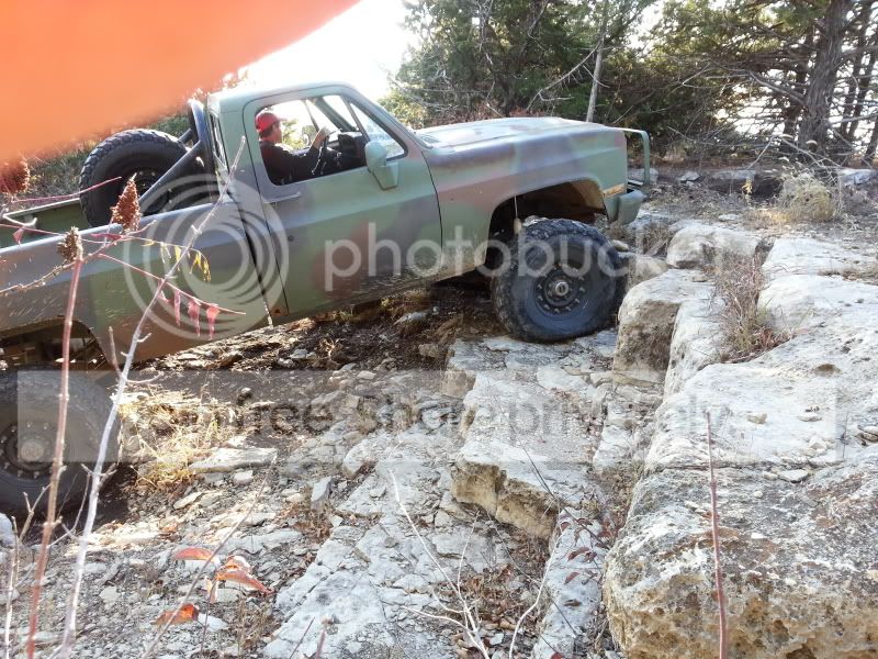

Got back from the maiden voyage today. Drove it 3 hours down to Tuttle at 60-65, wheeled two days and drove it 3 hours home without even the slightest hitch. It performed flawlessly and I was able to do anything that anyone else did. Thanks Mike, you built a great truck!
I'm happy that you're happy with it! It's nice to see it being used what it was built for :)
Awesome!
Super glad this went to somebody that used it for how it was built. And even better yet, kept up on the thread for all us whores.
About 13 average for the whole thing. Used a total of 25 gallons from my house north of Lincoln which is 140 miles, wheeled two days, and back. My speedo and odo are off so going by mapquest.
Was cool to see this thing climb some rocks finally! I like the grooved baja's even more from seeing them in person.
