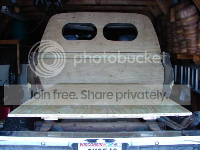

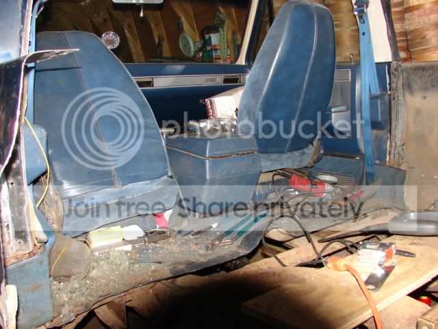

I just finished rough cutting the pieces to box in the cab. I was hoping to make a slanted roof safari style extended cab so my dog had a place to comfortably ride but the floor was too rusty. I ended up cutting the floor out to the rear cab brace before it was solid. It will end up looking like a pickup cab. I will have to save my original concept for when I make a tube body. At least I don't have to worry about the back end falling off the frame anymore.

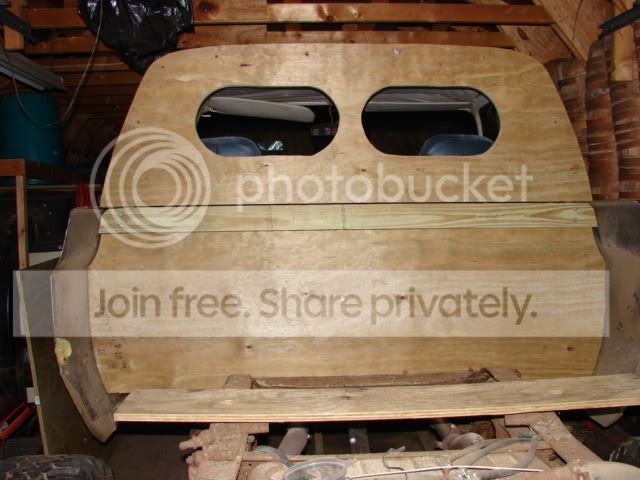

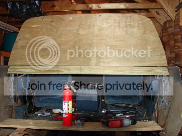

I spent a couple of hours grinding the remainder of the topper seal lip flush with the roof arch then installed the cross brace and top section. I am using the original holes and bolts for the topper to attach the top section.
I finished drilling the topper holes in the top section then I finished cutting and grinding the floor flush with rear cab brace so I could attach the lower back section mounts through the floor and rear cab brace.

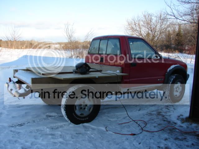

Rough cutting the bed's floor in 0 degree wind chill.
I got the bed's framework built and bed's rough cut floor in place.

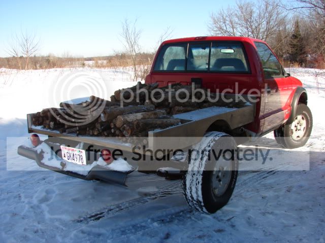

No progress on Jiminy today. Since it was 15 degrees above zero I got a load of wood out of the woods. Most of it is Ironwood with a high BTU content. I will be applying Herculiner to the panels soon so I need a good supply of wood to keep it warm in the shed while the Herculiner dries. After that, I had to throw wood down into the basement to heat the house.
