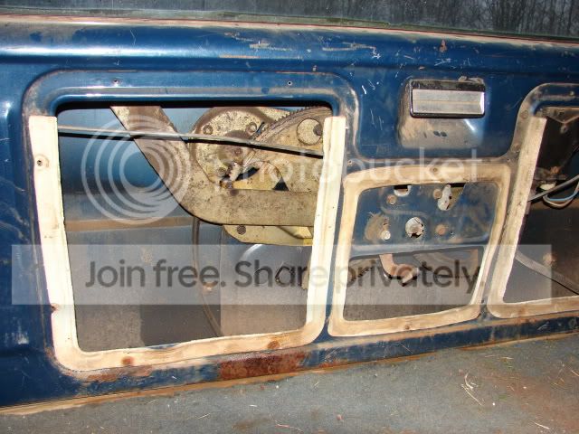

...would you by chance still have the tailgate inside panel still removed ?...I have an 85 that i'm rebuilding the tailgate (electric internals) and i am getting conflicted answers on which way the bottom window sash (metal channel where glass is mounted to) is mounted to the regulator...is the "L" on the sash mounted up or down on the regulator arms ?
Thanks for any help you can give on this matter

Does the picture below help you?
http://coloradok5.com/forums/member.php?u=50711COWBOYK5BLZR wrote i am getting conflicted answers on which way the bottom window sash (metal channel where glass is mounted to) is mounted to the regulator...is the "L" on the sash mounted up or down on the regulator arms ?
I do not have an "L" on the bottom sash. The regulator arm clearly shown in the left box of the picture above attaches to the bottom sash in a straight channel piece approximately 7 inches long.
yes ...isnt there a flat piece welded to the long sash that the window channel is in where it has 2 bolts connecting to the regulator arm (shown) on each end of glass ??
when i refer to the L piece I mean the bracket that is tacked on the window channel (sash) that is connected to both regulator arms
heres another pic i found on here...but mine is mounted upside down of this one..

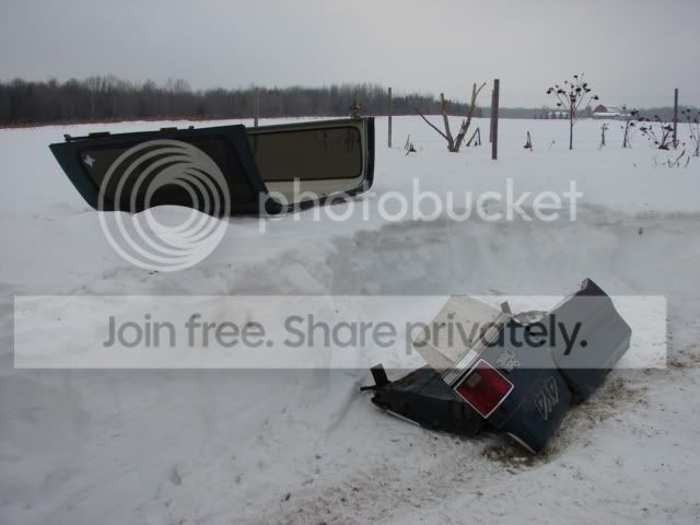

I made a little progress this morning. I got the glass out of the tailgate and the tailgate off then started cutting.
