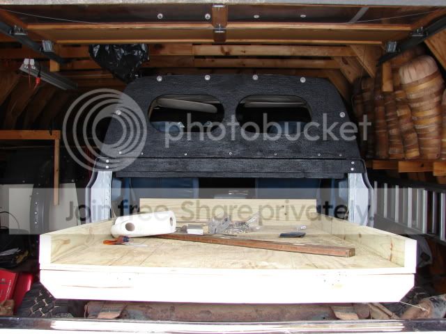

The cab panels and bed ready for Herculiner.
All the wood will get 2 coats of Herculiner. I have encapsulated wood in epoxy resin on other projects but with treated wood I have determined that Herculiner is effective and easier to touch up and repair.

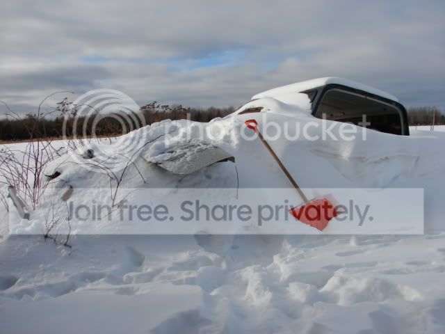

I had to spend a couple of hours on my 800' driveway plowing 7" of snow but I was still able to finish applying 2 coats of Herculiner to the top section and tie in brace.
My plow rig is a 1971 Jeep CJ5 with a 225CID odd-fire V6, CRT Performance HEI distributor, Heddman headers, 390 Holley 4 barrell, FlowKooler high capacity waterpump, 100 amp Proform alternator, Optima battery, T14 3 speed transmission, Dana 18 transfer case, Dana 44 rear axle and a Dana 27 in front.

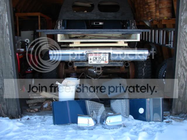

I did not have enough Herculiner to finish the bottom section so I started preparing the exposed surfaces from all the cutting for priming then cut off the ends of the bumper. I couldn't get a picture because it was snowing too hard.

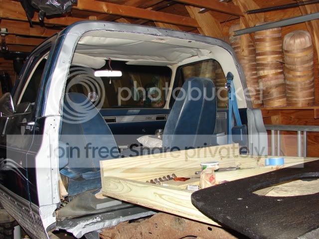

I cut off the passenger's side cab wing then made the final cuts to both sides of the cab. I had a cutoff wheel disintegrate while doing the final cut on the driver's side. That is always interesting. I started cleaning up the floor area for primer. I won't be able to paint for a couple of days. The outside temperatures will be too low at night for my uninsulated shed with only wood heat to maintain enough heat.

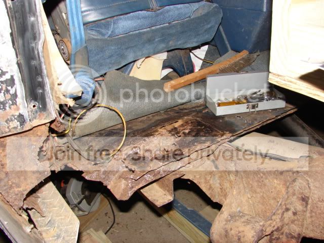

The previous owner had tarred in 2 small repair panels on the edges of the cab's floor. They were solid but I wanted to know what was under them so I chiseled them off then spent too much time cleaning up tar residue. I didn't have the right size piece in my diamond plate collection so I had to dig my fenders out of the snow bank to get the diamond plate panels I made for them. They will fit perfectly with a little trimming once the snow melts off of them.
I cut and drilled my diamond plate floor repair panels. Next I filed the edges of the cab to smooth them out after using the cutting wheel to shape them. Then I sanded the areas I will be priming as soon as it gets a little warmer outside.

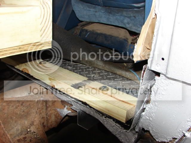

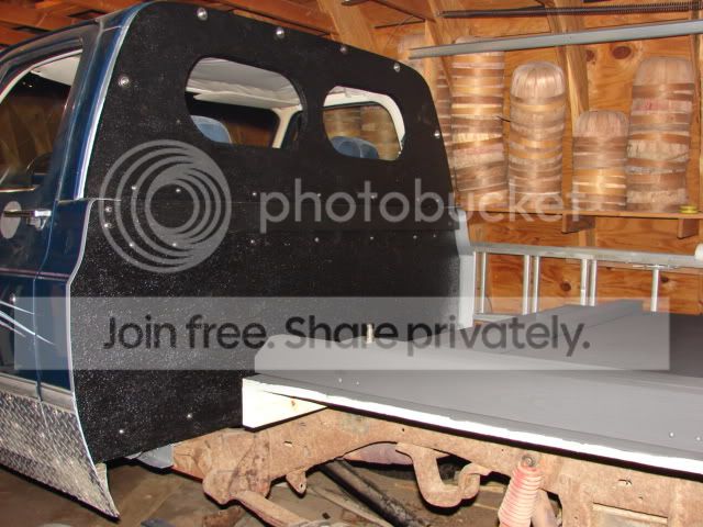

I spent a couple of days doing the boring, menial but essential preparation work like sanding, cleaning with Xylene and applying rust converter. Yesterday I applied 2 coats of primer to all the exposed edges and 2 coats of Herculiner to finish the bottom section. Today I installed the tie in brace and top section using the screw and glue technique with Marine Goop adhesive. After that I installed the floor panels using silicone to seal all the edges.
I installed the bottom section of the cab using the screw and glue technique. Then I stained the under side of the bed. The camera's flash made it appear lighter than it is. I would have liked to apply Herculiner to the bed but I have better things to buy for Jiminy with the $100 especially since the bed is temporary.
