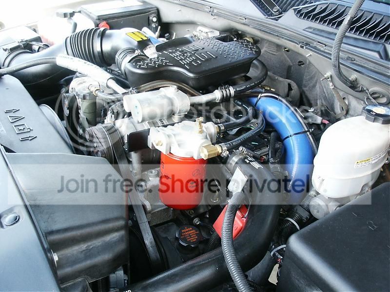

I've thought about that too, using a typical spin on filter mount...It would be the same as my trans mount and could interchange filters w/ the engine (BBC) as well.

Coolant filter installed, the brass fittings cost more than the filter and housing....
I wonder about placement of such a filter....seems like most solids would tend to find a low lying place. I think it would be hard to keep them in suspension to get them to a filter, especially if its in a heater hose?
Any comments?
All the ones I`ve seen on the Diesel Place are mounted up high like that...mostly for ease of placment in a Duramax im sure.
The guys say that it works great.
There's some pics posted of guys who cut their filters open and there's a good bit of s#!t in them. Thats what sold me plus all the sand that came out of my block. They say it kills water pumps.
Yeah seen those too! :doah:
This is a pic of a install that I like alot!:thumb:

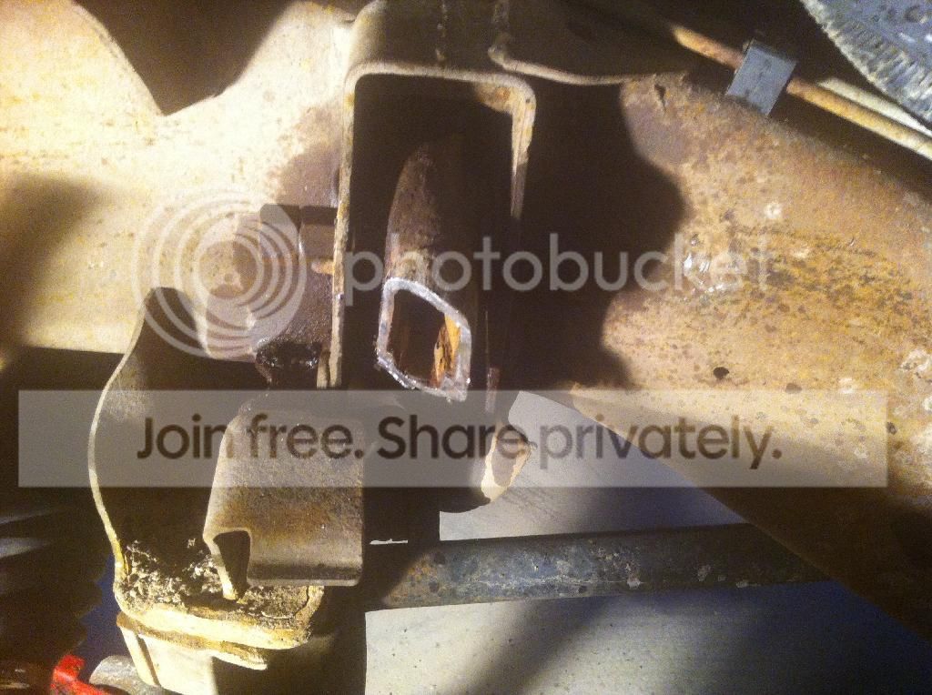

yesterday when I was changing the water pump I noticed the upper ball joint on the front drivers is toast, heard it pop Friday driving in the bank parking lot at - 30c. :doah:
So that will be my fun for today.:D

The ball joint will be cake to do after I finally go to the parts shed and dig out the spare upper control arm.

Changed my upper control arm yesterday... easy job turned into a big pain, one of the bolts snapped in half and was frozen into the bushing,had to break out the sawsall and angle grinder with a cutting blade to get it out! :doah:
Sure glad I bought that parts truck from you Russell,sure came in handy to have extra bolts. :thumb:
