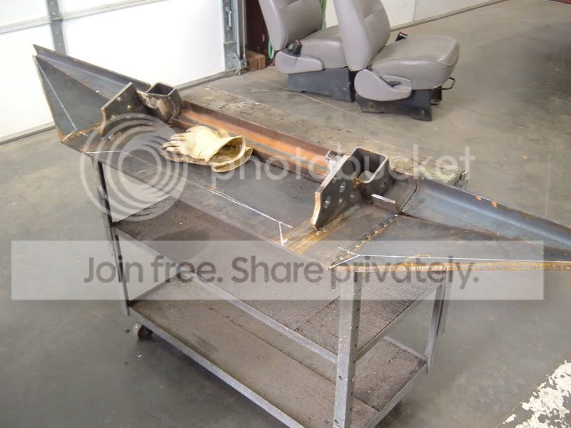

mrk5 off topic but been catching glimpses of those bumpers how bout a bild up or maybe some specs?
I made the them with 3/8" thick plate. I cut the angles with a hot knife (aka cutting torch) and used the grinder to smooth the cuts.

Here's a pic of the inside of the front bumper before I made the final torch cuts.

I don't have any good pics of the rear bumper. It's basically the same as the front without the vertical area.
Both are 3/8" plate.
