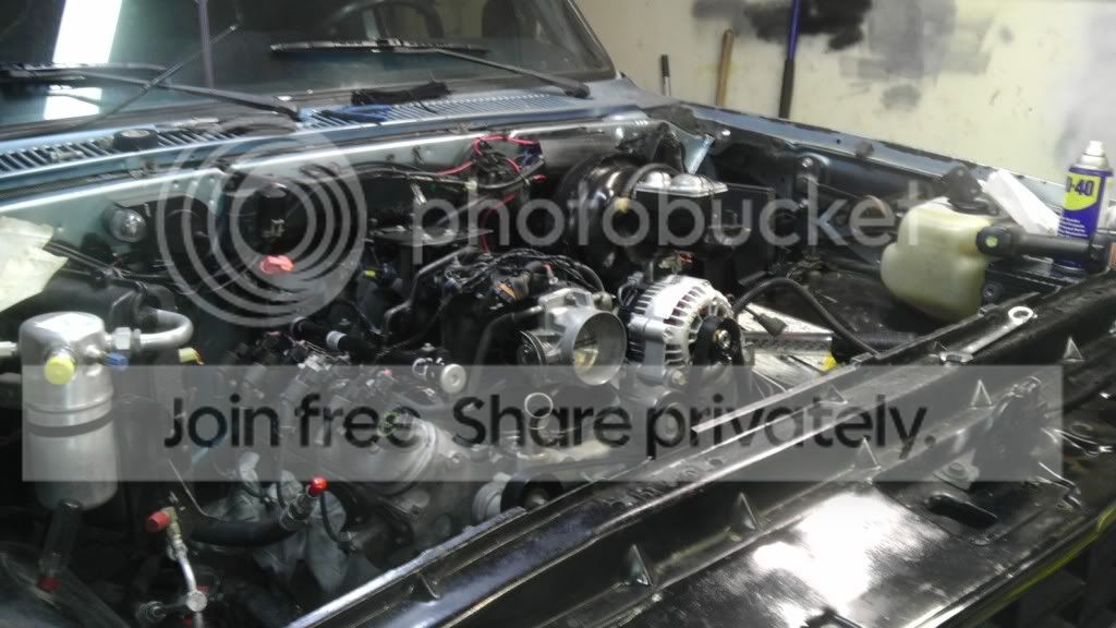

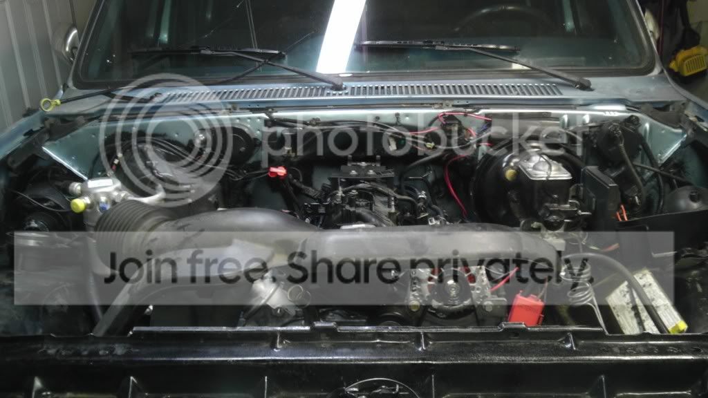

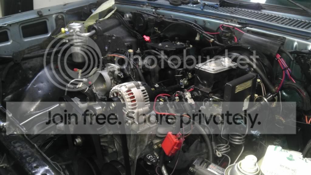

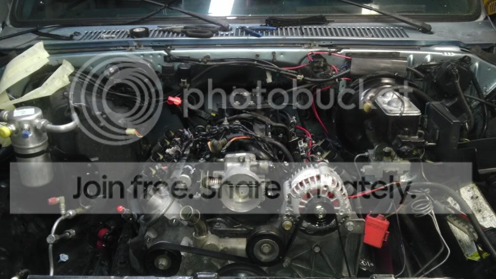

Got a little closer today! Got the top end pretty close to wrapped up. Intake is back on with the new intake gaskets. Routed much of the wiring. Loomed the wiring that is hidden by the intake before i put the intake on. bolted on the power steering pump and alternator. And put on the new belt and tensioner pully.
EDIT: The wires crossing over the intake near the front are just laying there. They are for the maf, tps,iac,and temp. Just didnt hook them up. So fear not, the wiring is not done so it looks worse then it will be.
meh, that's what those fancy covers are for. :P

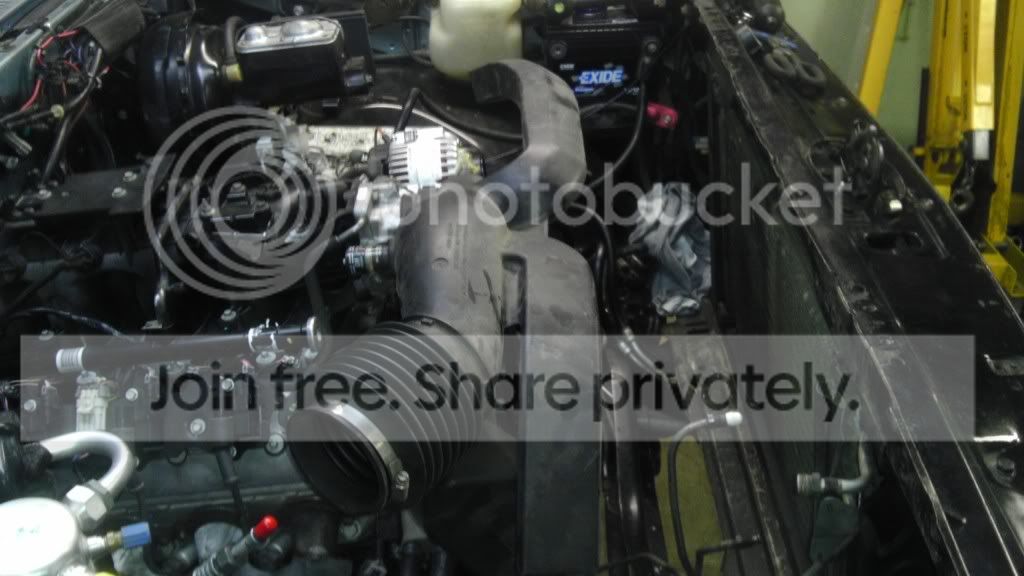

FYI, dont bother trying the H2 intake ducting. It aint happening and it looks like poo poo.
EDIT: By the way, the 3 piece engine covers are going to take ALOT of modification to work. I think im just going to run a center one for now. I would realy like one like Teck has but i dont know if it will fit my older gen III intake.

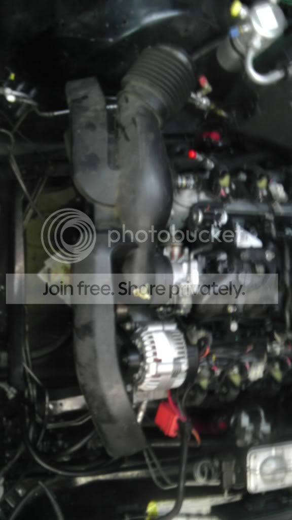

EDIT: this is how it looks in an h2. Obviously not going to work out... Thinking a silverado one should work.
