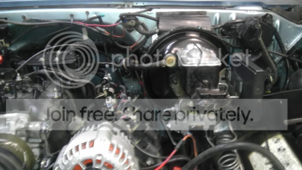

Nope! Pretty sure my hopes of driving it up and down the street this weekend arent quite going to work out... But im thinking maybe i will here it run with the exhaust on it and be able to let it run for a while sense i should have everything hooked up and in working order. The only thing im lacking at this point is the dad gum throttle cable!

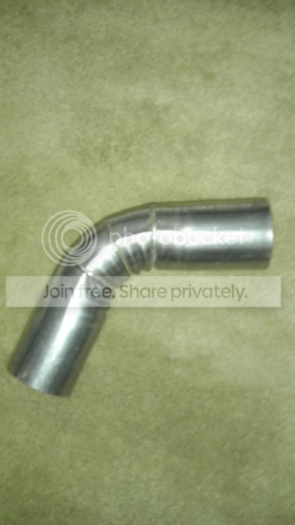

Fairly pointless pic of the 45 pie cut out to about a 60.

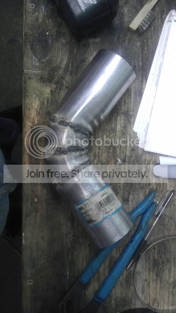

Got my modified exhaust piece all welded up last night. Now today I'm going to try and get the.exhaust the rest of the way done. Get the cooling system all wrapped up tomorrow, and i should be ready for a Wednesday test drive.

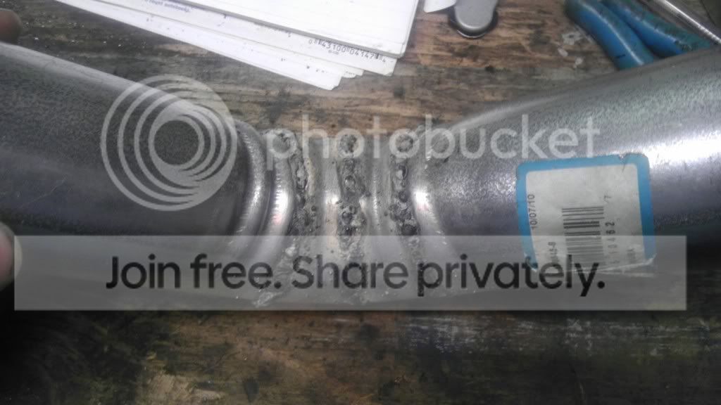

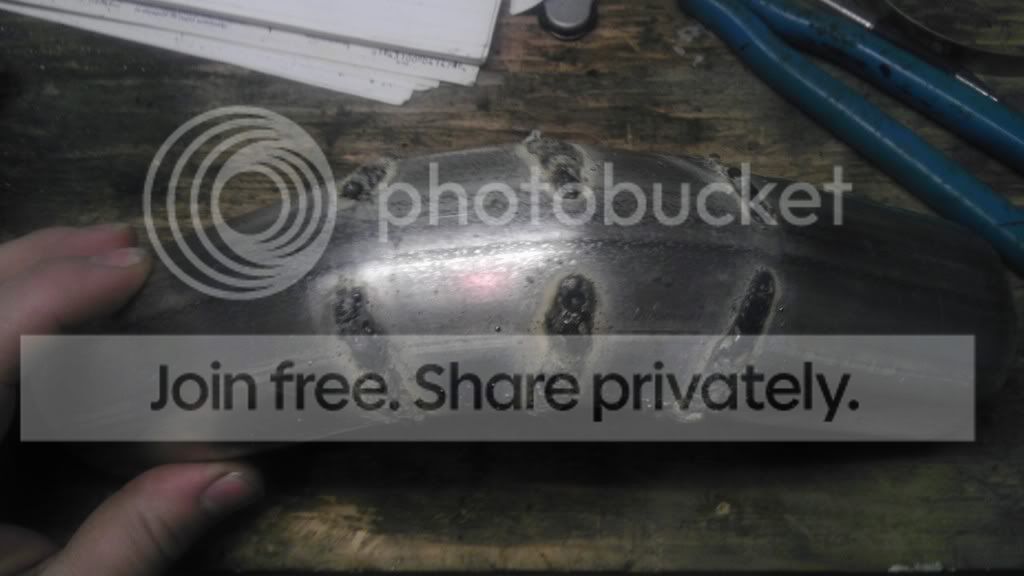

So heres the few pics of stuff. First my fantastic weld job... Keep in mind that this is with a harbor freight 110 welder, a whip that wont work at all angles, and flux core wire.

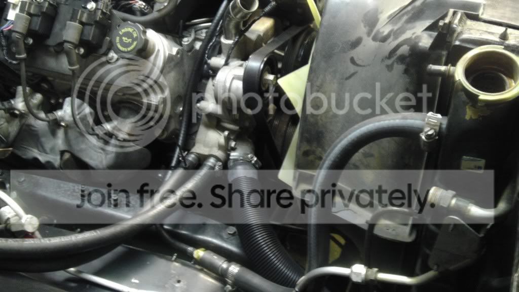

A shot with the shroud set in place.

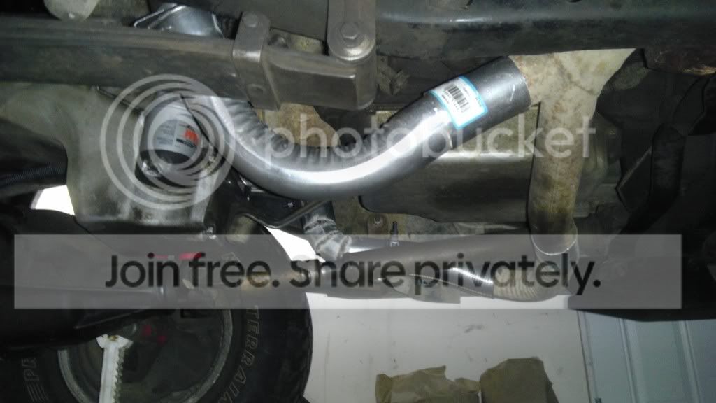

And my ghetto fab exhaust so far.

And your xhaust work is looking good :thumb:

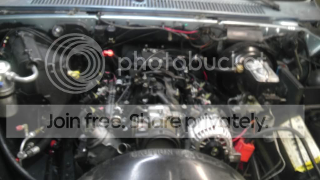

Well i think instead of finishing i'll just go ahead anf push it off a cliff. Got it pretty much ready to hit the road this morning and fire it up. Whats it doing? Thats right! Idling like crap and running pig rich! :doah: Anyway, im getting the following codes, p0480, p0803, p1635, p1639. So i dont know what the difference between now and the last time i started it in the videos but something done went hay wire! Sense the last viseos, i have removed the intake, added the new knock sensors, bolted the intake back on using new gaskets, hooked the exhaust the rest of the way up, bolted up the torque converter and hooked up the cooling system.
