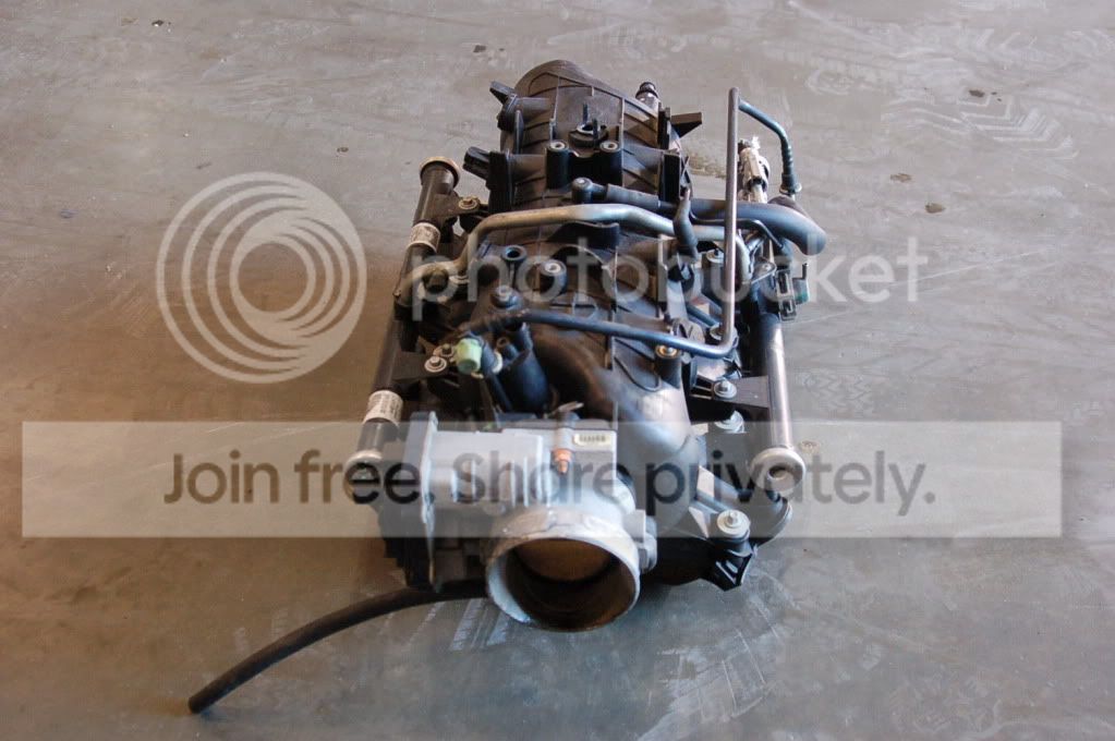

Option 1 is to run the tv cable into the cab and connect it to the pedal. Option two is to swap to the cable style throttle body. It's super easy. Unbolt the electronic tb and bolt on the cable one. Only thing is you need a harness and computer for a cable style.
I was told you have to change the intake also. One style is 3 bolt the other is 4 bolt. Itink the computer and harness can be made to work. These are the reasons I want ahead and just got a 4l65E. And on another note about that a 4l60E will not work with a Gen IV computer, they don't have one of the sensor in them so they don't shift correctly.

Oh and the computer on the drive by wire stuff does not have the iac driver installed on it which is the problem. There are a few random dbw computers that do still have the driver but I think they are all express vans. That lt1swap web site has some really good info on that. Seems like maybe chevythunder.com did too.

Here is one off of a 04. has the three bolt pattern just like mine.
On a side note, this is what i love about these engines. You can get an intake with throttle body and injectors for $120 or less!
