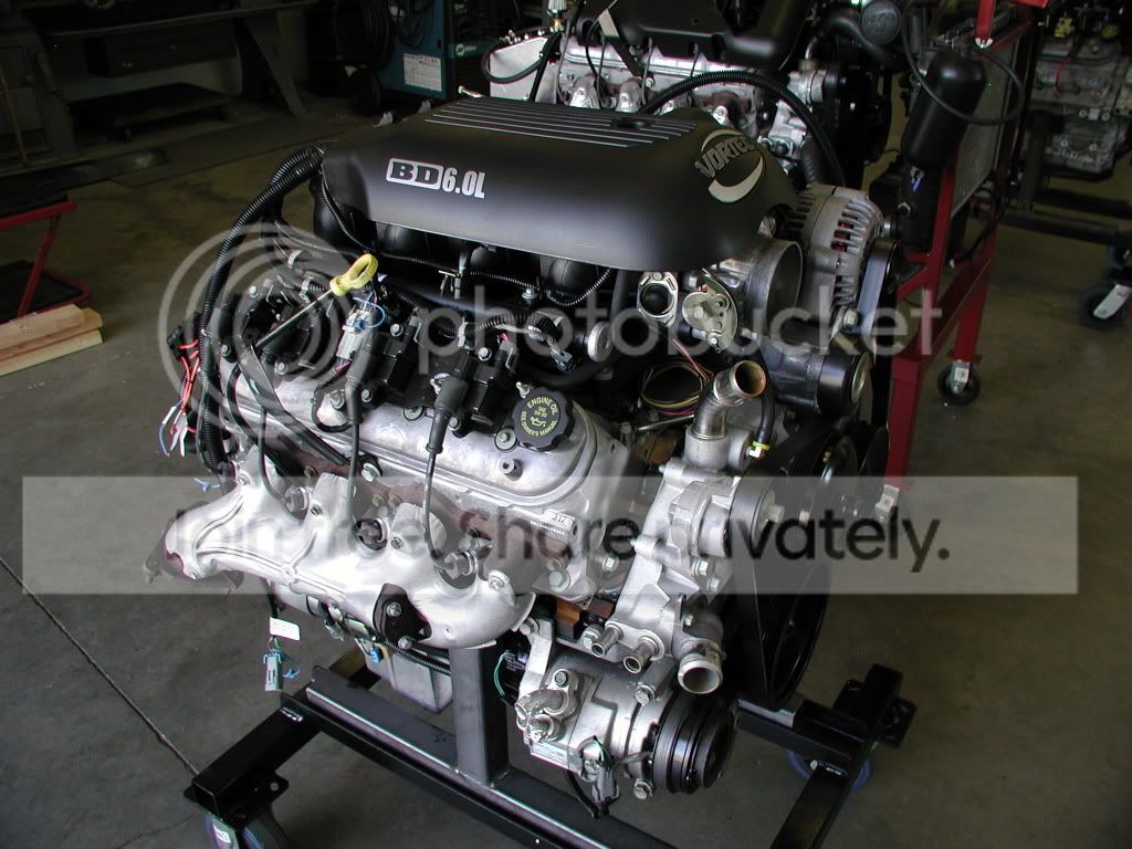

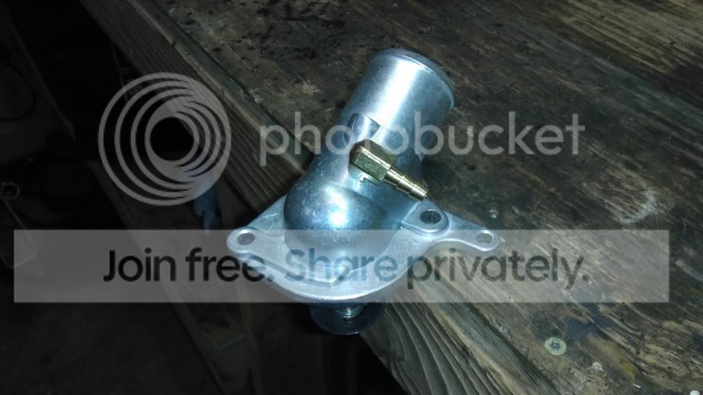

I would say this is how most folks are doing it. Really i just dont like the coolant line running all the way over there for whatever reason. I just think this appeals to me more somehow. Slightly cleaner look in my eyes. Others may think another way is better but i just think this is the way for me. That BD Turnkey engine guy on pirate does all of his this way. As well as lots of other folks on ls1tech and so on. I just chose to do it on the t-stat housing for a few reasons. One, that i wouldnt risk fking up the water pump and having to buy a new one, two that i could have it completely free of chips and debris before i install it, and three that i could do it on the bench rather than in the truck. On a buddys jeep we T'ed into one of the heater hoses which worked pretty good.
BD's way,

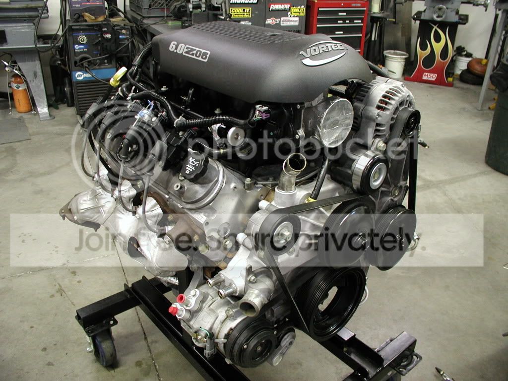

And the steam hose attaches on the front passenger side crossover tube on a Gen IV, also the water pump is cast different, they don't have that flat round spot on the front.

Things are going good so far this morning. Got the new thermostat drilled and tapped and put the new fitting in and got it installed. Lengthened my maf wires that for whatever reason were too short. And now I'm about half done mounting the air box! When that's done, the swap will be "complete"! Here's a pic so far.
