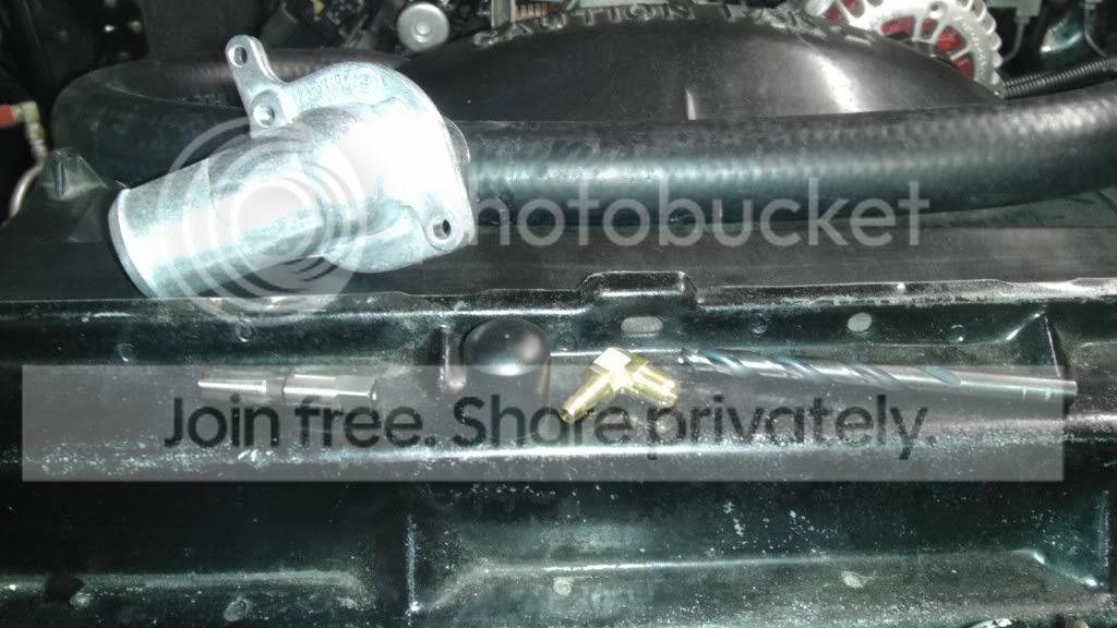

Also, i decided im just going to drill/tap the water pump for the dang little coolant line. I just dont like the way it has to run other ways. And actually i might just do the t-stat housing so incase i f up, its not too big of deal.

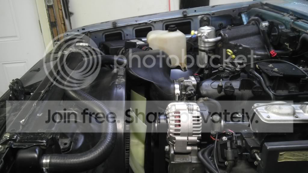

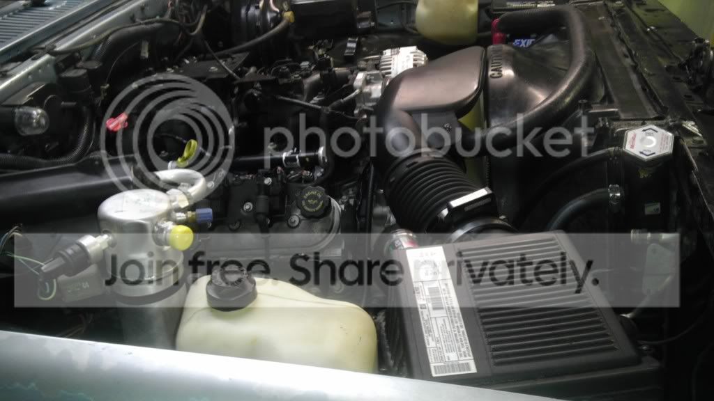

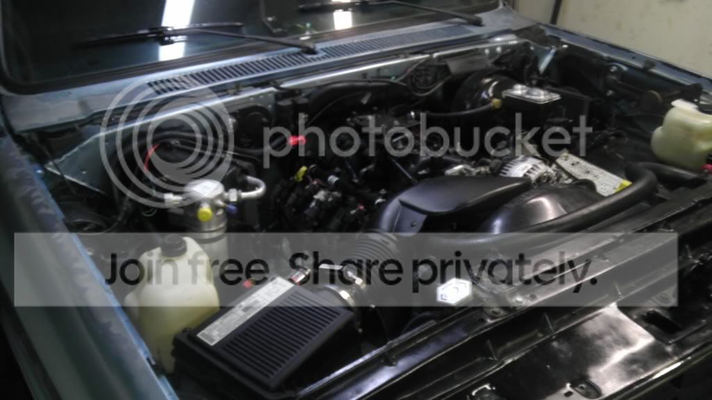

Started playing with the intake tube/ air box setup. This is approximately how it will end up. Just gotta pic up my metal and start fabbin!
Did some running around this morning and picked up my new thermostat, 1/8th pipe tap, "R" drill bit, brass fitting, cap for the outlet on the radiator, as well as the metal to fab the air box mount. So, as soon as all of this is done I will be officially "done" with the swap! With the exception of getting my exhaust done at a muffler shop.
