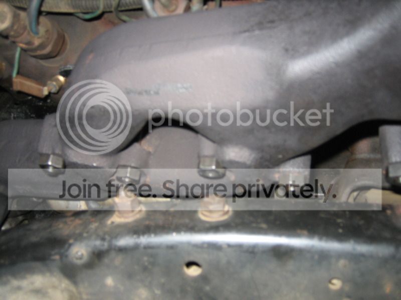

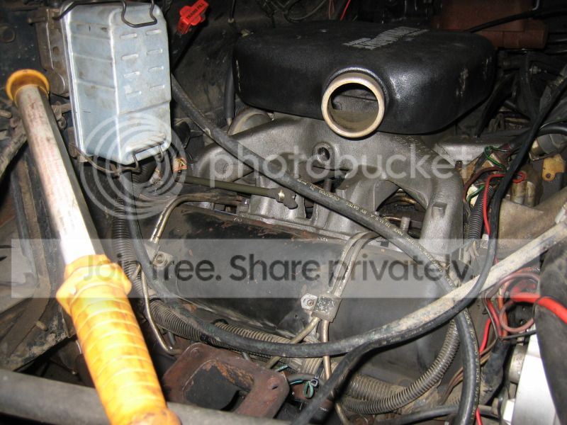

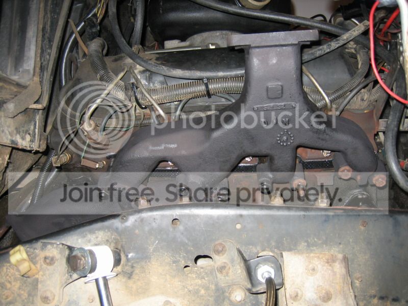

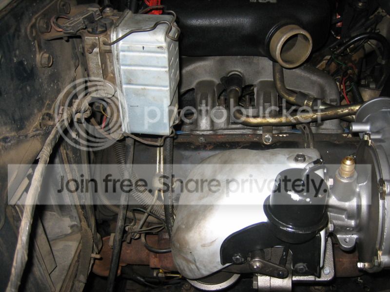

Well started with the turbo... Got the oem manifold out w/o much trouble. Gotta find an S10 air conditioning housing to cut and replace the fullsize one so the turbo will fit.
I took a few pics, but gotta get them off the cell phone at some point.
Progress :)

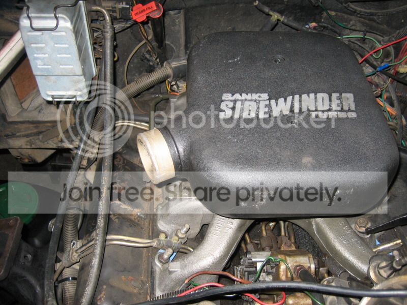

Factory exhaust is out, evap housing on the floor.

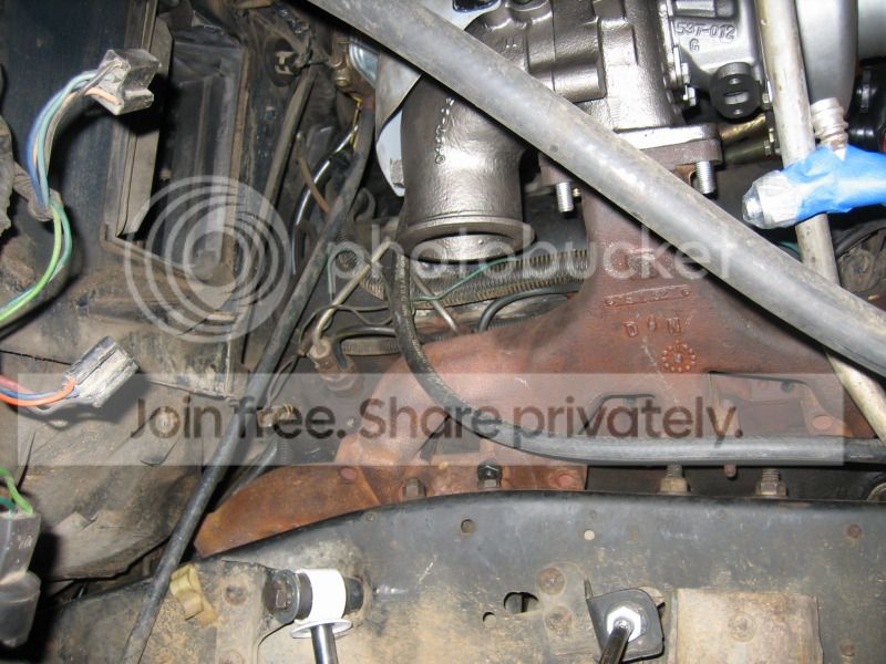

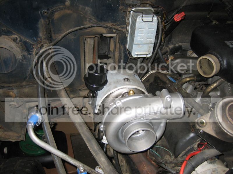

Turbo manifold on w/2 bolts for mockup. For grins, I put the turbo on to see what it looked like...pretty awesome :)
Hopefully over the next month(s) more will get accomplished, the turbo completed and a doubler to go with it!

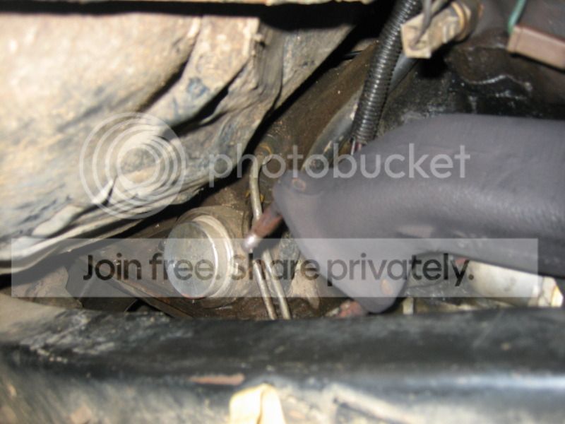

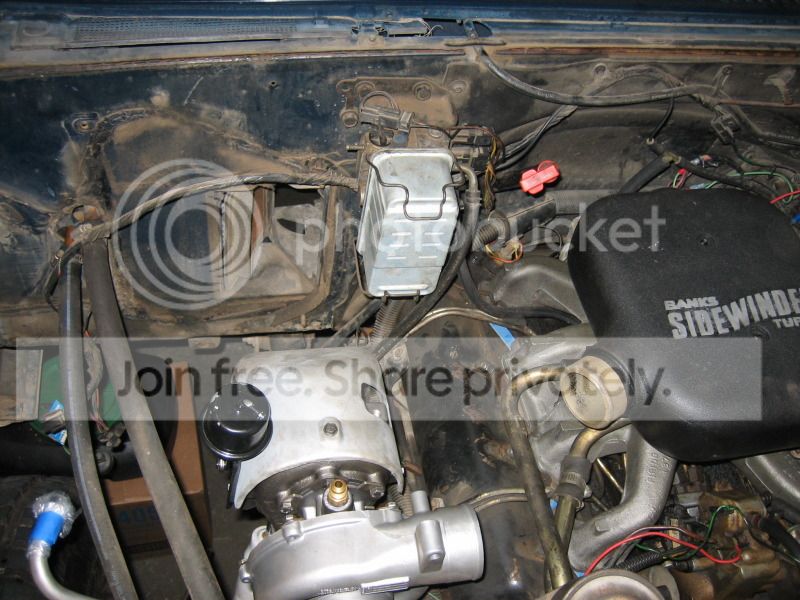

Got the oil setup in a good spot...for the supply I'm using the port just above the filter/ oil cooler lines. It's a 1/4 npt, got an elbow to connect up to my oil supply line that goes to the turbo. Using a 3/8 brake line that connects to the oem turbo feed line.
Need to order up some silicone elbows for the air, and think abut the crossover tube. I've got the factory one from a gmt400 which is close...so just need to do a bit of cutting/welding to get it just right.

Got the cdr ports on the intake tapped for 1/2 npt plugs, and the IP is turned up 1/4 of a turn. Looks like the crossover needs a bit of work, it's just slightly larger than the driver side manifold. But I still have the pipe I removed so ill just cut some sections from that to get things lined up.
Also got my silicone hose, and an air filter. Trip to Lowes and now ive got some plumbing pipe to build an air intake with. Hopefully just a few weeks remain on this project!
