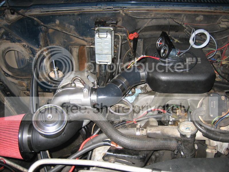

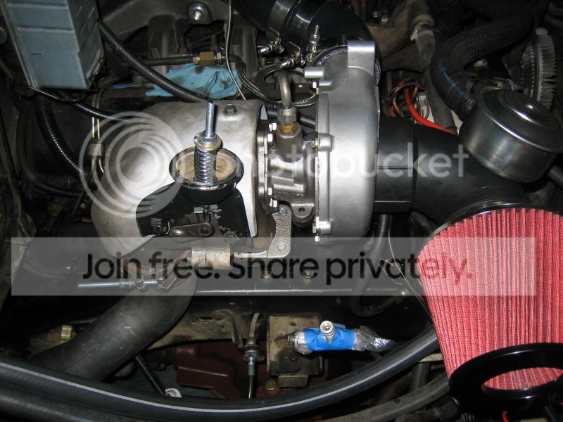

Install of the turbo itself is now complete...
Intake "fabbed" from some PVC pipe and an air filter I bought online for $15.

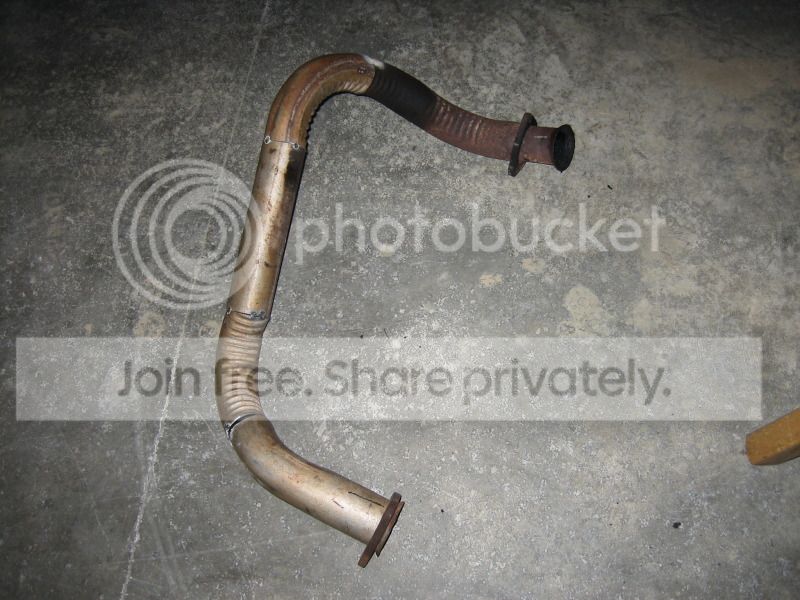

And the "good enough for now" crossover, 2-1/4" OEM xover from a GMT400, cut and tacked. BTW, the 6.5 and 6.2 have different size flanges, as I found...In the future I may endup bending a new xover from a single piece of tubing...but as I said, for now this will work
Looks good!
You probably know this, but get that air intake away from the engine bay. Ideally you want it poking through the front radiator support wall, getting cool, fresh air. Cold air = more power, less detonation. Hot air + turbo can cause major longevity problems.

Turbo is good, I need to get it out on the road and up to speed. Still working on the down pipe, right now it's sticking outside the frame rail under the passenger side.
