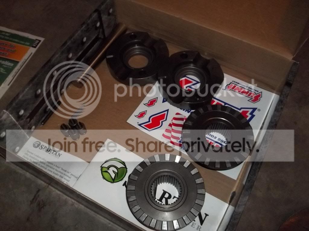

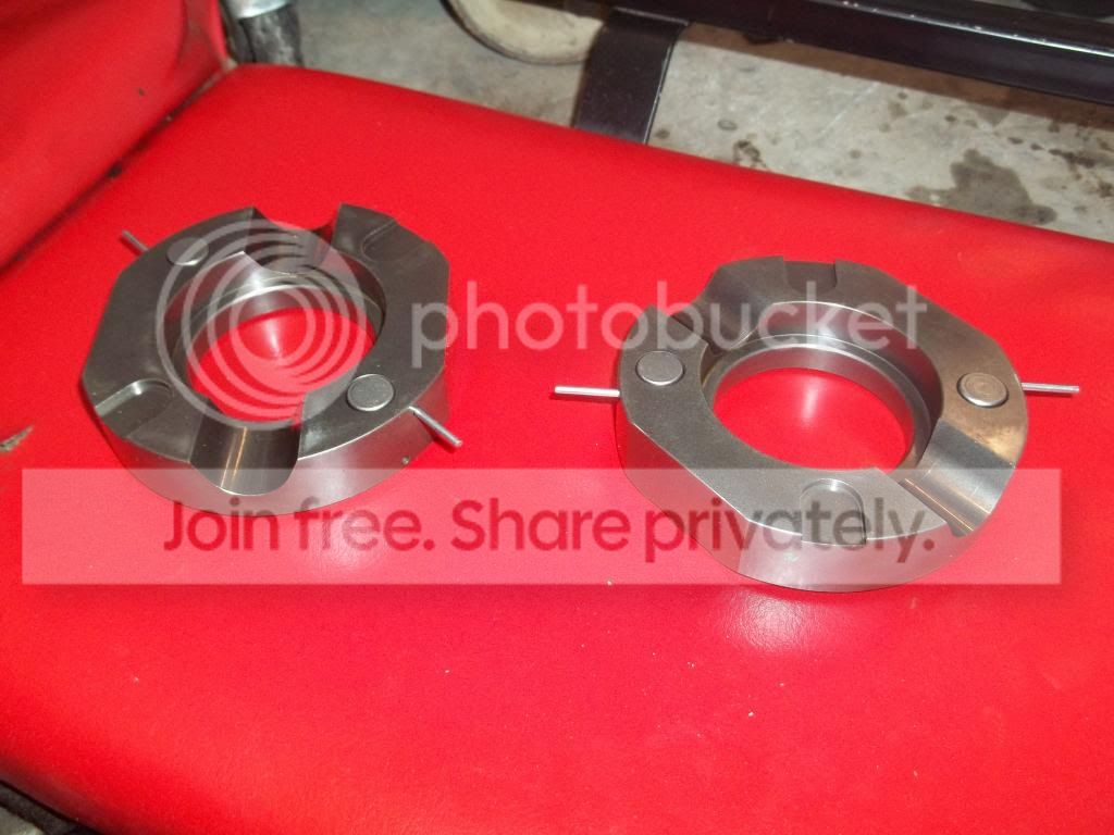

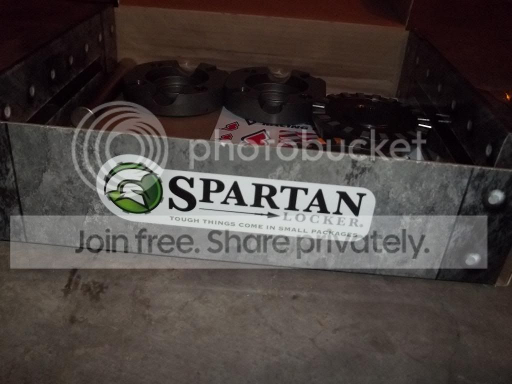

Spartan d60 front locker

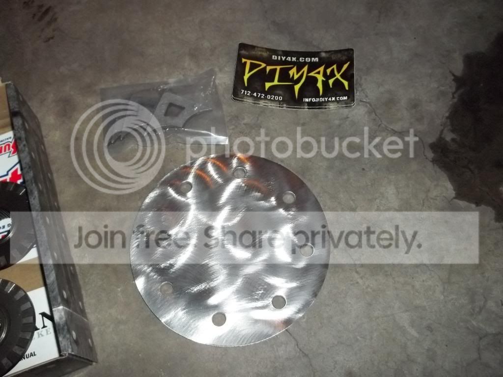

And a couple things from DIY4x
That is kert's spare tire mount plate and a few web gussets. I have an idea of where I am going to mount my spare, nothing fancy, just simple and functional. That will probably happen once I get it running and back over to my house, hopefully in a few weeks.
Nice! You should be able to put that locker in without pulling the carrier. I have a lock right and those are similar to the spartian and I didn't pull the carrier to install it.
Yeah, that was my plan. Thats what is so nice with these lunchbox lockers, install is usually pretty quick and easy

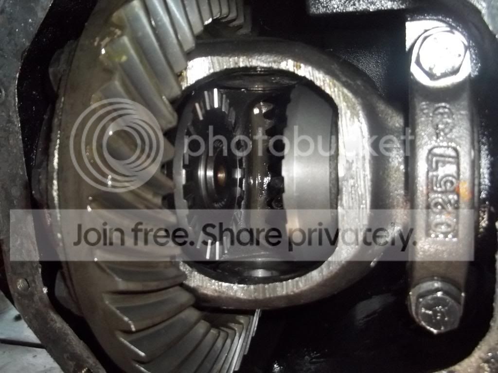

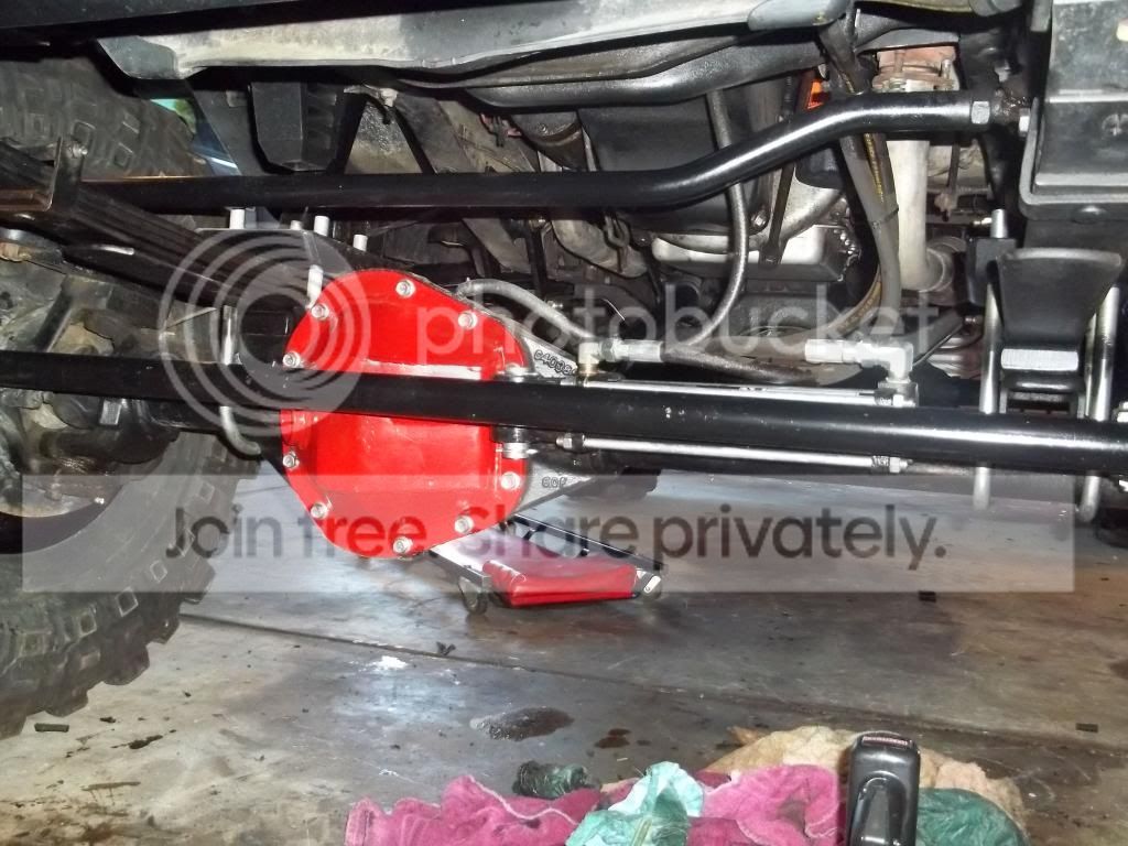

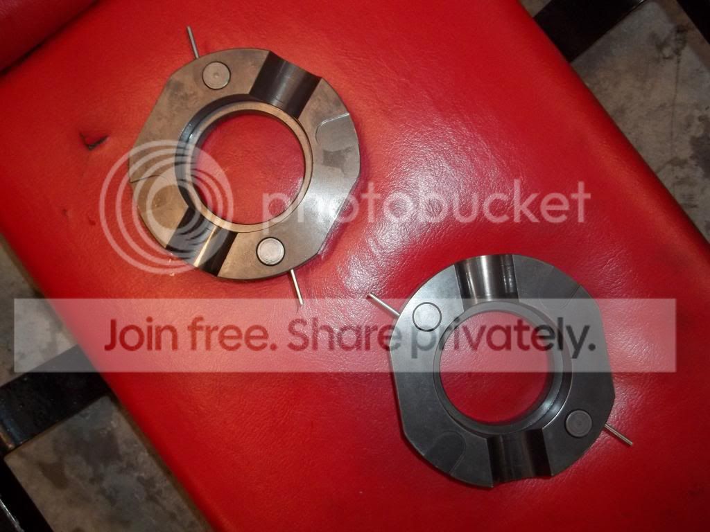

It was a little bit warmer today, so found some time to work on the rig. Didn't get anymore wiring done, but did get the spartan installed

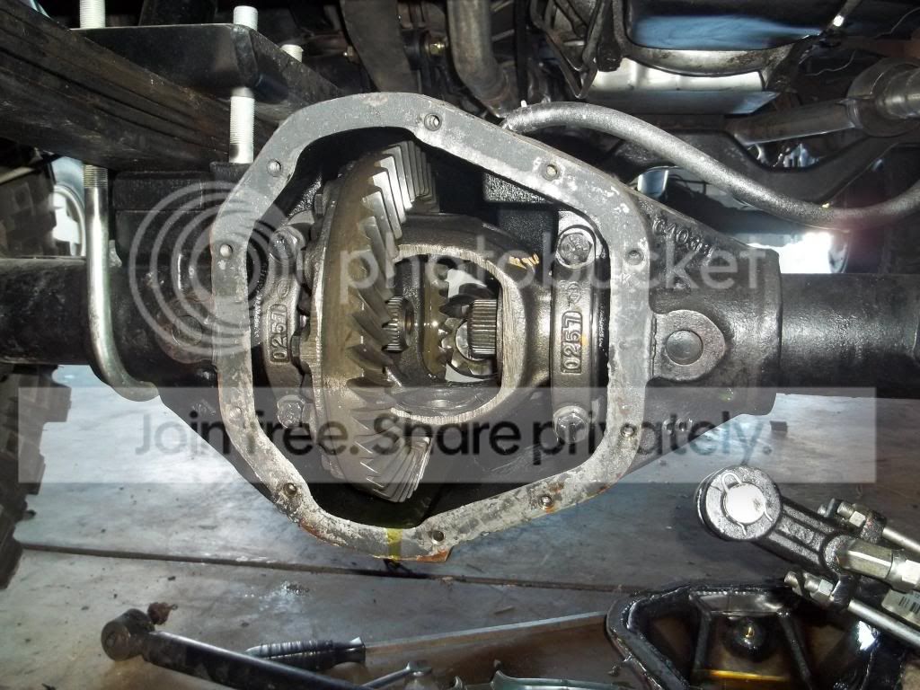

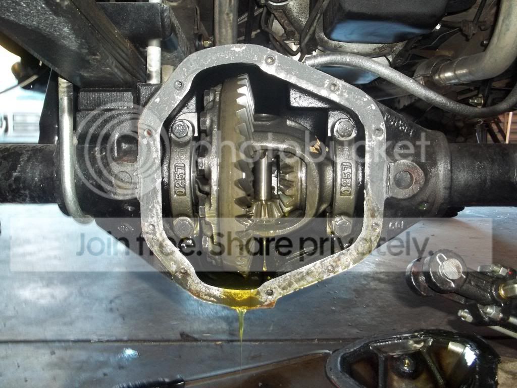

Drained fluid

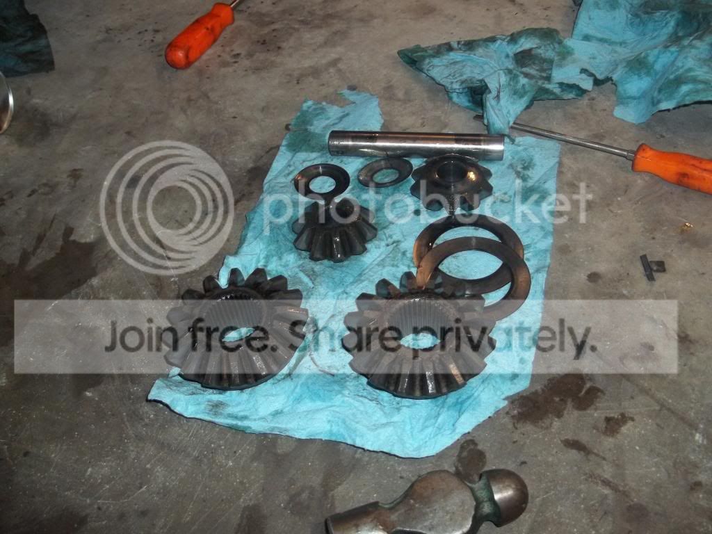

Removed the roll pin (that was the hardest part of this whole install, other than the freaking removal and install of the roll pin, everything else was about 20 min). And remove the cross pin, the pull out all the spider gears and thrush washers
Spider gears removed

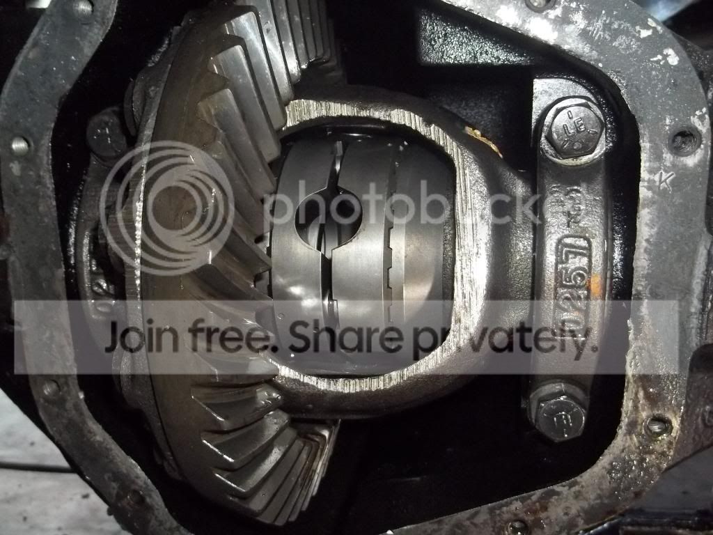

Then installed the springs/sleeves into the center drive plates (not sure if that is what they are called, but you get the point), and use the little pins to hold them in place while you install
Install the side gears, these just slid right in
Then install the center drive plates and align the teeth so everything matches up
Then install the new cross pin and roll pin (both supplied in the kit)

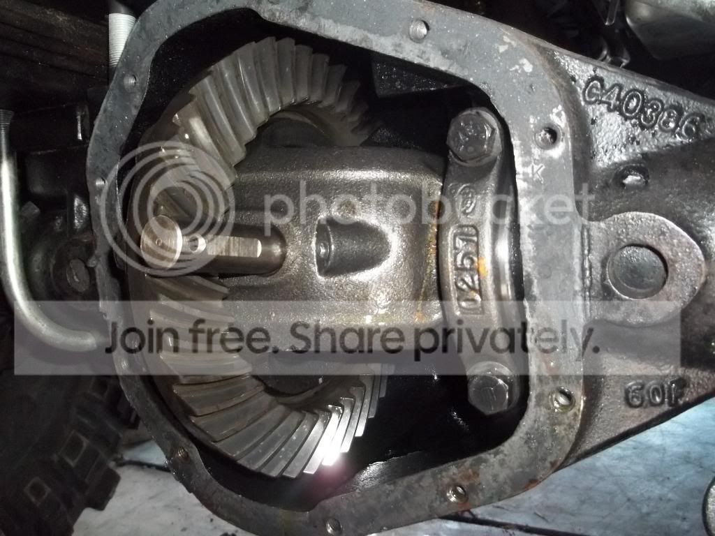

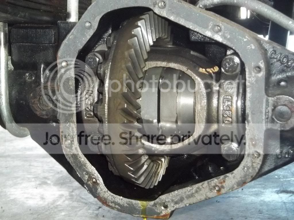

And all finished up :pimp:
All put back together with lube in there
Like I said, this was so freaking easy to install, it's not even funny. The only hard part was getting the roll pin in and out, but with the right size punch, it's pretty easy. And I have read a lot of threads of guys saying that you can't do this install with the carrier in the housing.....so this is proof that you can. I have 4.56 gears and the cross pin had just enough clearance of the ring gear. All in all, pretty freaking happy with this product!

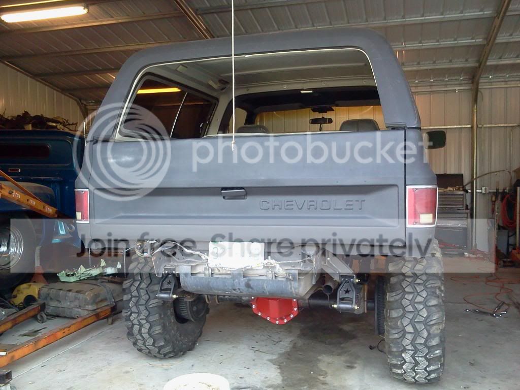

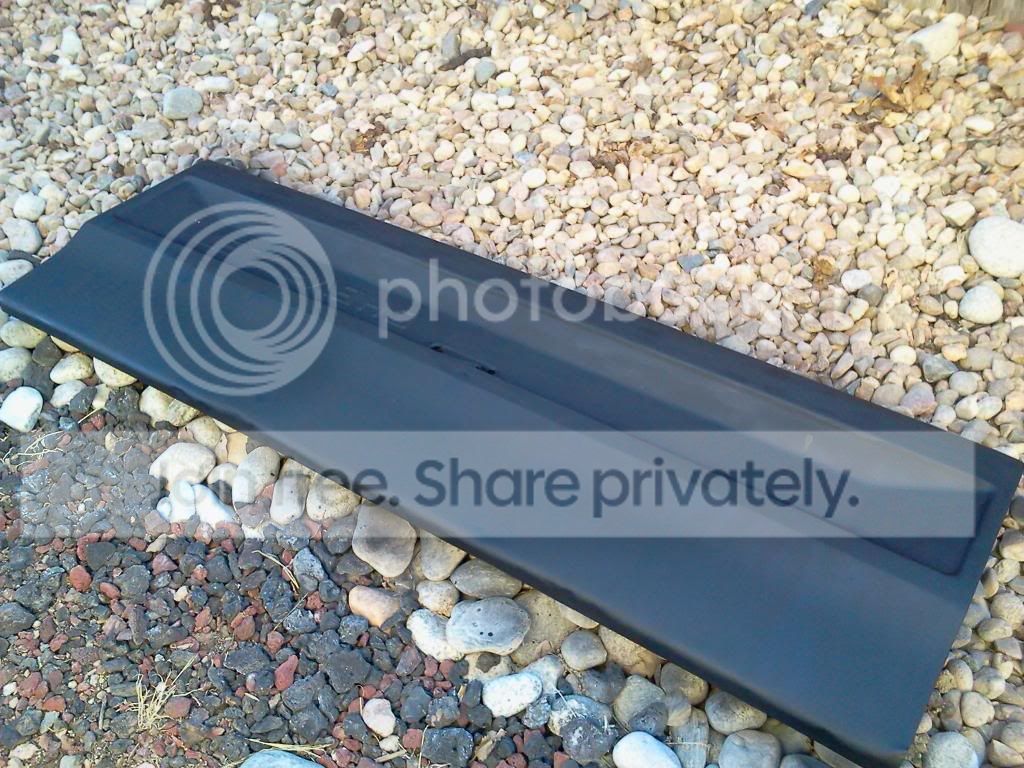

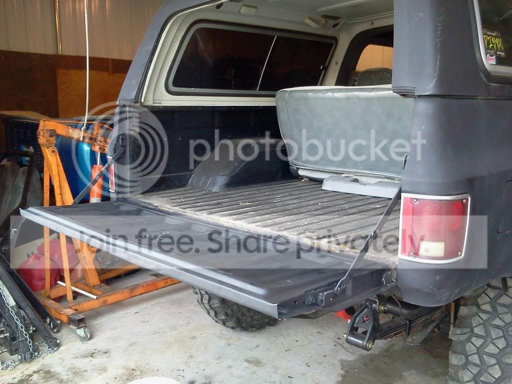

My back window on my k5 tailgate never really has worked (crappy electric window) and the gate wouldn't open unless I had the cover off and pulled the two rods together (tailgate handle was completely jacked). So decided to say screw it and just swap to a truck tailgate. My dad has an old plow truck that he said I could have the gate if I wanted it. Since my next move is to accumulate some tube for a cage, the top will probably come off for good after that. So since this would be a free project, other than $10 or so for some spray paint, decided to do it.
Tailgate painted
Installed. I'm not going to get into how to swap these, cause it's been done before (there is a link from nimak5 to a thread of how to do it a couple pages back)

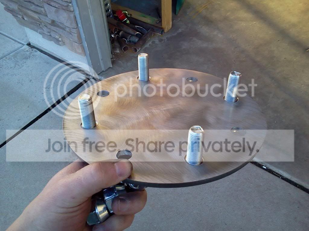

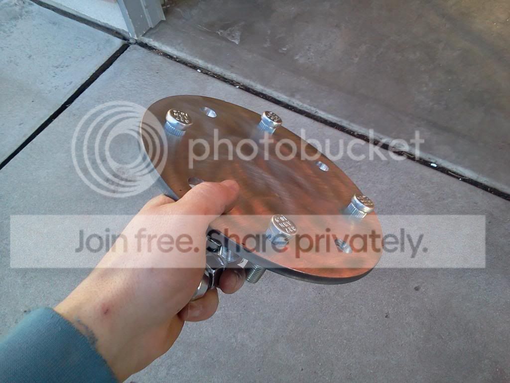

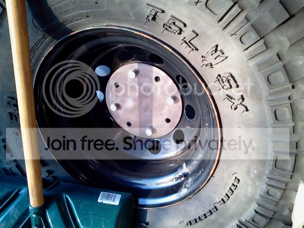

Also got a little start to my spare tire mount. Purchased some half ton wheel studs and lug nuts from the parts store and mounted them in my spare tire plate
Perfect fit. More on this spare tire mount to come

Those tail gate "straps" will drive you nuts rattling around. I was thinking about wrapping mine with tape or something.
