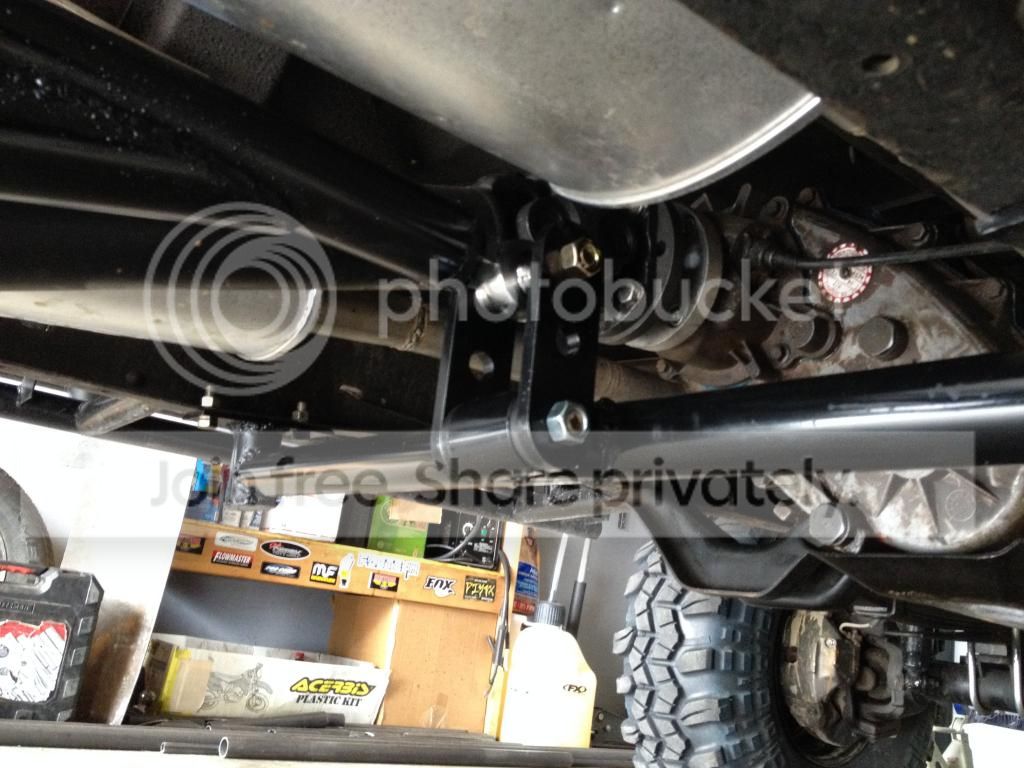

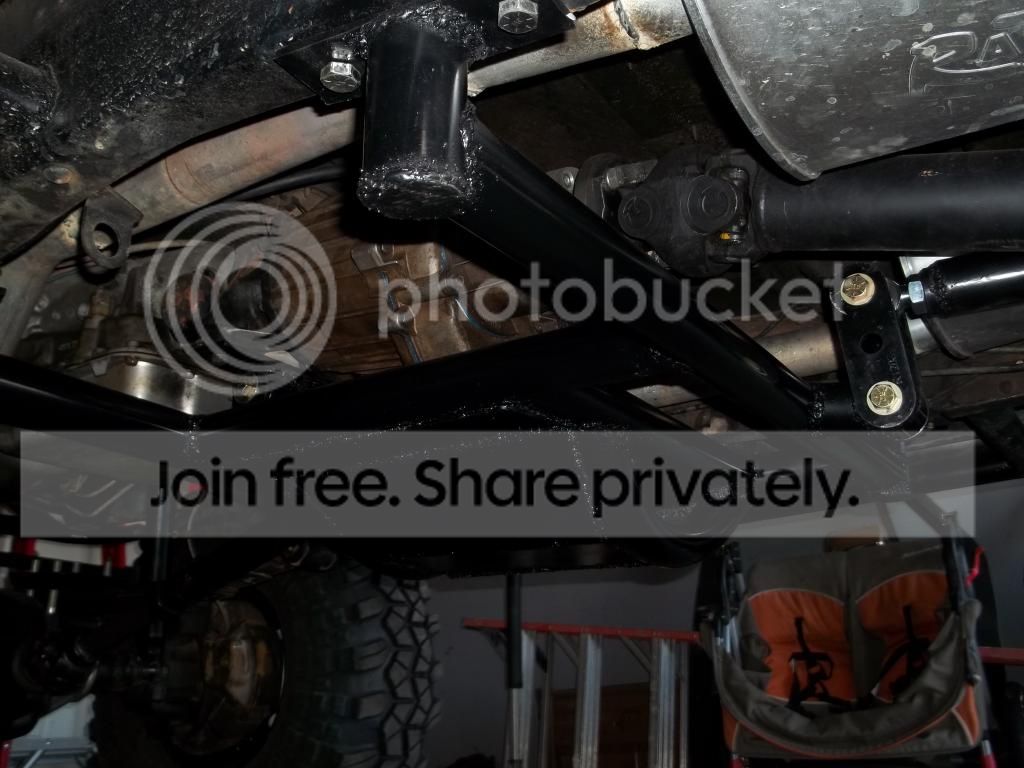

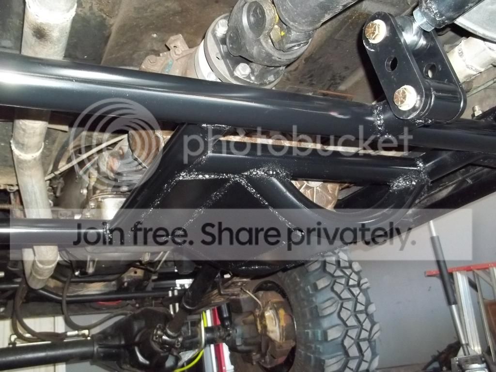

Decided it was about time to build a wrap bar. With the 56's in the rear I was getting enough axle wrap to make my rear hop on uphill climbs. So since I had some tubing left over from my cage build, decided now was as good of time as ever. So picked up some parts from RuffStuff
Built a simple little cross-member to mount the shackle off of. The next set will be to rebuilt my tranny cross-member and I will tie that into this cross-member and then build a skid plate to protect my NP241

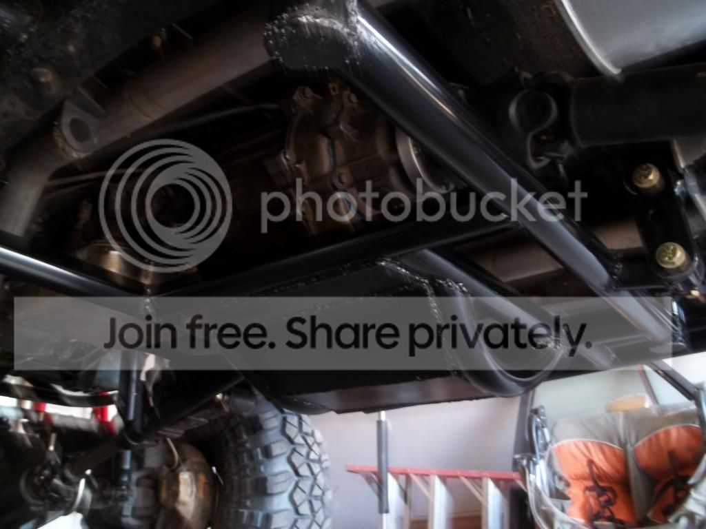

And the tubing, and also finish welded and painted
Used a 7/8 heim at the top

I just noticed you still have overloads in the rear. Seeing how the truck flexes I was surprised to see those were in there.
PS- nice job on the anti-wrap

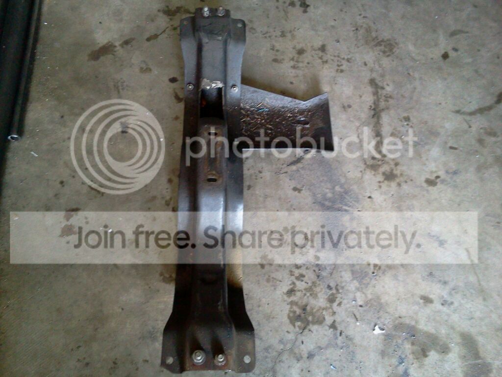

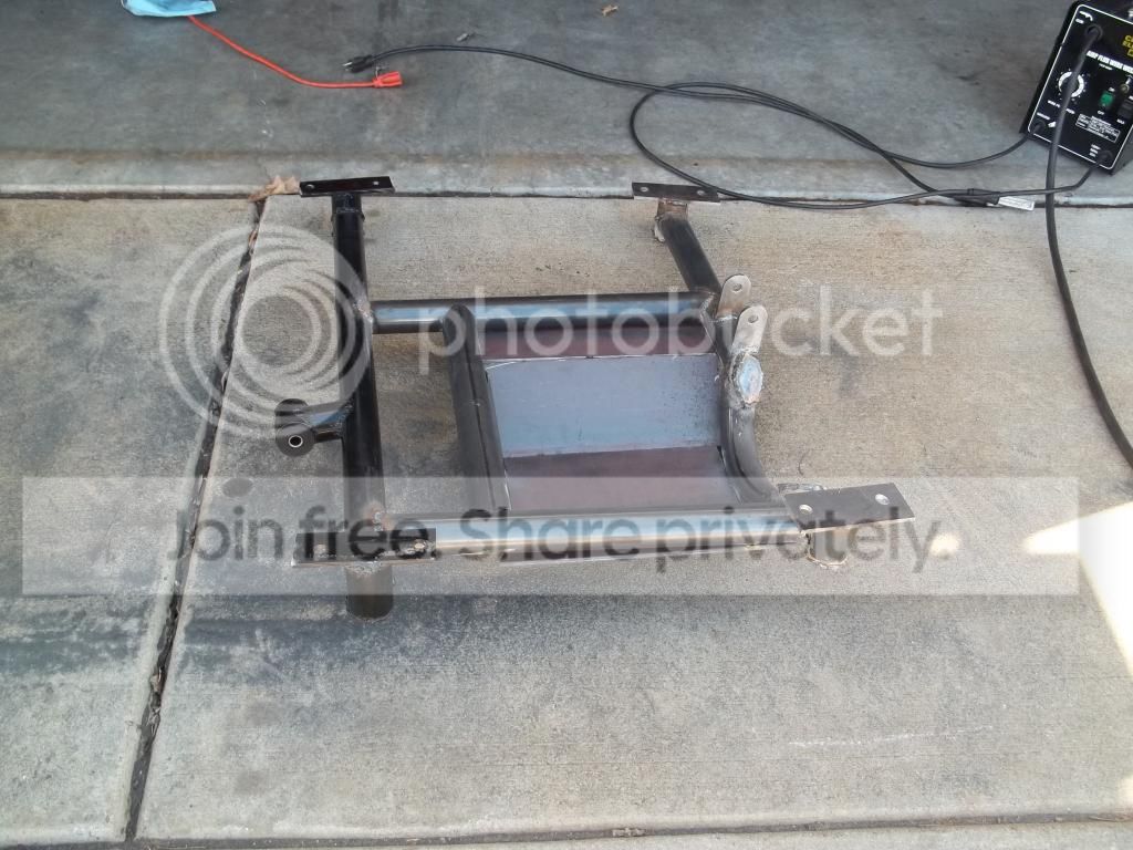

Stock cross-member with "skid plate" removed

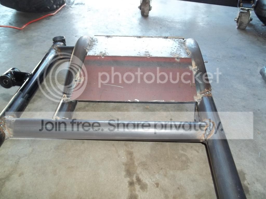

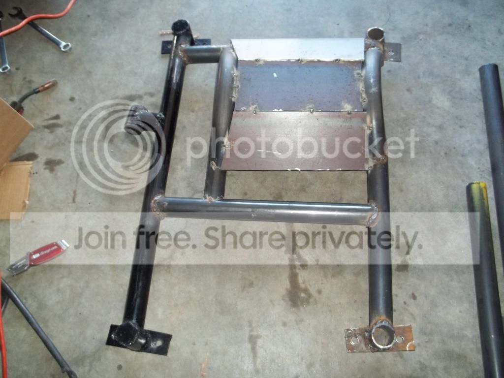

Start of the cross-member. Had to notch it and bend a tube so the front driveshaft would clear
2 brace bars back to the cross-member I built for the wrap bar

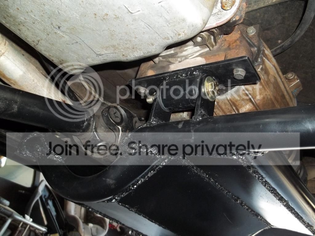

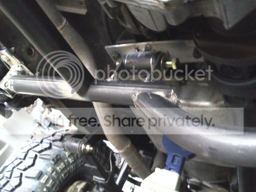

Used a fabricator set from DIY4x along with some tube tabs. Then just cut out a bracket to connect to the tcase adapter

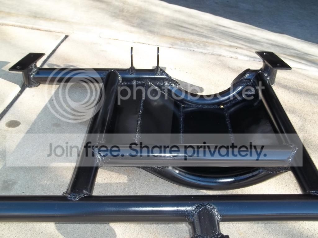

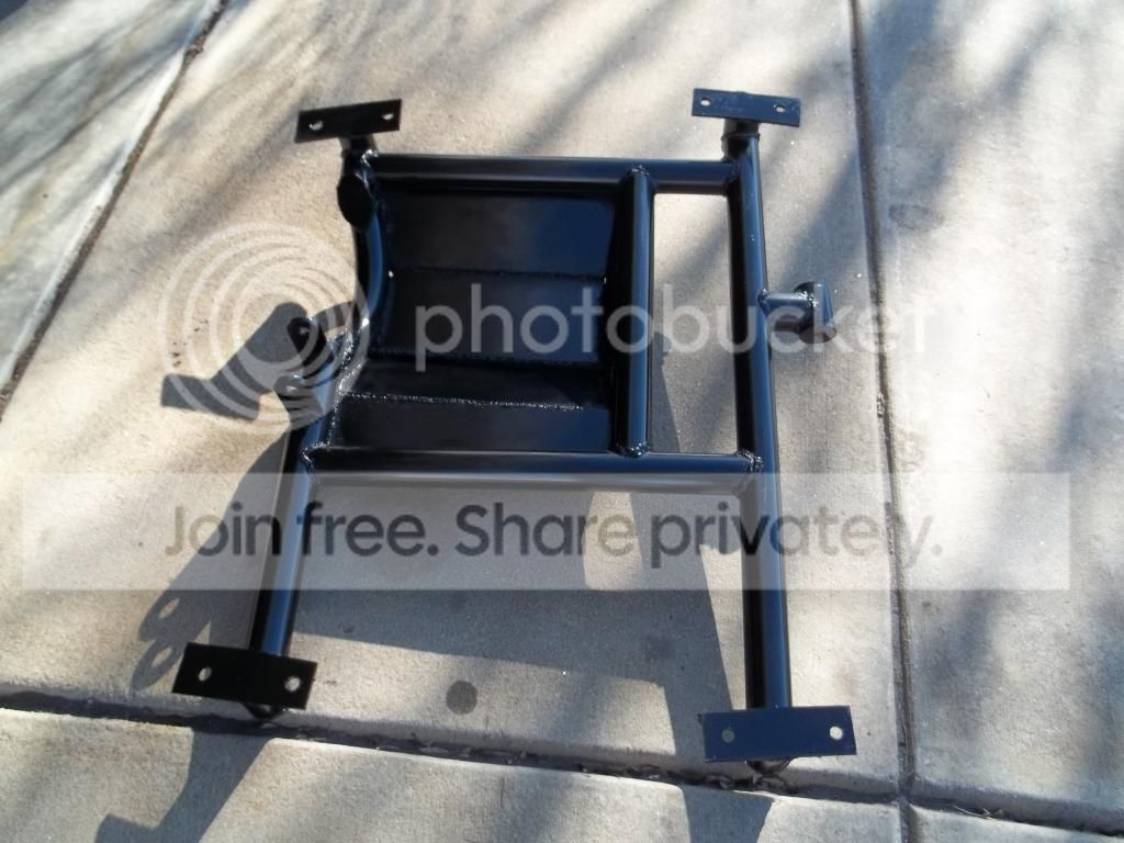

Then built a bucket to protect my 241 (biggest reason why I went to all this work so I didn't smash the aluminum tcase on a rock

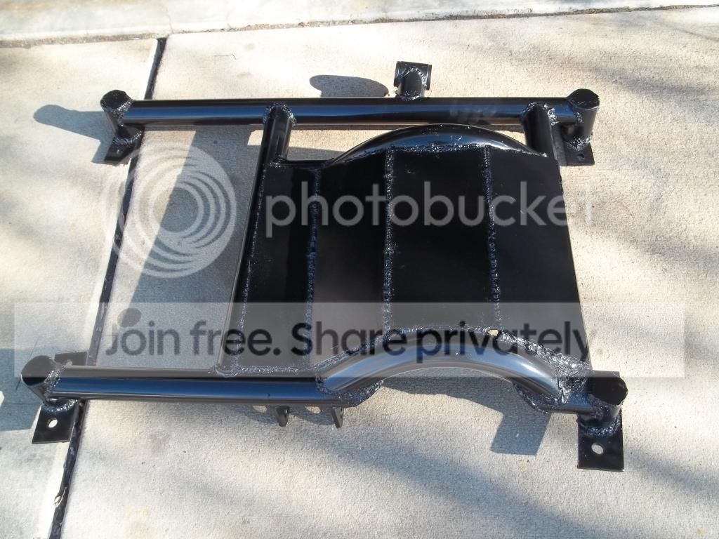

Capped on the open ends, finish welded it inside and out, and painted it
For those who are interested, I left a small "open" piece on each 4 corners of the bottom plate so it would drain water

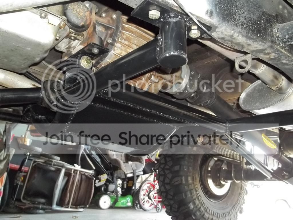

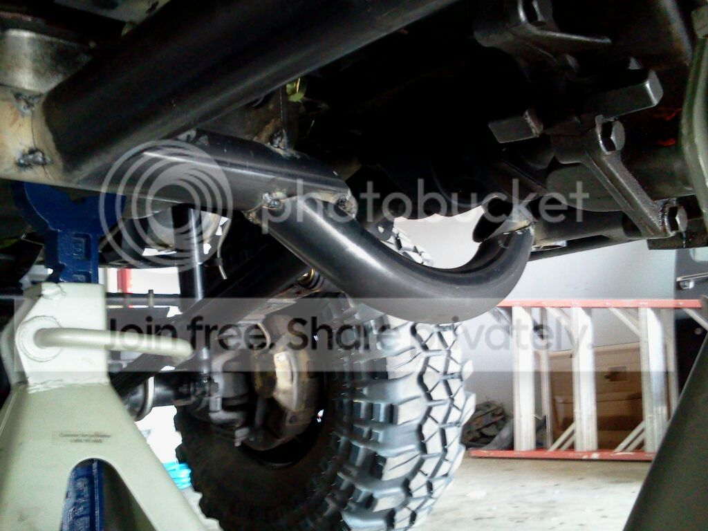

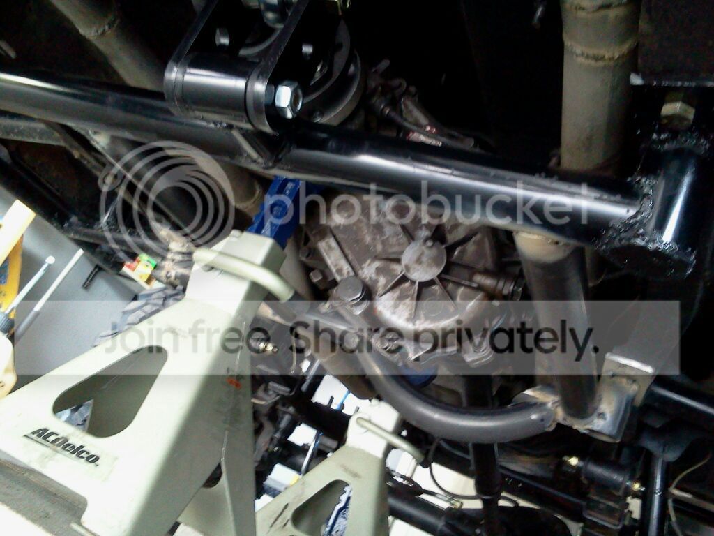

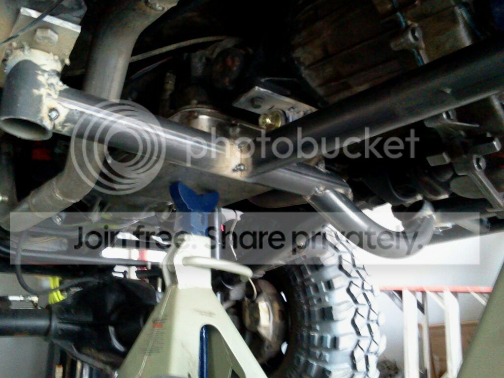

And installed on the truck. And before anyone says anything, my shackle for the wrap bar is straight up and down, the pic just makes it look weird
I know some people might think it hangs down too low, but it hangs down just about as much as the stock one did, and I only hit that one a couple times, so I am ok with it.
