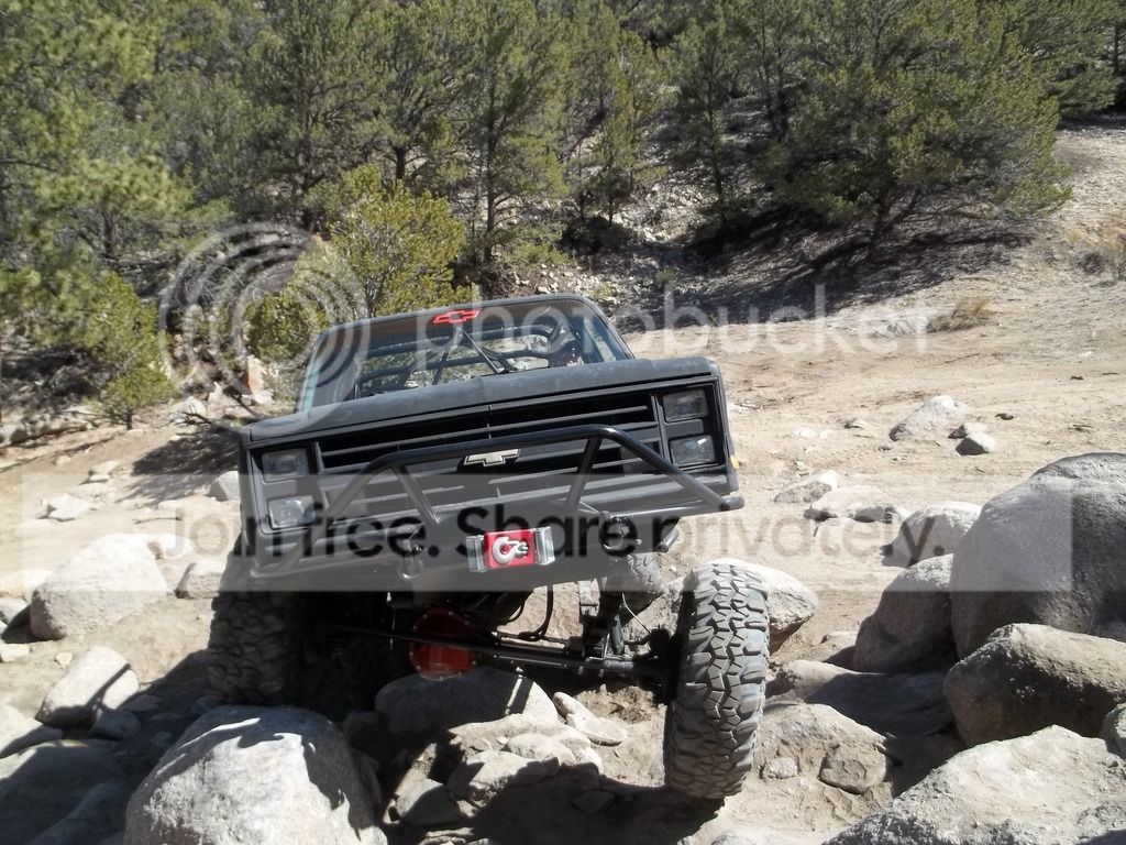

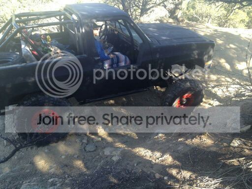

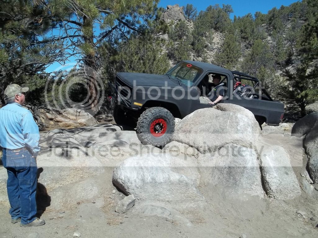

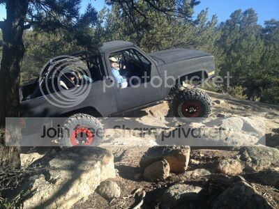

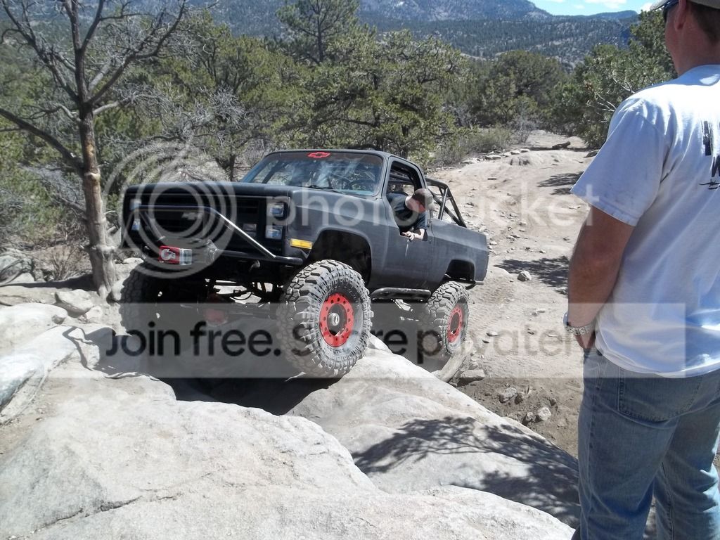

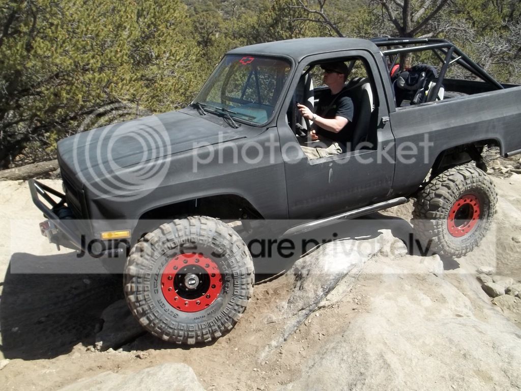

We didn't got to EJS, but decided to still go out wheeling as a family for Easter this year. Went to Chinaman Gulch trail in Buena Vista. Actually showed up yesterday, got a hotel, had fun in the small town, then went wheeling all day today. All in all, it was a fantastic weekend that was about as much fun as you can get. My rig ran awesome all day and crawled up anything I pointed it at...can't ask more than that!

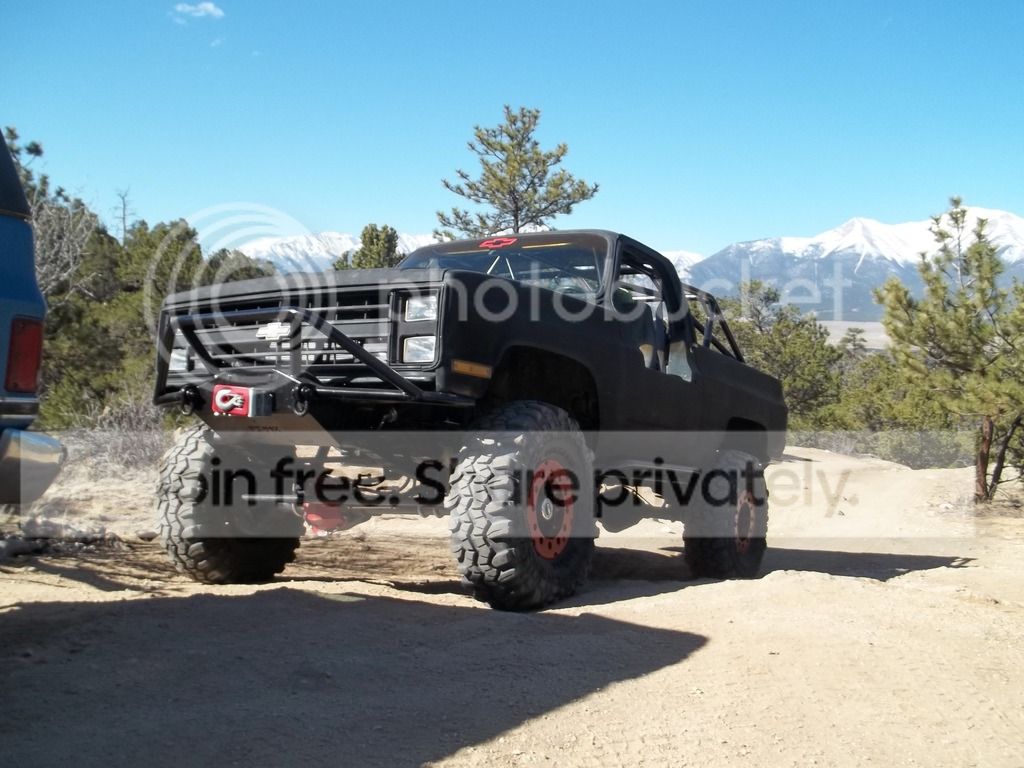

My rig (with some great scenery)

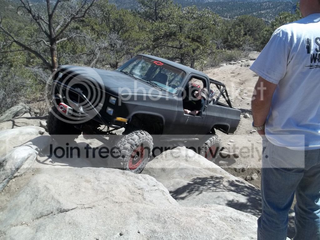

My brothers rig
My dad's 100% stock blazer
My two boys in the back....they loved riding in the back

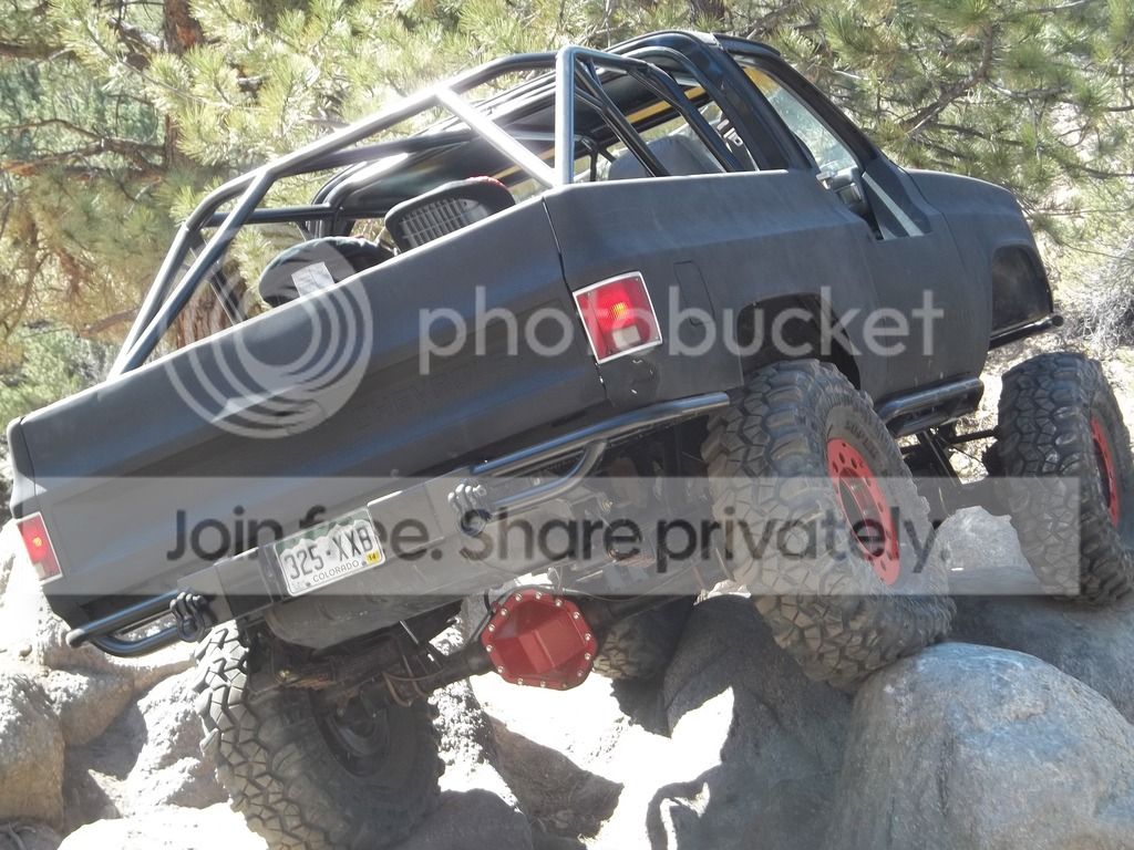

Here are a bunch of random pics we got....all in all couldn't have asked for better weather or a better day!

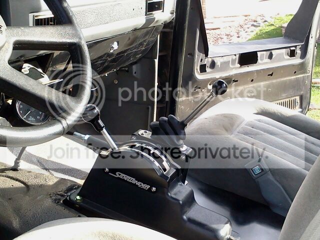

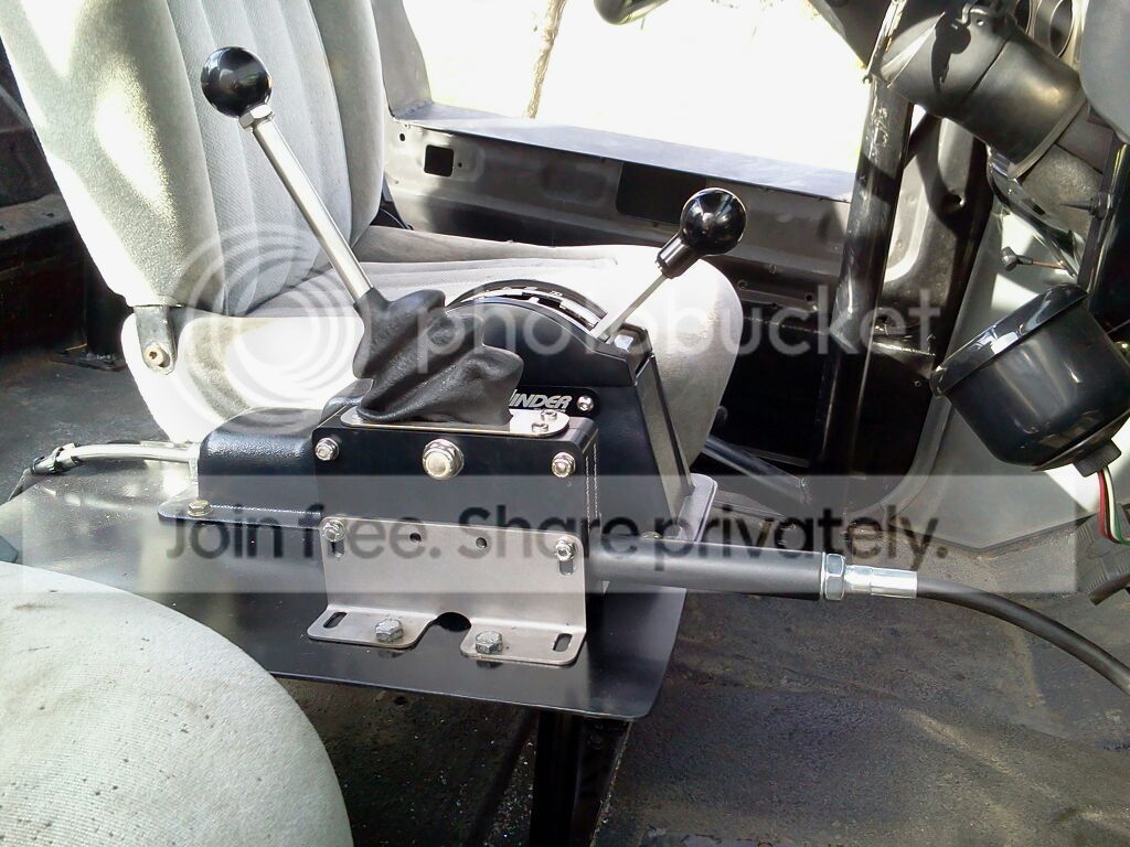

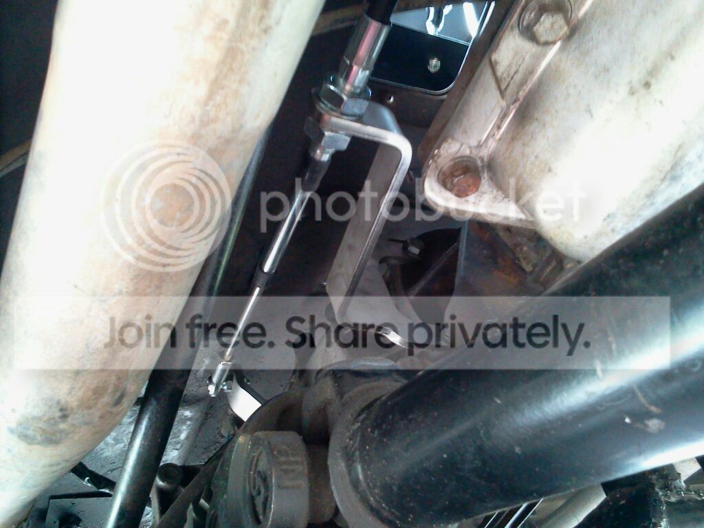

Little update. Picked up a cable shifter for my NP241 from JB Custom Fab. Ended up mounting it to my platform I built for my art carr tranny shifter.
Mounting it like I did changes the direction of the stick from the factory. All the way back like you see is 2HI, and all the way forward is 4LO
Mount supplied in the kit
It shifts real good from 2HI to 4HI to N to 4LO, it's just a little tough getting it out of 4LO. I think I will try and adjust it a little to see if I can help that. I will also just make a simple plate to cover the hole now from where the factory shifter was.
