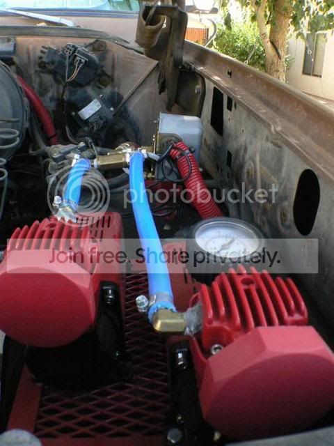

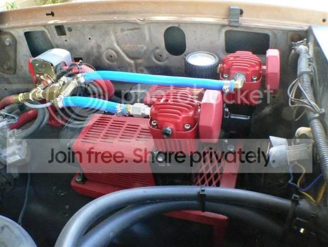

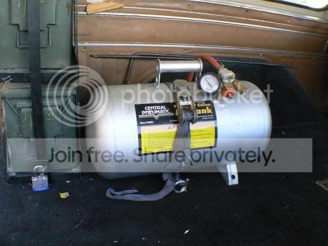

Hey, i know its an old post, but how well does that onboard air work" Will it run tools with two pumps and a 7 gallon tank? I have one of those costco pumps that i keep in my truck, never hooked it to a tank yet.
Also, are those hard wired in, with a remote power on/off?
I haven't plumbed it out yet. I built the stinger tire carrier because I wanted the tank in the back. The tank took more room than I wanted so I moved the tire. Both projects are halfway done.
I haven't done anything lately - too dang hot. My wife's anger and the outside temperature.
I'll get back to it next weekend. The output of the pumps isn't enough to run tools continuously. I suspect the air tank will allow for short operational bursts.

Bumper looks really good and I like your OBA setup. How does that work so far? Is it adequate for running tools or just filling up tires?
Thanks - The air system is just for airing tires.
Tools can be only be used for a couple of seconds then the tank needs time to refill - not really worth while.

I'm still considering a York compressor rather than the two baby air compressors, but I think I'm out of room. I'm not sure how to rig up the compressor mounting without messing anything up.
I picked up a cheap compressor from harbor freight, they have a website, it fills up my 3 gallon tank just fine and produces enough psi.
