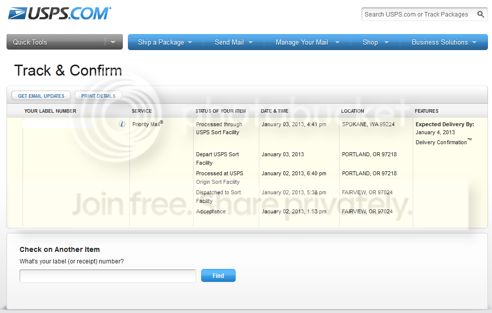

Looks like the package should be to you tomorrow!
