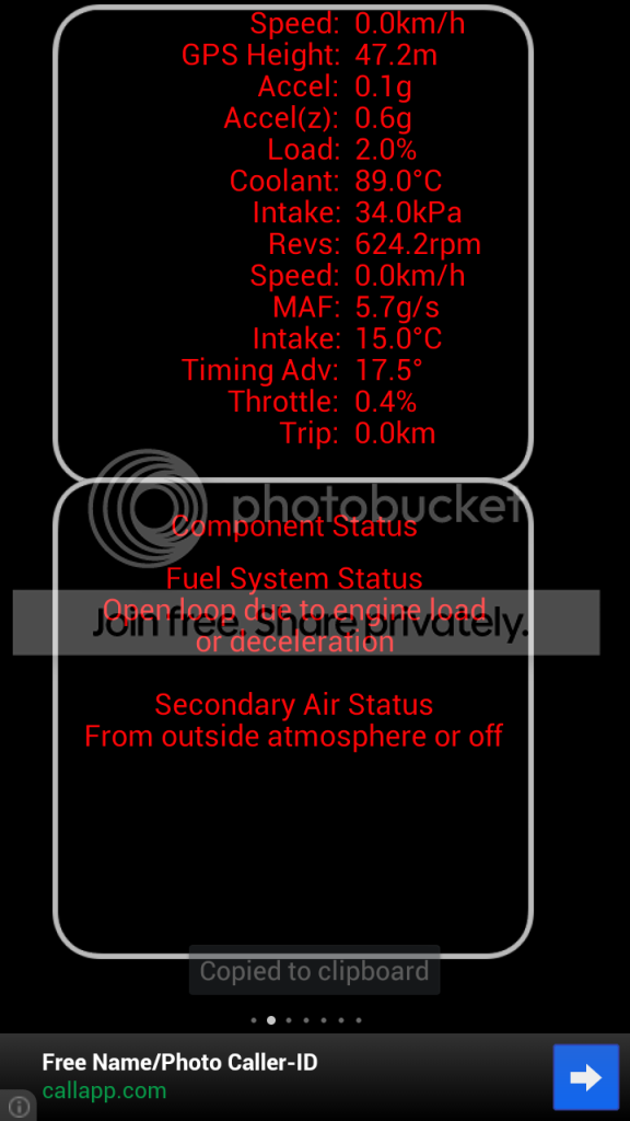

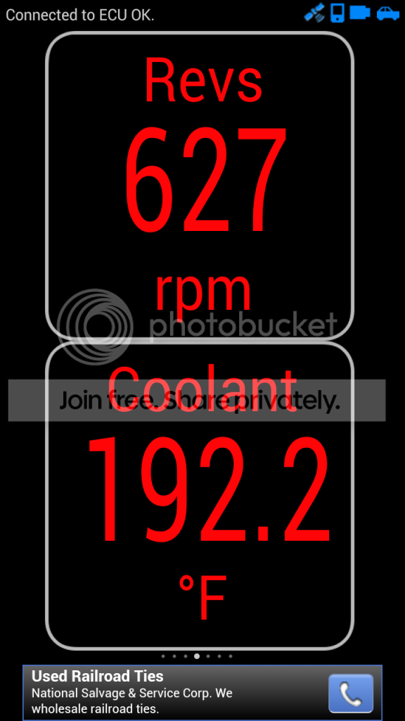

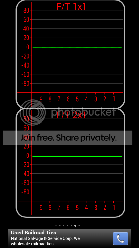

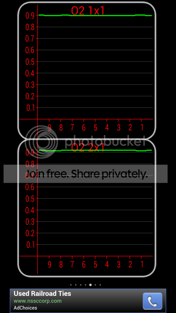

Well something isn't right still. It runs good, but never goes into closed loop. The o2's just hang at full rich and the fuel trim stays in one spot. I have some screen shots coming later.
I'm really sorry. There's to much going on with this, I should have only done it in person.
Is it running good? Driving good? Then can you read the codes?
If codes only indicate an O2 sensor issue you may have to change them and I'm not sure the correct ones will have the correct plug?
The issue with this is the older OS has no 5.3L equivilent, so it would be very hard to tune, even in person. Just like a cammed built engine, there is no starting point.
I haven't driven it yet. But I will tomorrowwhen iItake it to tthe paint Shop. So far it hadn't come up with any codes. I guess I just thought it would be as simple as copy and pasting the fuel and spark tables from a 5.3 into the ls1 computer. We'll figure out what to do when I get it back from paint.
The OS on yours was differant then any that came with 5.3L. So just copying in some and guessing at some would be... not good.
The newer OS is interchangable and came with a 5.3L, so copying in ALL the paremeters is good!
Now I think we found where differant O2 sensors come into play. Hope that is all it is, if so it will drive fine Open Loop.
