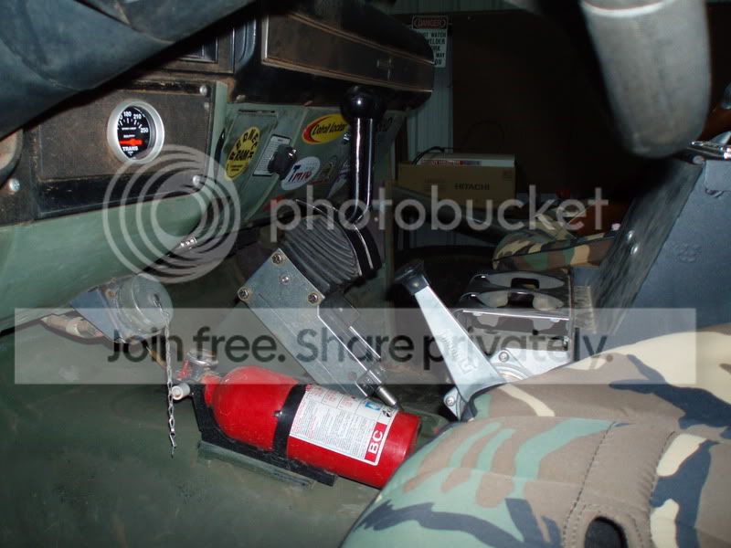

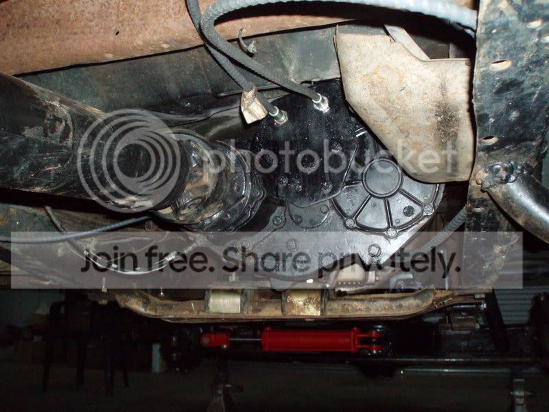

here are pics of my cable shifters and 205

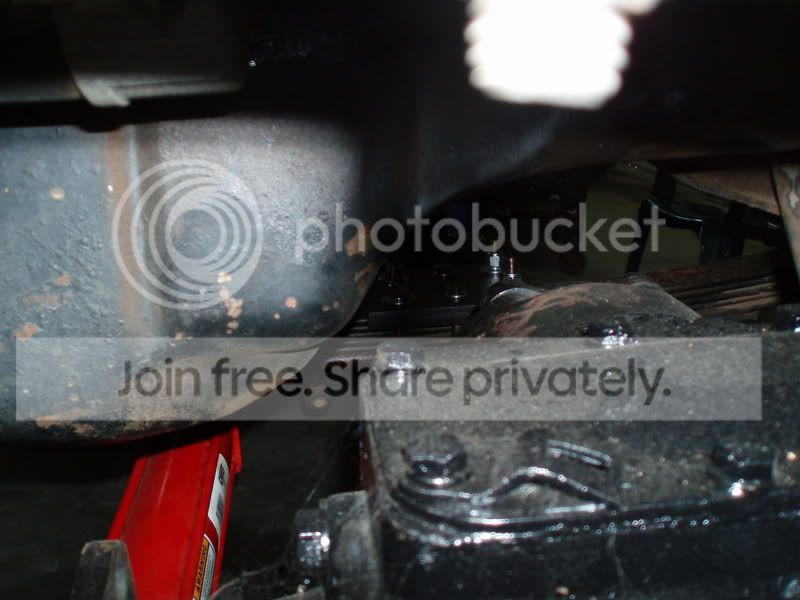

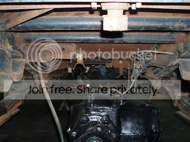

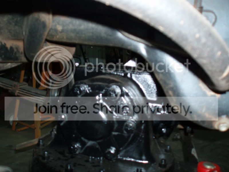

I've been seeing some questions about front rockwell clearance. So I decided to take some pics and give you guys some measurements.
My truck has 52" front springs (axle is moved 3" forward) and about 7-8" of lift. I'm also running a 6.2 but I think the engine crossmembers and oil pans are around the same.
The engine crossmember is 3" from the toploader and the oil pan is 4-5" at the closest point.
is that the ride height measurements? have you had a chance to flex it and see how close they get?
Are those cable shifters something you fabbed up yourself, or something you bought?
