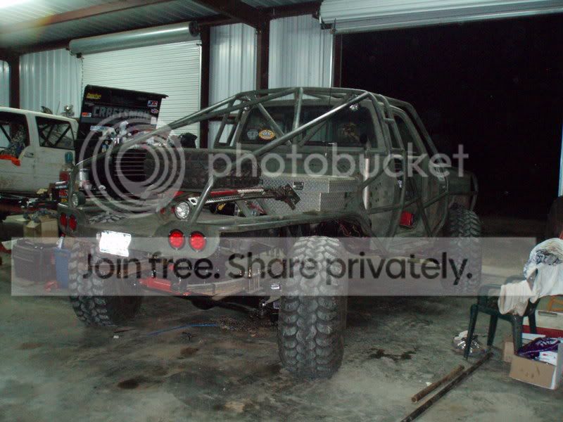

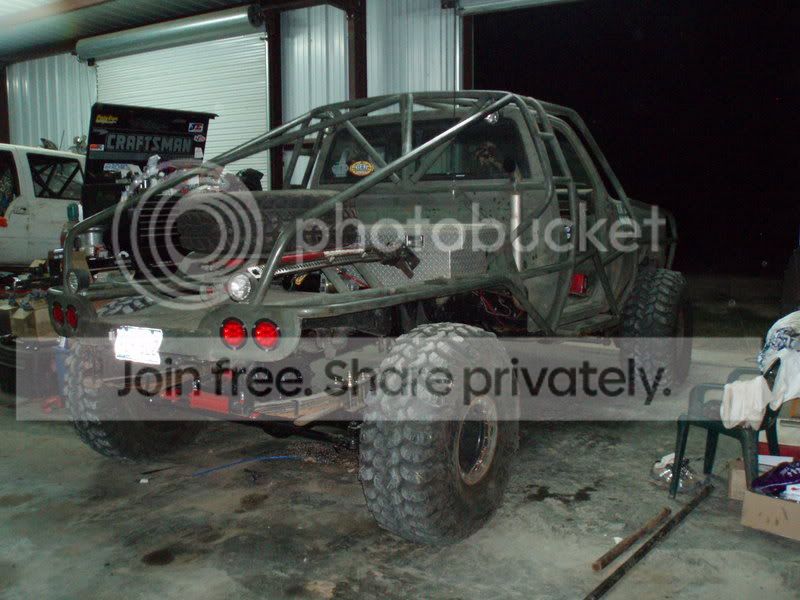

Well I decided to slap my truck together to take it to a Tx 4x4 meet and greet at Hooters. I had NO BRAKES so that was interesting. I'm glad I went and was thrilled to drive the truck again.
how is the rear steering setup? does the rear turn with the steering wheel or is there a way to turn the front and rear sepretly?
and i like this picture, the only thing missing is beer, lol

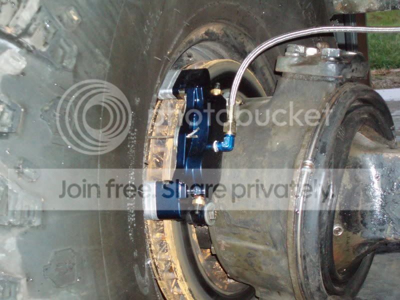

Front brakes

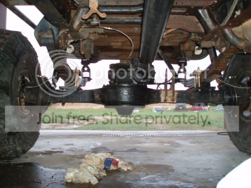

Rear axle with brakes mounted

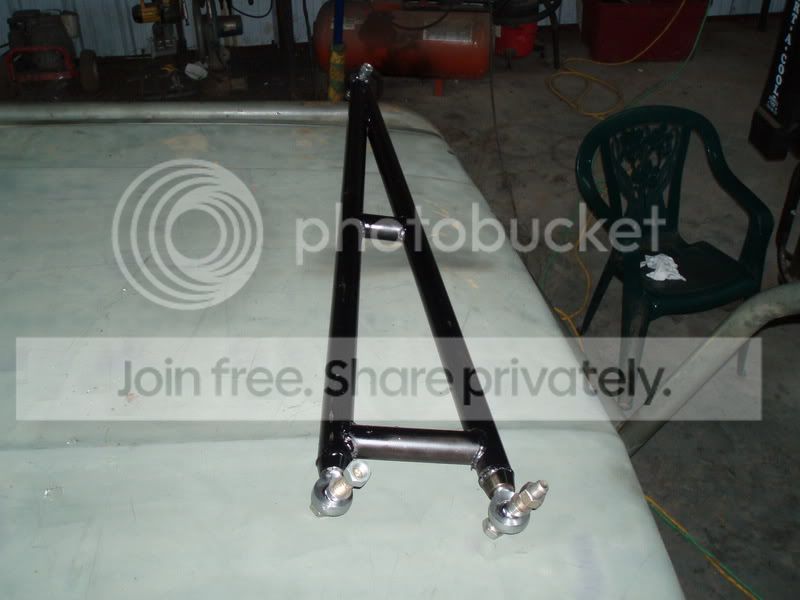

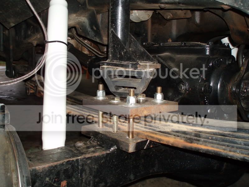

Trac bar
who needs up travel
All I got left to do is finish the trac bar mount and find a way to stop fluid from pouring out of the rear steer pump on angles.

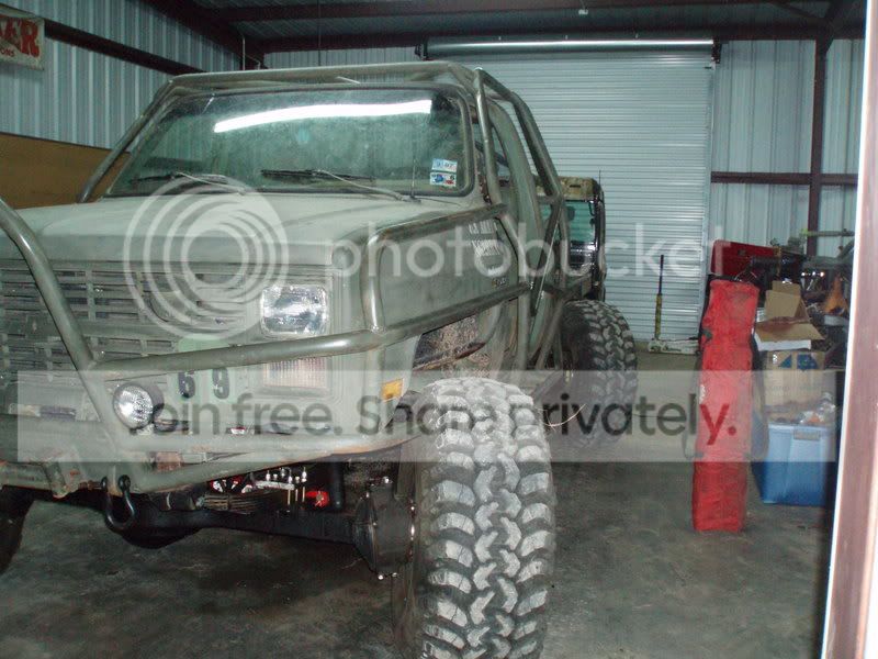

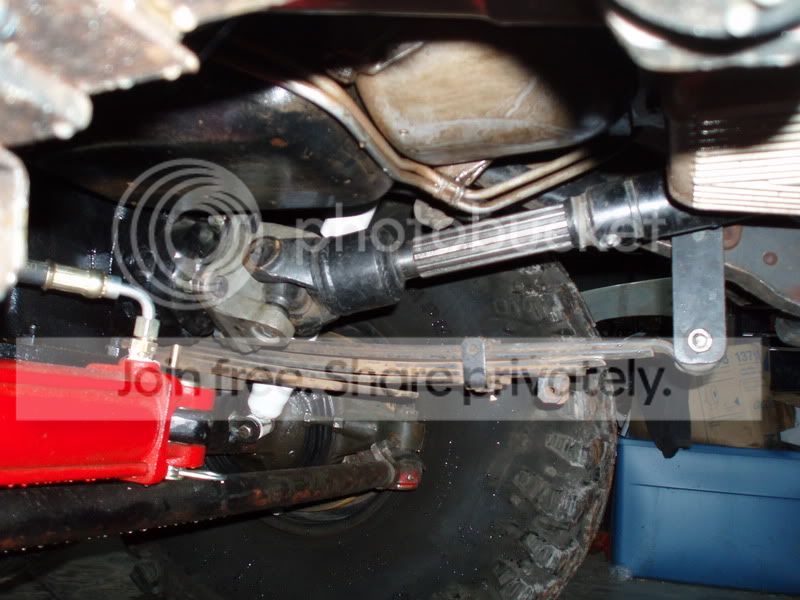

Here's a pic of the front shaft mounted
