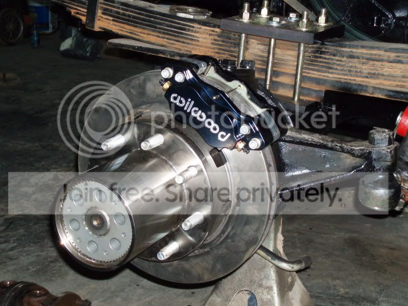

Big91RustyBucket said:
Can you take some pic's of the brake setup tonight for me?
Here you go, super 8, 3/4 ton front rotors, and wilwood dynalite calipers. The caliper is not mounted in this picture its just setting on the rotor.

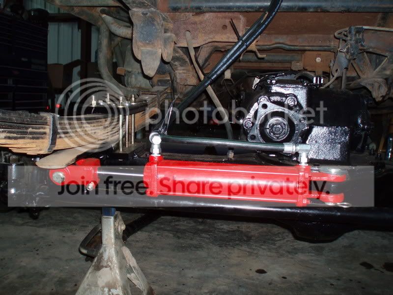

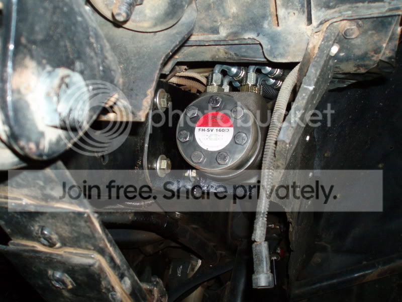

FINALLY some progress pics, front steering is done here is a pic of the orbital.

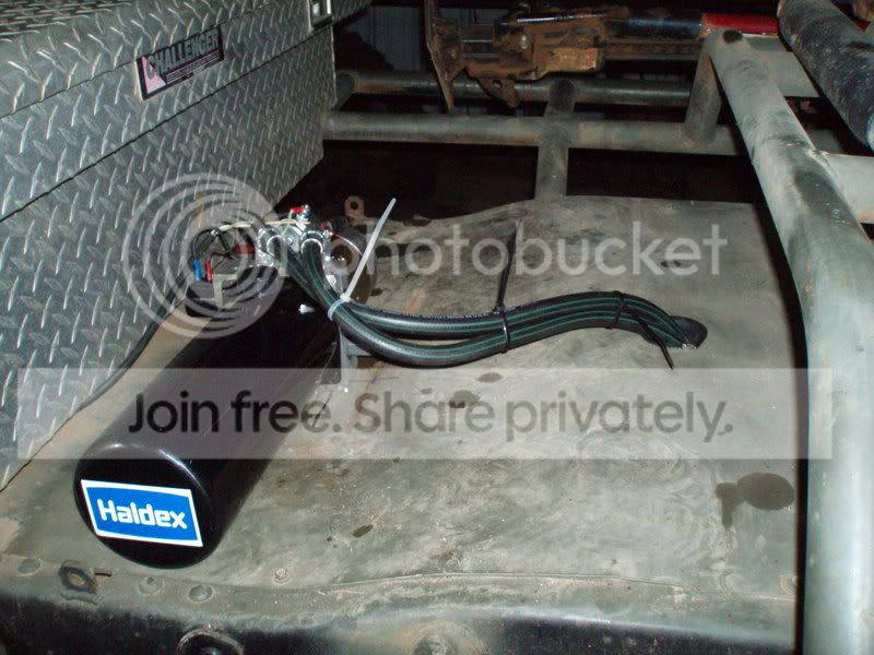

Also got the rear steer done, IT'S AWSOME. The pump works better than I could have hoped.
I had to chuckle at myself 'cuz the trac bar made me do a double-take 'cuz it has an angle for the axle instead of a radius.
I understand how the hydraulic system works for the rear steer but how did you run the valve to pump it in one side or the other? Basically how do you control what hose it pumps fluid through?
Is it a seperate switch like they run in the monster trucks or did you set it up differently?
