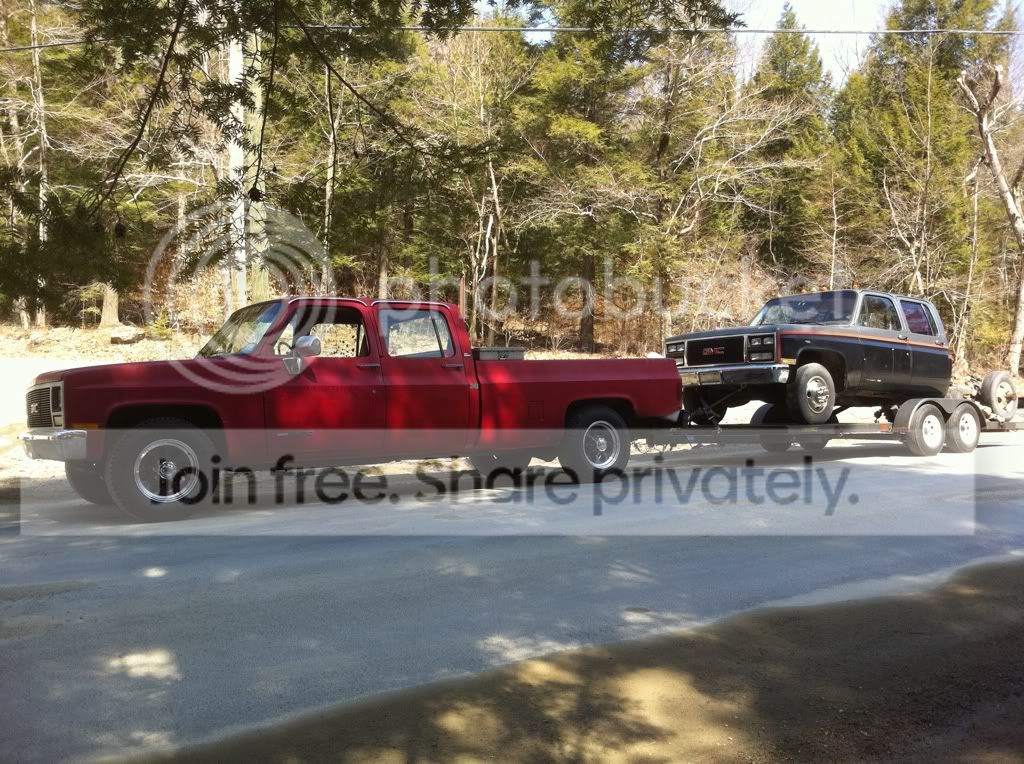

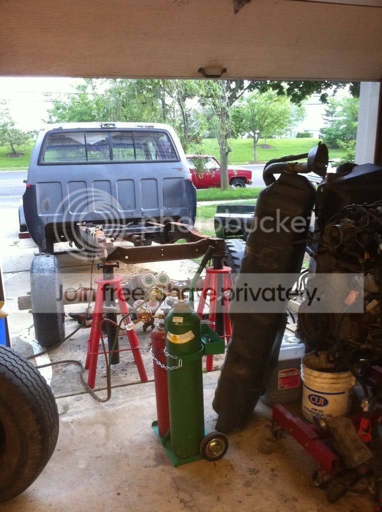

Here is me bringing it home from Albany (a strange place to find a mostly rust free chevy)
My tow rig is also an 89 GMC 3500 2wd, different nose though:confused:

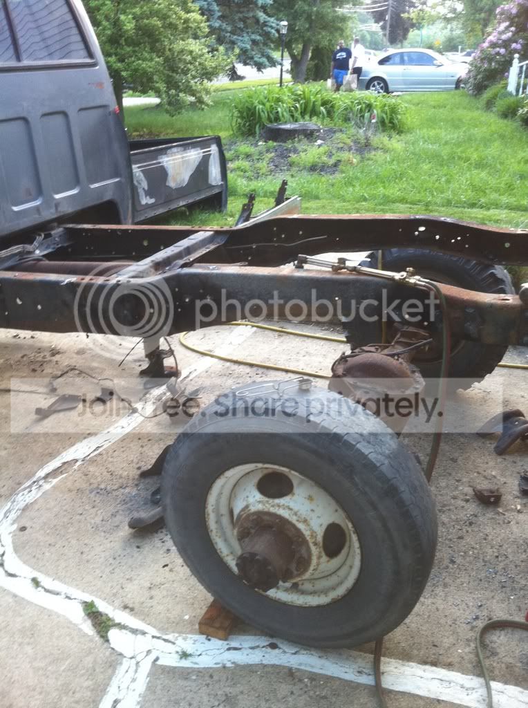

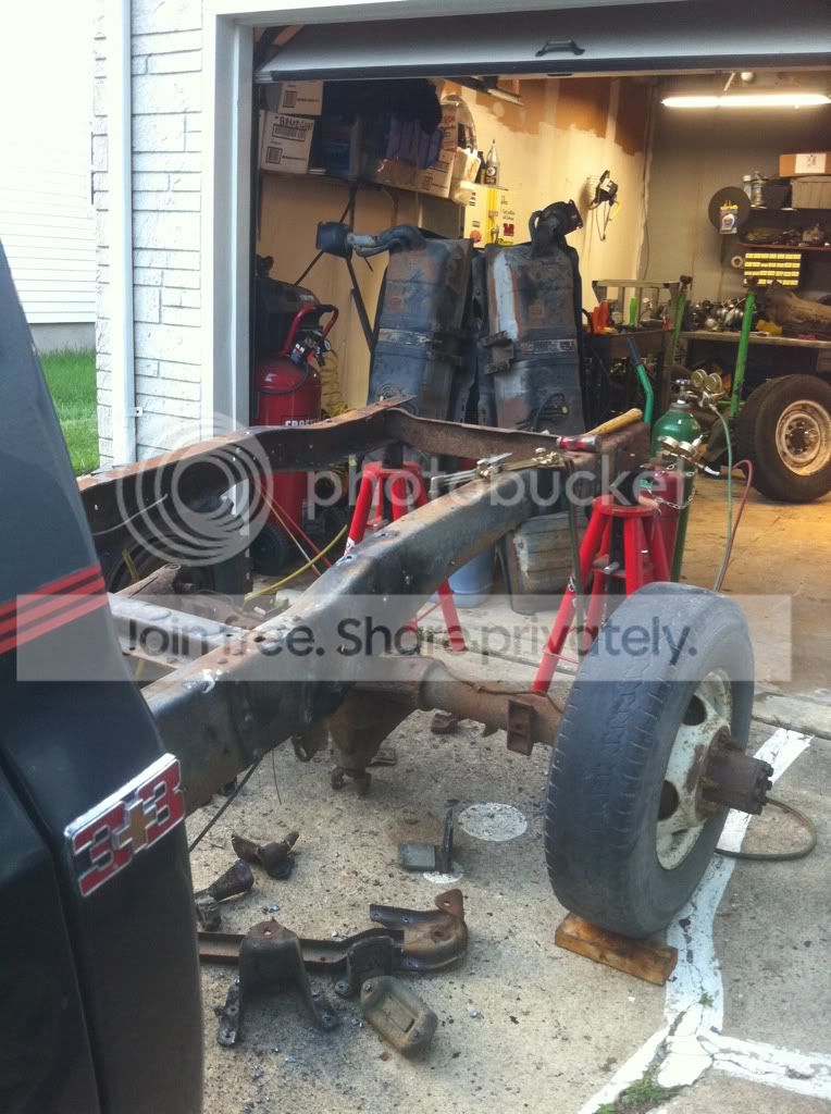

Started tearing it down.
Removed the fuel tanks Dana 70 and all brackets from the rear section of the frame

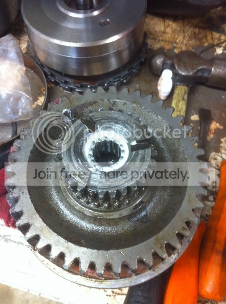

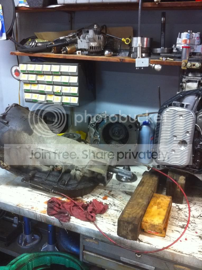

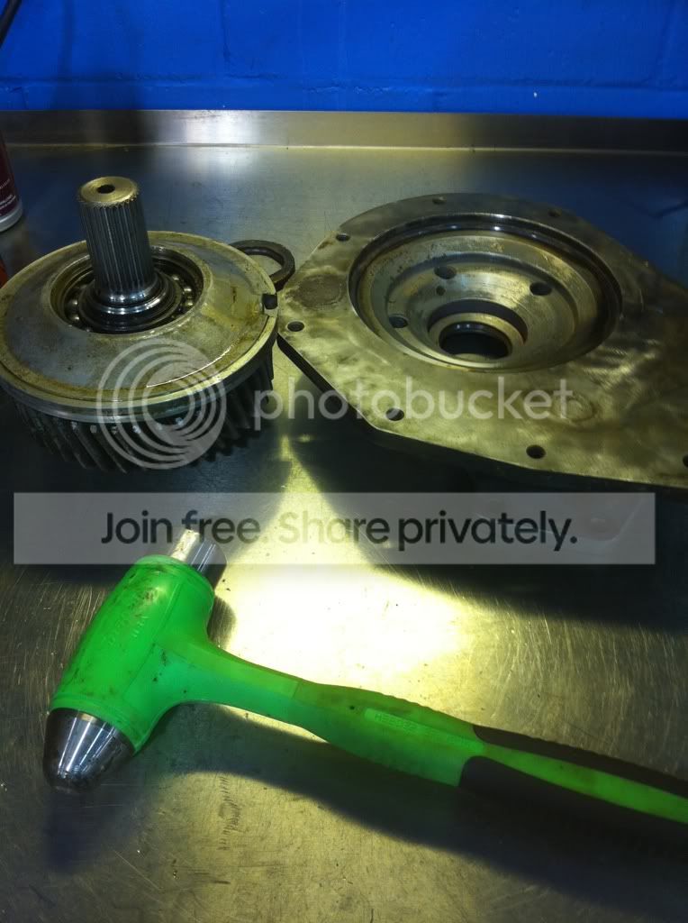

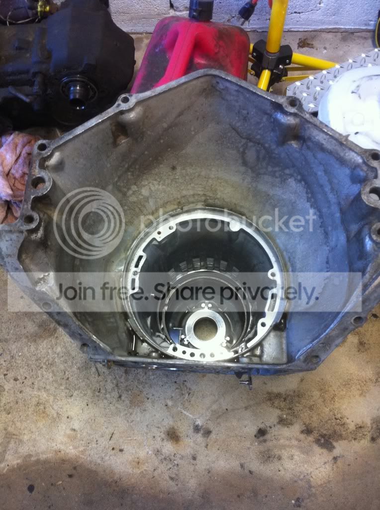

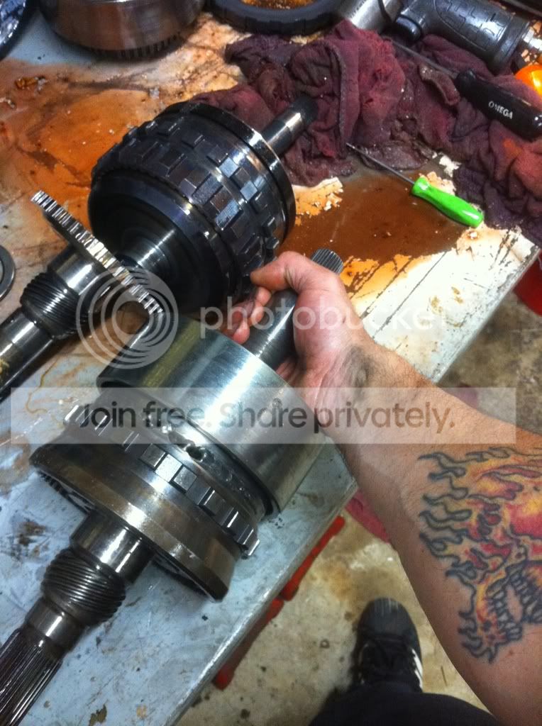

Had to change the output shaft on my TH400 to mate with the NP203.
So while I had it apart I am doing a complete rebuild and changing to a lower planetary gear set I scored off Pirate.
Its a Kilgore which lower 1st and 2nd gear from 2.48 / 1.48, to 3.1 / 1.57.

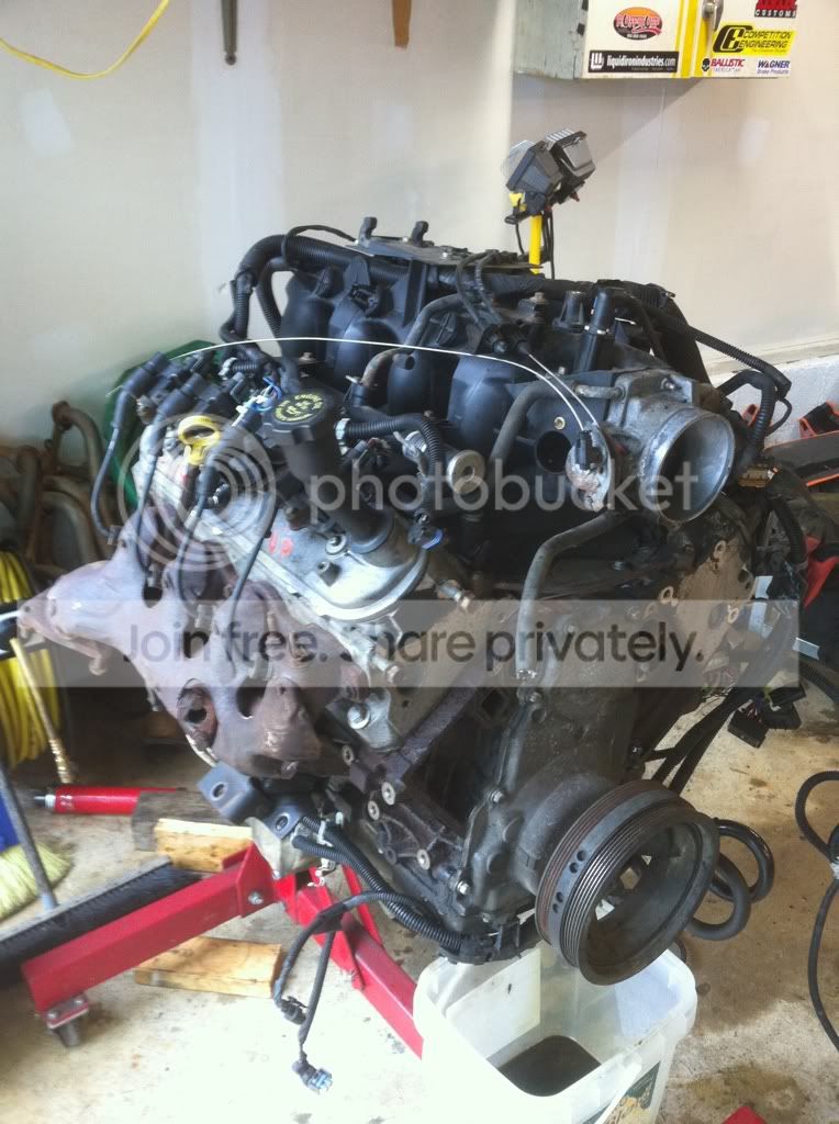

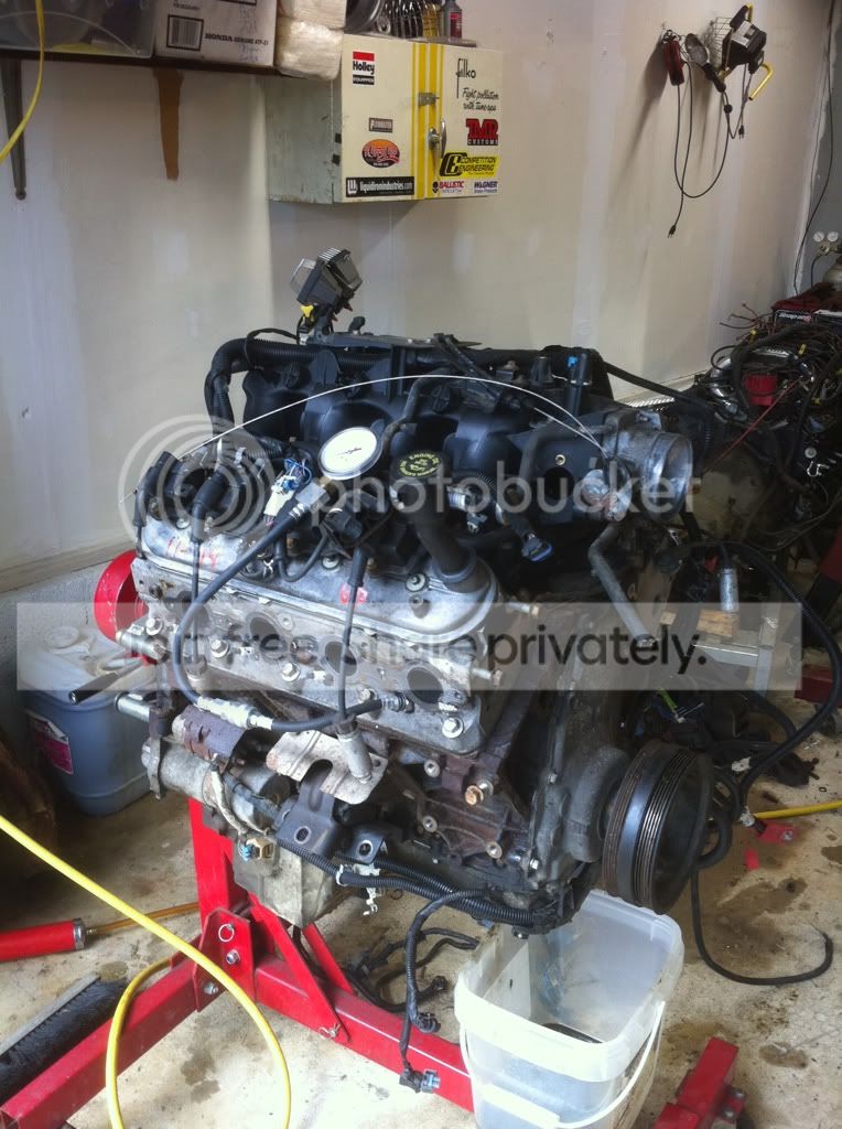

After running a TPI 350 in my shortbed for years Ive decided to go a different route and use an LS engine for the new truck.
I scored an 01 LQ4 6.0L complete for $800.
Started removing all the accessories to replace the water pump and clean everything up

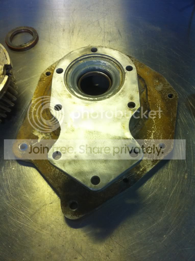

I bought a used Stazworks doubler plate and intermediate shaft for my 203/205
Cleaned it up and replaced the seal.

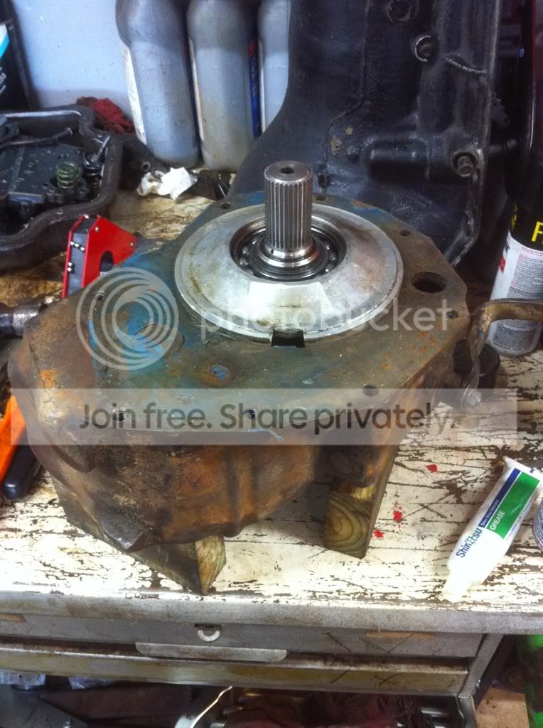

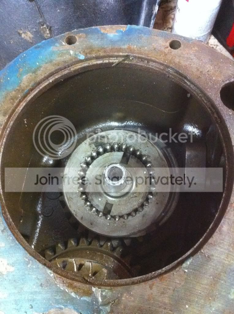

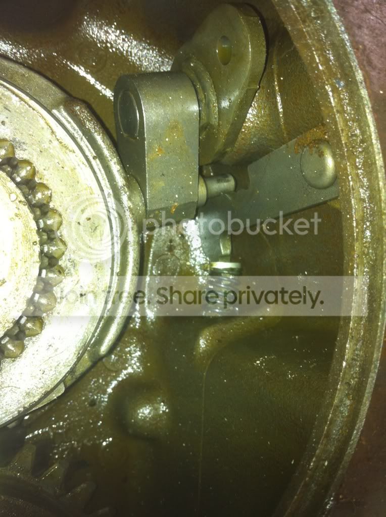

Got my 203 ready for the doubler and added a washer under the detent spring...
A trick I learned here on CK5.
I used some shinitsu grease from work, Im a Honda mechanic, to hold the needle bearings in place. Worked like a charm.

I started cleaning up the wiring and did a compression and leakdown test to be sure.

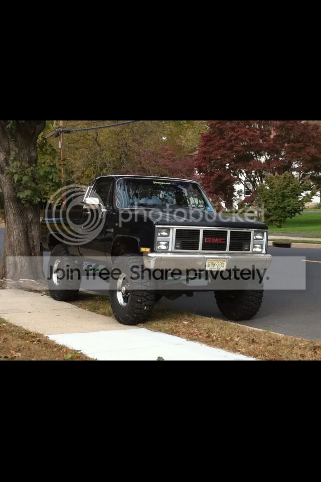

Here is a pic with the Nittos.
They werent on long...but they worked pretty well in mud and were awesome on the road.
