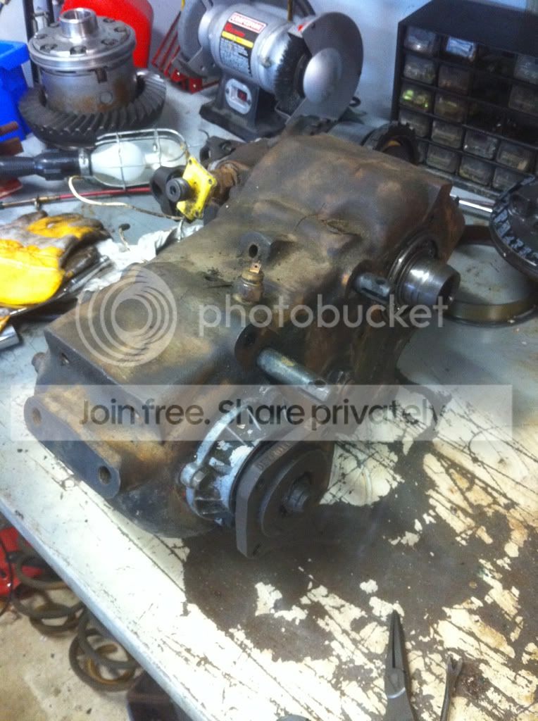

Since Im building a doubler, figured I might as well freshen up and twin stick the 205.
I was surprised how clean it was inside.

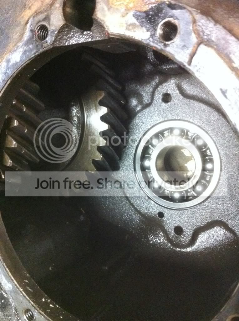

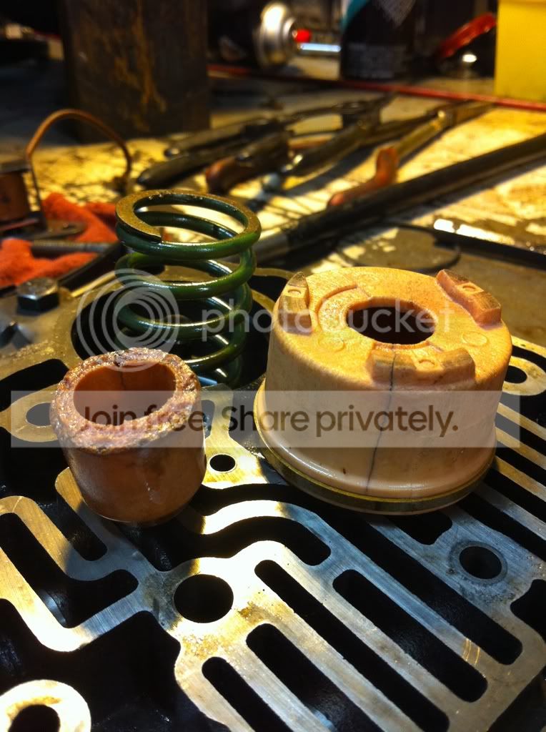

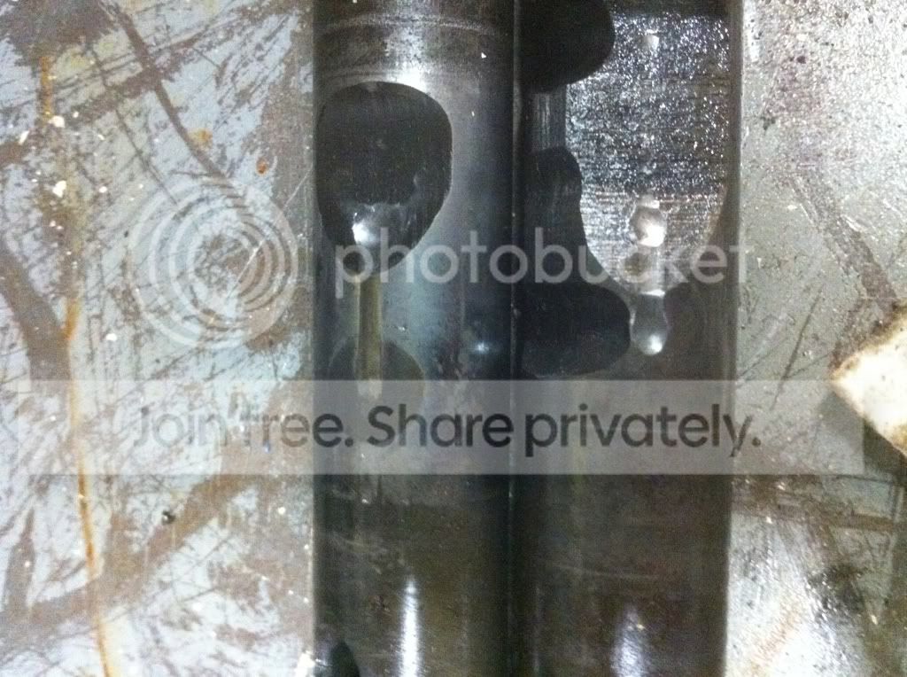

Finally got the parts I needed for the TH400.
All was going pretty well on the build until I came across this...
The 2-3 accumulator piston was broken, I missed it on the initial teardown.
Anybody have any ideas where to get one?
That is common for those plastic pistons. If you get the transgo shift kit I think it might come with a new aluminum piston, or they might sell it seperately. Personally I would just go to a local trans parts shop (where all the local trans shops get their parts) and get a new aluminum one for cheap.
Thanks for the tip.
I picked up an aluminum piston locally for $9
Trans is finally done.

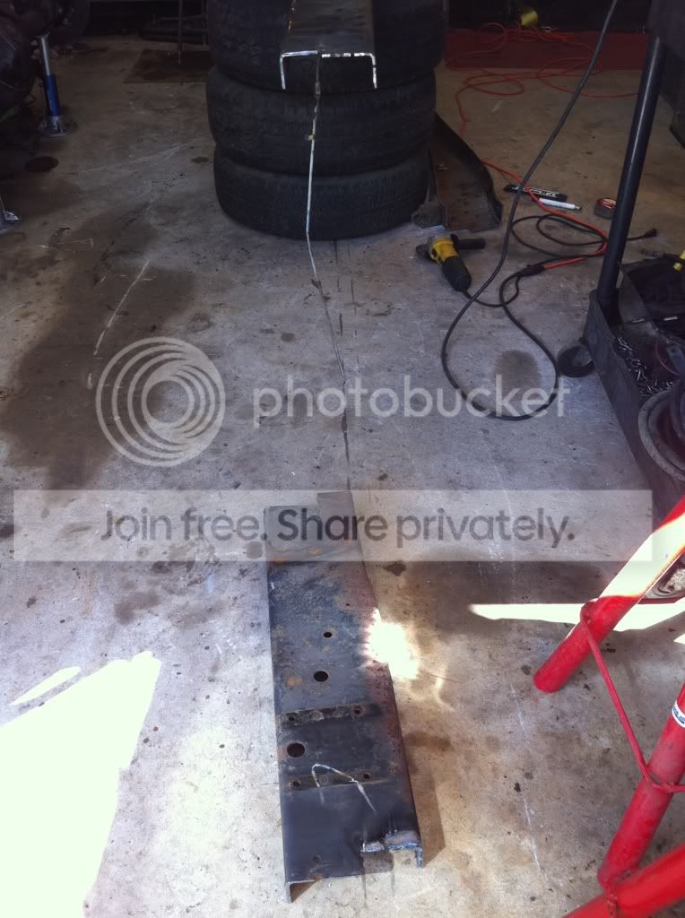

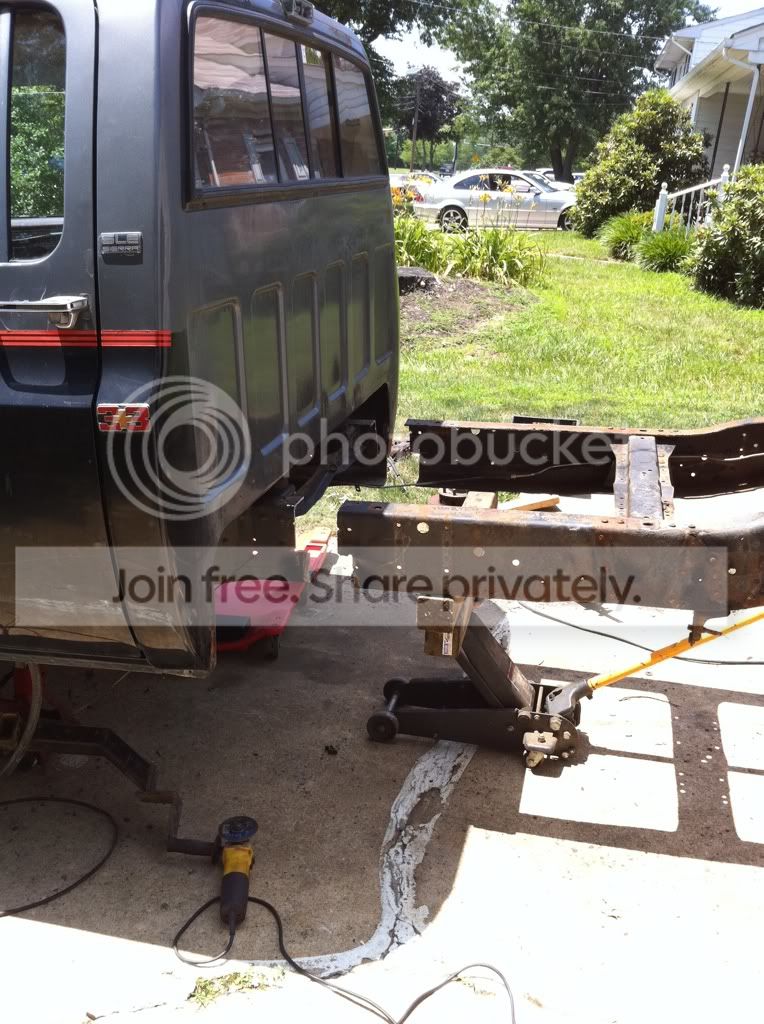

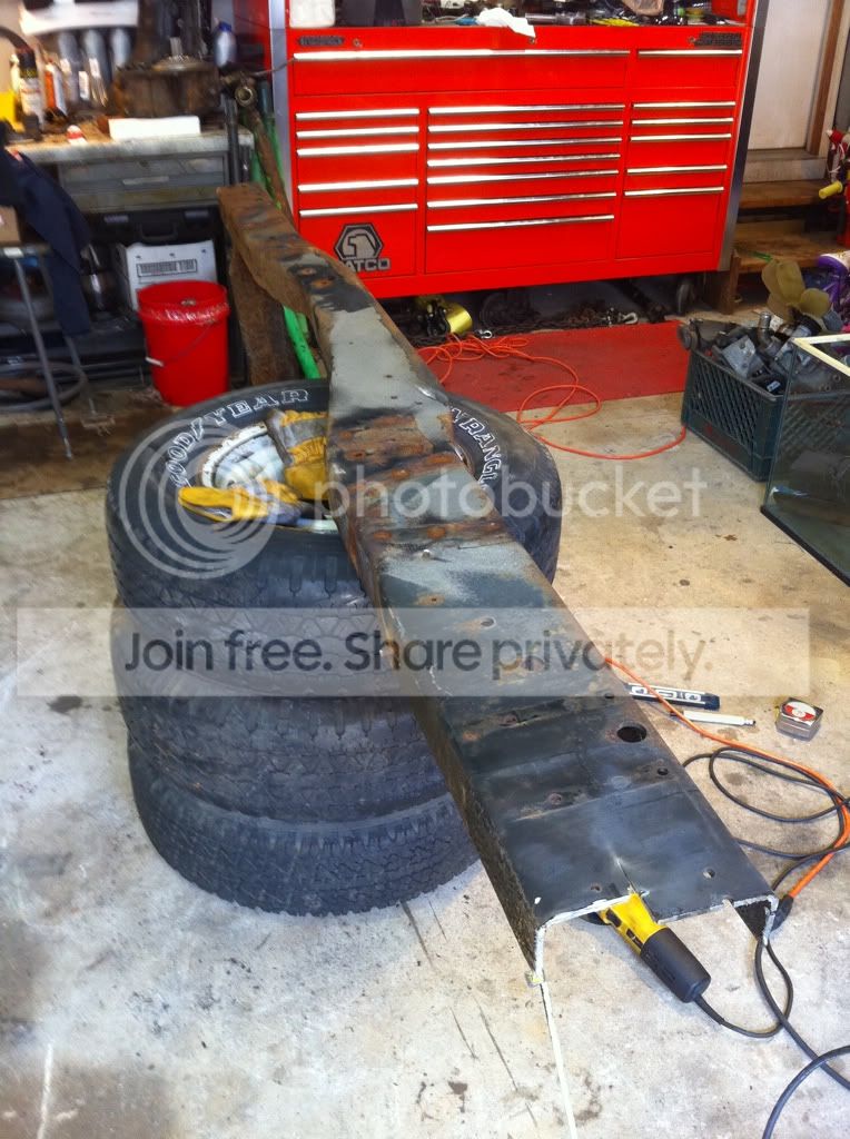

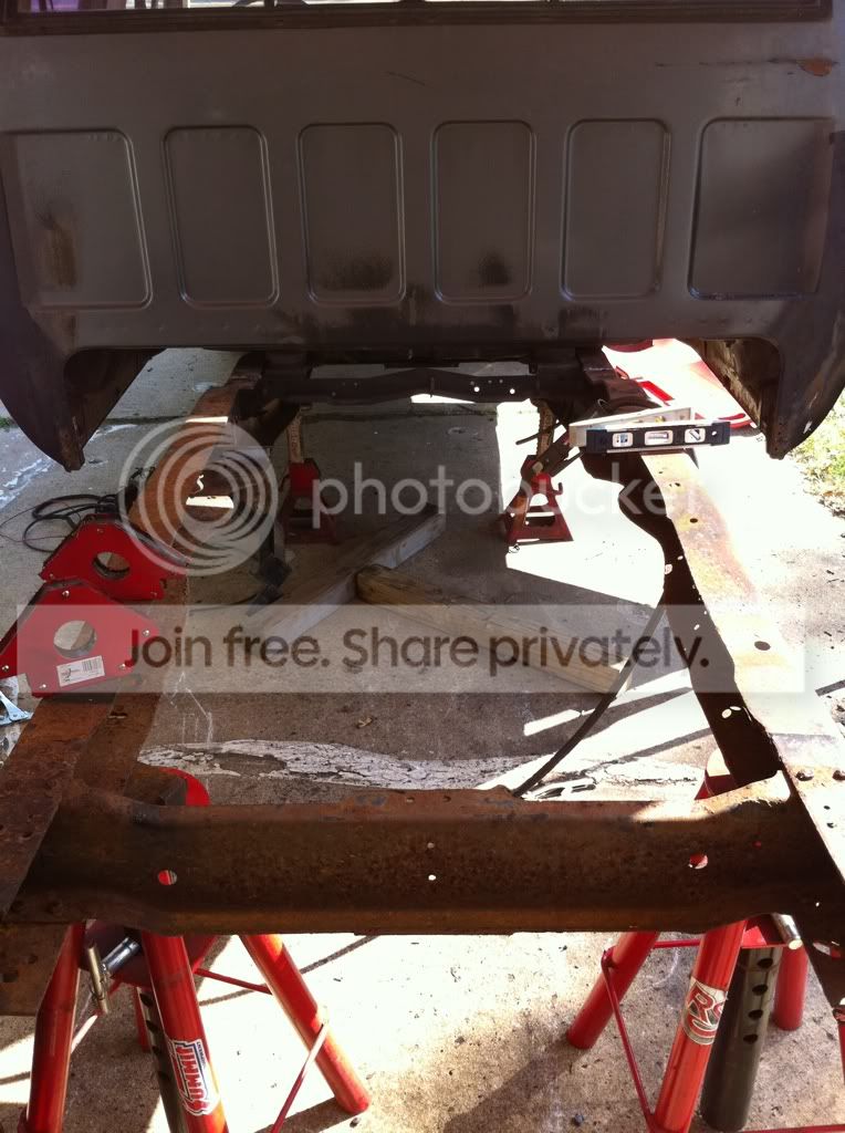

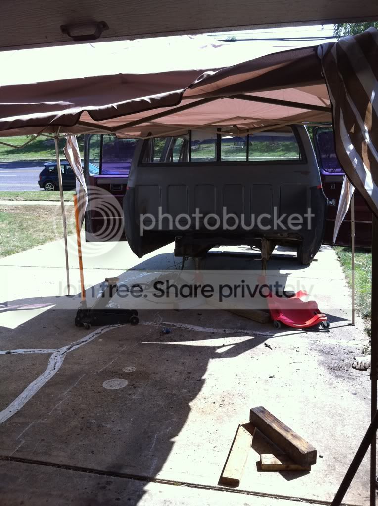

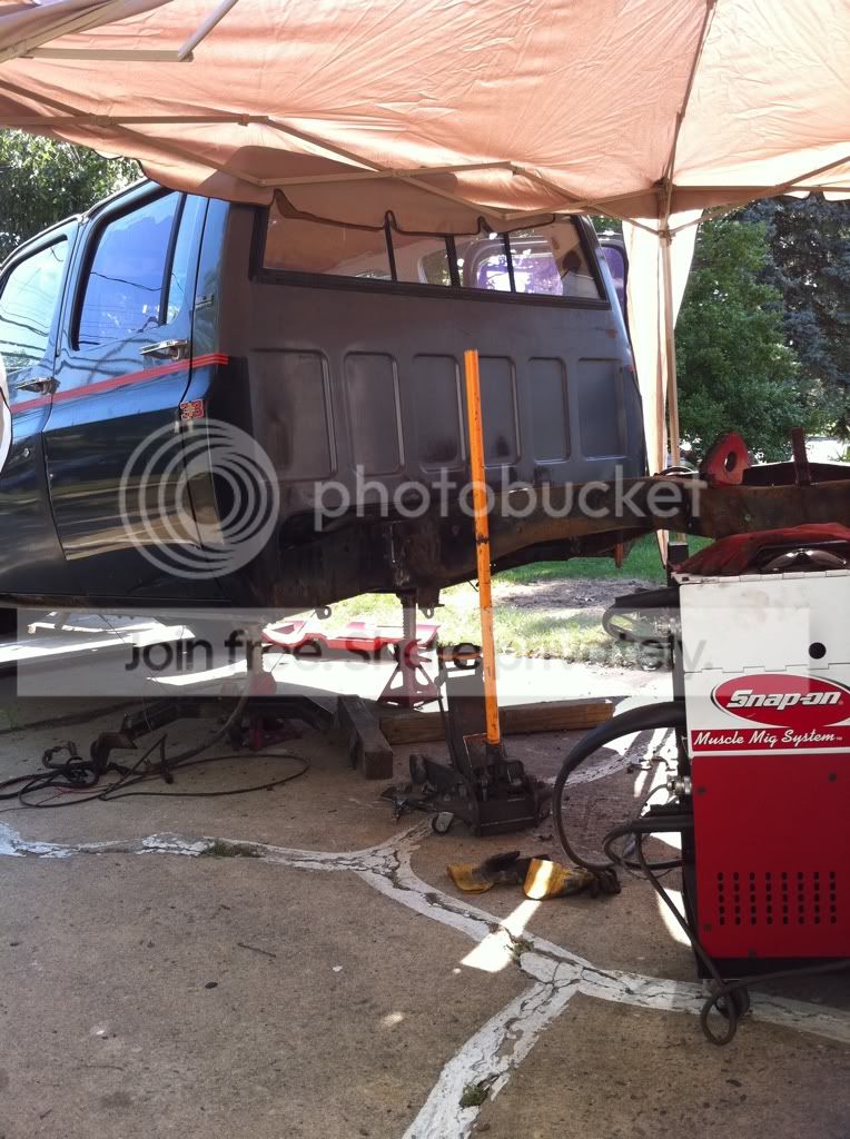

Spent some time working on the frame today.
Dig the low buck frame table
Took out 30 inches.
Was originally gonna take out only 12-14 and toss the short bed on it.
But Im gonna wheel it and I know I wouldnt be happy with a 150 inch plus wheel base.
Gonna have to section the bed now.

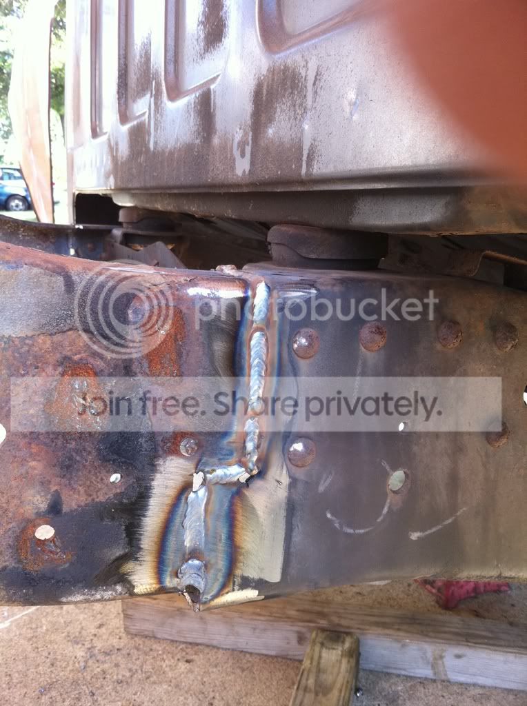

Still have to plate the inside of the sectioned frame and maybe even box it and add a cross member.
Then on to the rear suspension. Dual triangulated 4 link with coils.

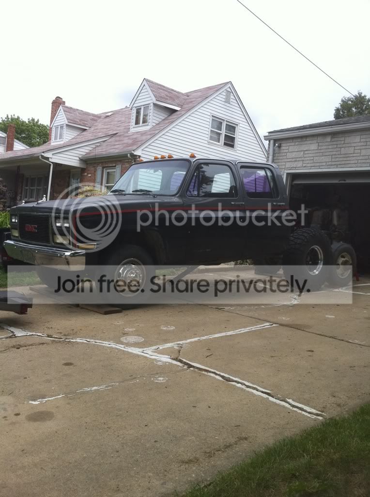

Thanks.
So am I...the bed will be about 5 inches from the front edge to the wheel well.
Just enough to retain the first stake pocket.
Its gonna be a trip taking my Sawzall to a mint shortbed.
