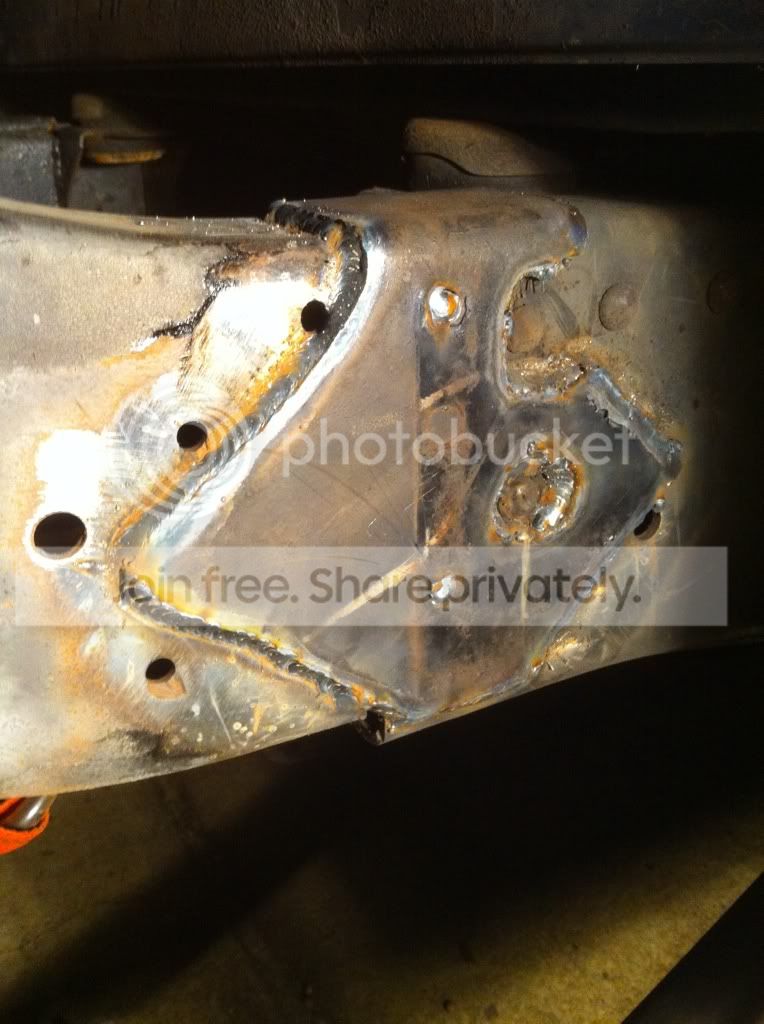

Fishplated the outside of the frame rail

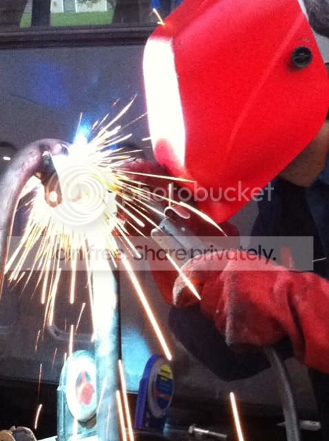

The wife caught a pic of me welding up the shock hoops.

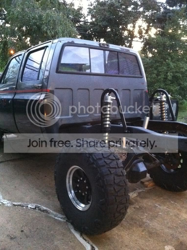

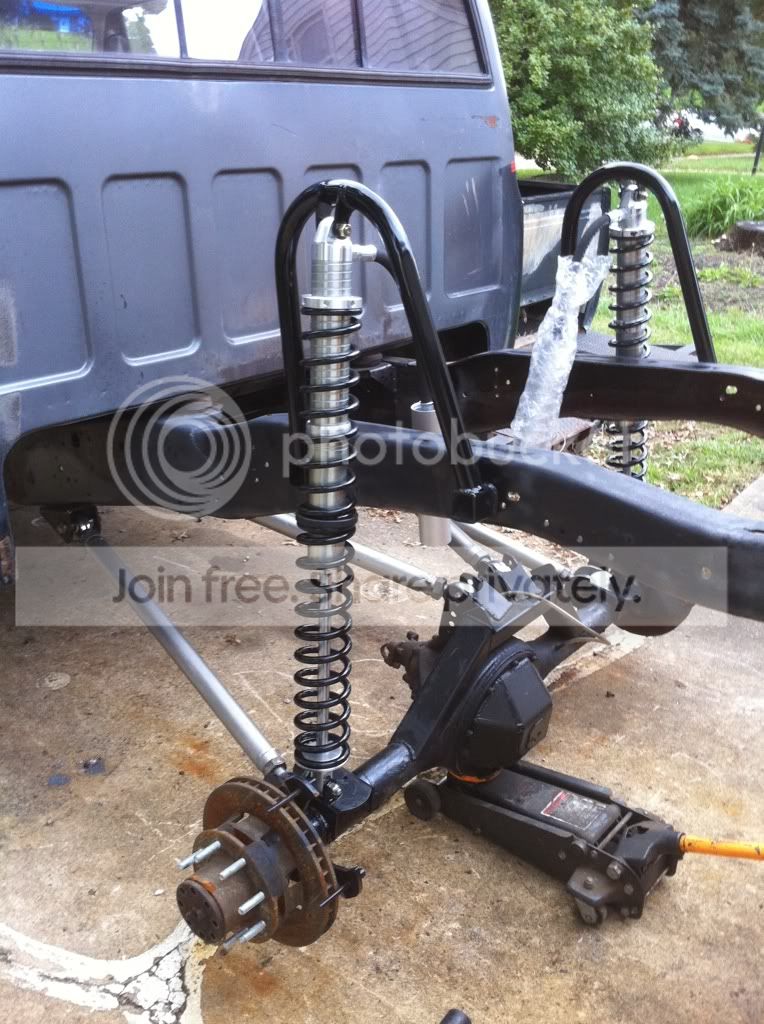

Got the coilovers mounted and cycled the suspension.
22 inches of travel and no axle steer.
Spring rates look good, ride height is within an inch of where I want it.
Which is good considering the bed, fuel cell etc have to be mounted.
Now I have to get the engine trans and t cases mounted so I can move on to the front suspension.
Considering an inverted 3 link...Opinions?
Subscribed:thumb: that thing looks bad as h3ll:bow:

You should probably add a cross bar between the shock hoops, all the vehicle weight will want to push the hoops in.
