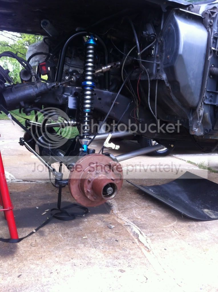

Made a steering shaft to clear the coilover.
Because I mounted them angled in at the top the d/s coilover is directly in the path of the OEM shaft.
Used 2 XJ shafts and a 3/4 heim joint to snake the shaft around the coilover.

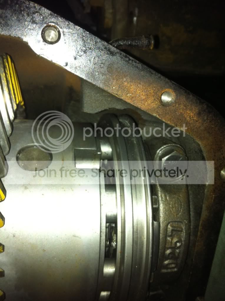

Got the Dana 60 built. Putting the axles together was a breeze. CTMs are by far the easiest Ujoint Ive ever installed, no little needles to fall and jam things up.
Had to grind away part of the housing to install the OX.

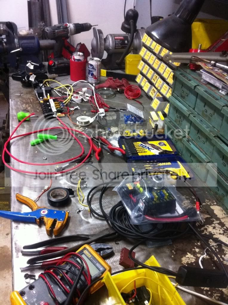

Been busy re wiring the whole truck.

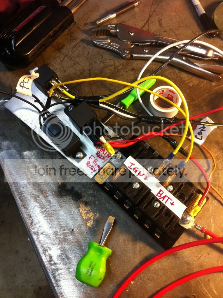

Made a fuse/relay box for the 6.0

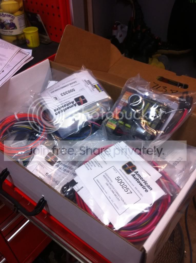

The underdash harness was pretty hacked by previous owners, so I ordered a new wire harness kit from American Autowire.
