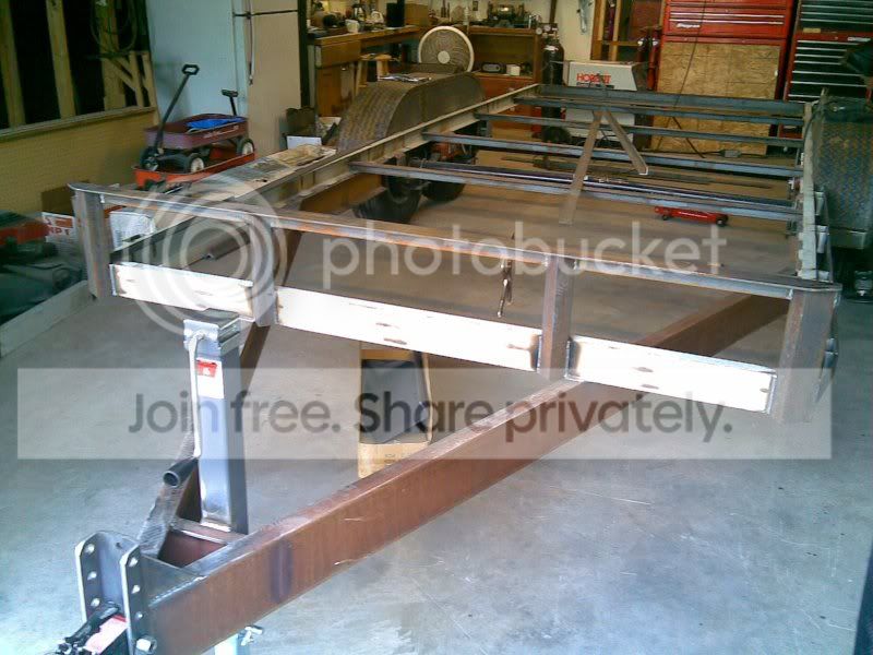

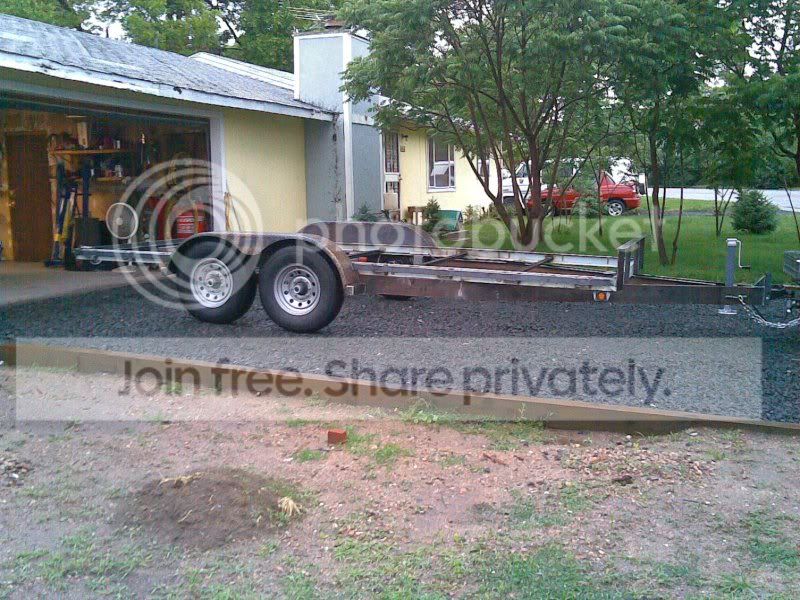

Well we got a lot more done today. It will be painted tomorrow night. Here are some of the pics....
The fornt bumper bar,

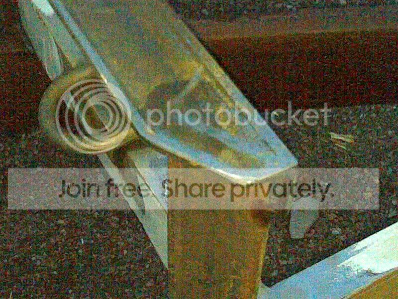

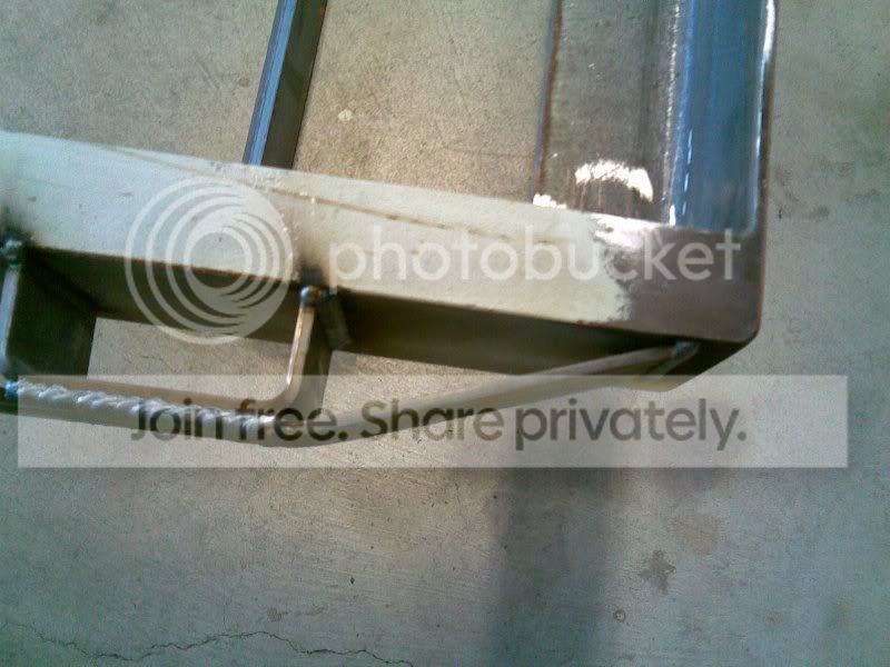

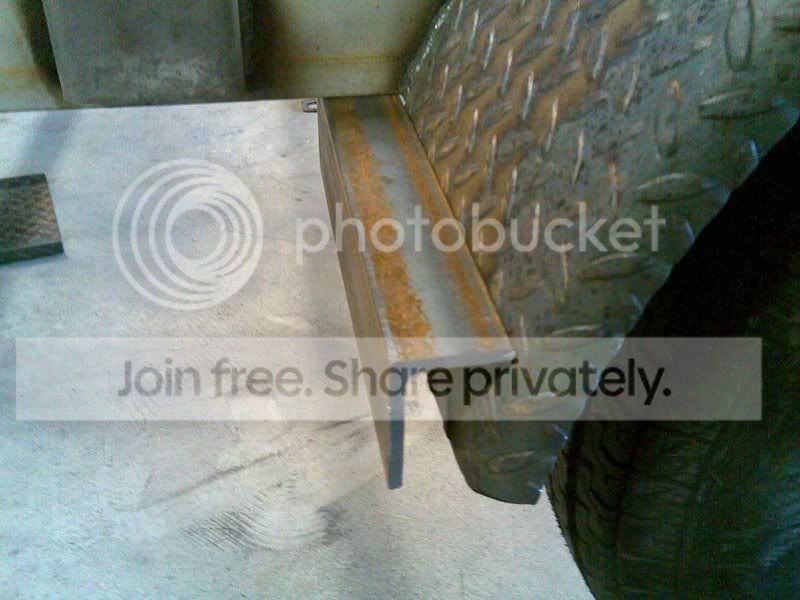

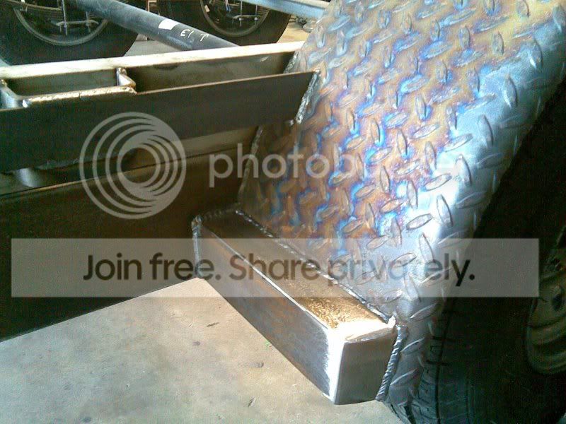

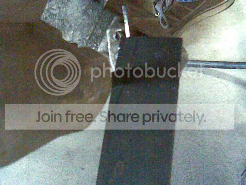

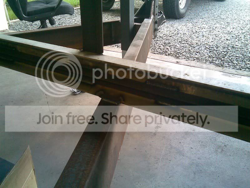

Starting the fender steps/supports
Steps finished....

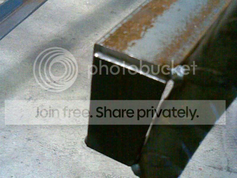

The support for the floor on the front of the trailer.

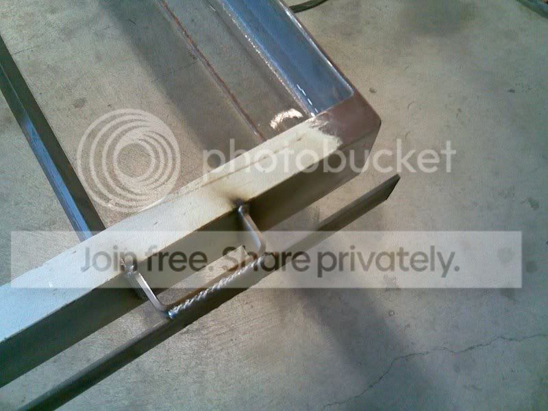

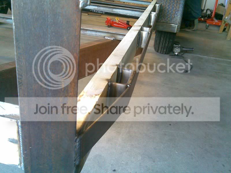

Making the rub rail along the sides of the trailer....
Finished rub rail.

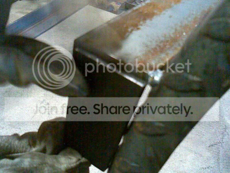

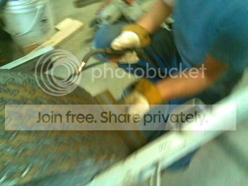

A pic i took thriugh the helmet... All of the pics on this thread were takin with my cell phone...
that is one helluva cell phone camera you have there. Mine takes crap pictures. That trailer looks great. Nice welding.

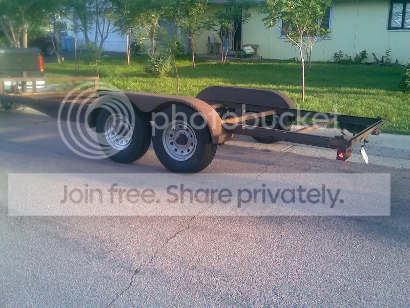

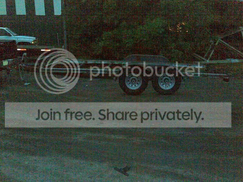

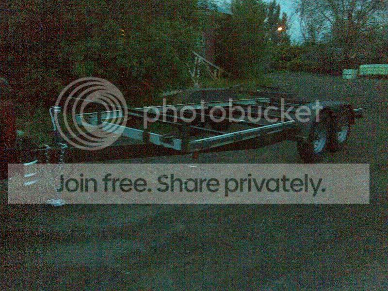

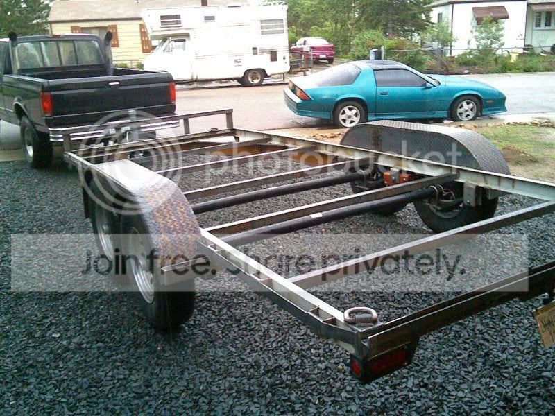

All the welding is done and it is now sitting in a piant booth.
I will pick it up after work tomorrow and finish wireing it then put the floor in it then its finally done!!!

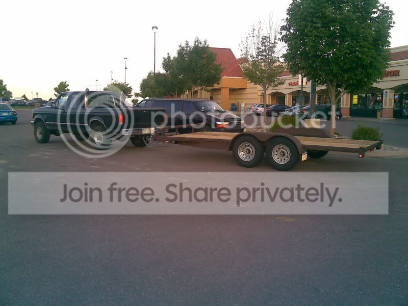

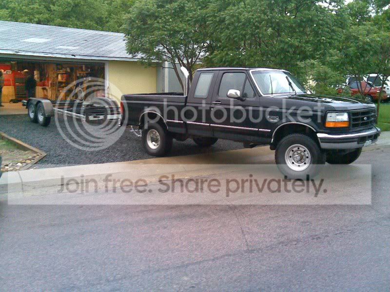

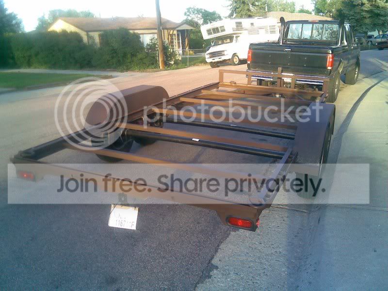

Here are a few pics hooked to the tow rig...

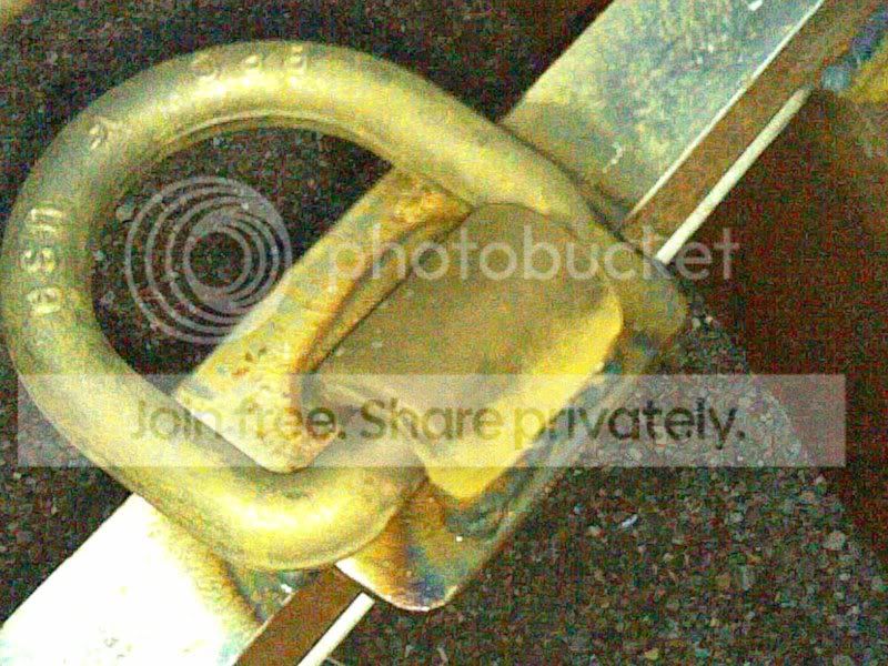

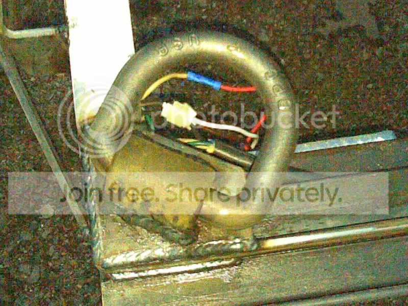

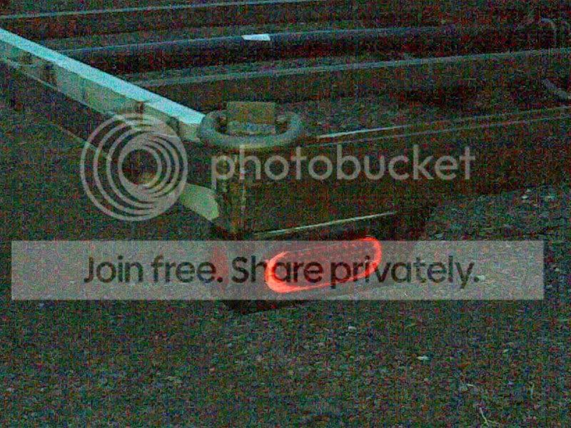

The D-ring in the back,

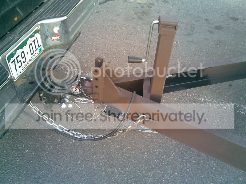

The front,

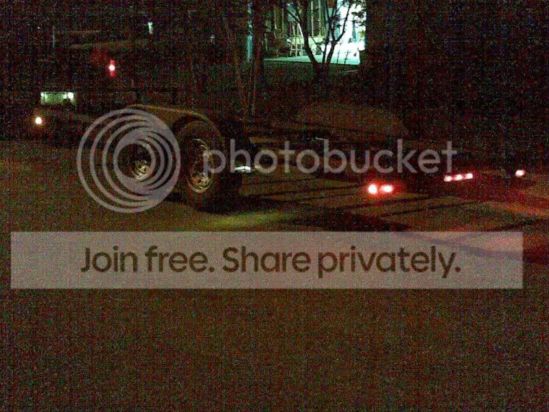

The rear light boxes,

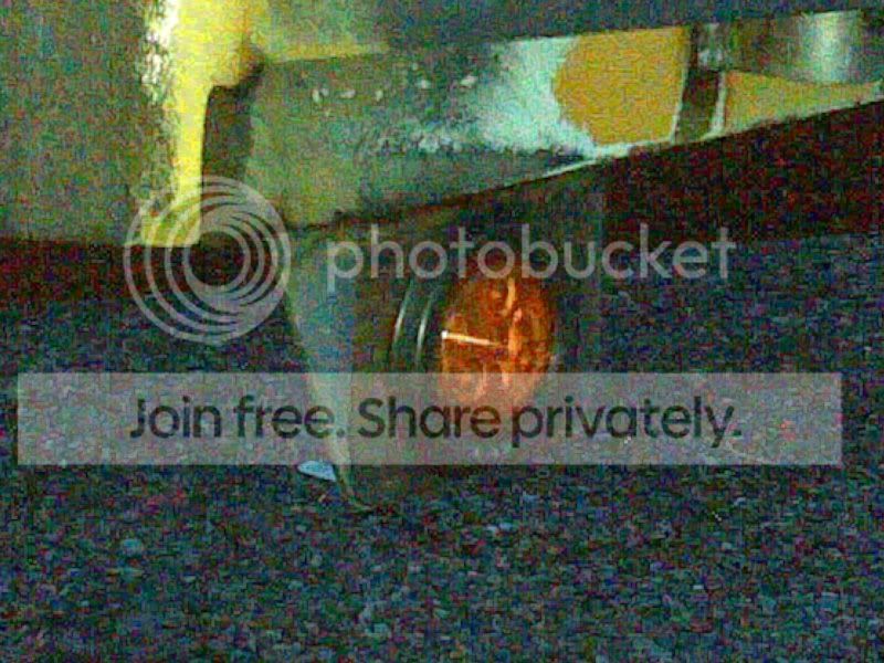

The front marker lights.
Sorry for the few crappy pics, it was to dark.
As far as money..... I get everthing at cost... under $1500... with all the biggest baddest parts...
As far as labor.... about 25-35 hours
It was all worth it .. its bult to where i now it will hold up and suit all of my needs...

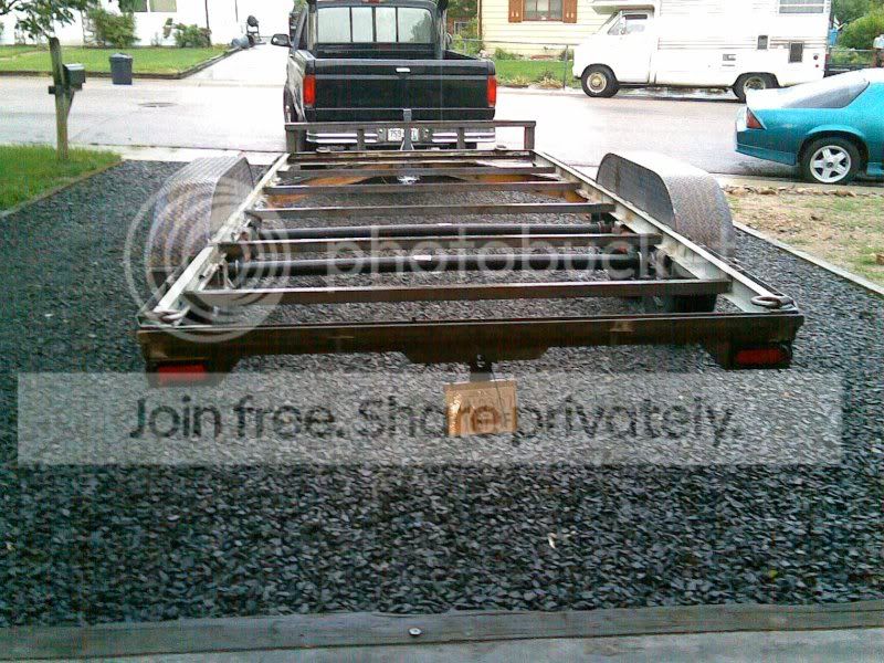

Got it all primed with industrial strength primer. I also finished all of the wireing. I will post better pics tomorrow, Its time for bed....

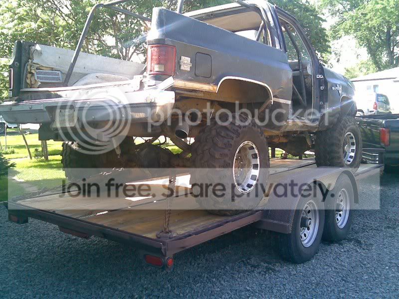

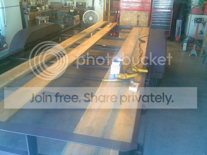

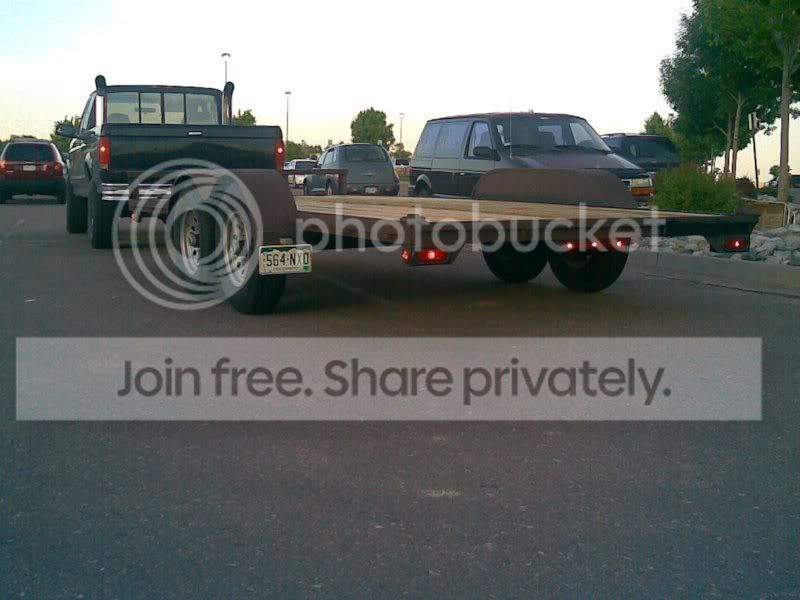

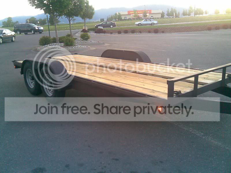

The deck being put on....

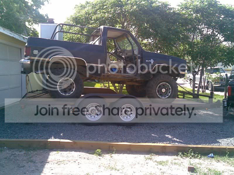

Hooked to the truck.
One board short... have to go buy another one.
Its got the blazer on it.....
did you do anything to weather proof the wiring?
i saw the uber cheap crimps in one of the pictures, if it were me, i would have used the weather proof ones.
