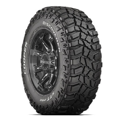

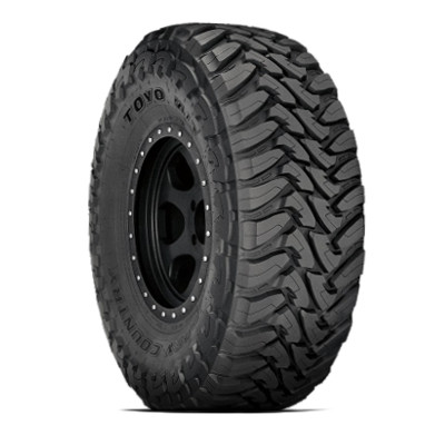

It needs tires. I way overthink tires cuz I'm a tire nut kinda and need some advice from like minded people on them. It currently has 315/75R16 tires on factory 16x6 wheels. Too wide for the rims. It has spacers out back between the duals. I am looking at the 255/85R16 Toyo MT that is 33.5" tall by 10.2" wide or the 285/75R16 Cooper STT Pro MT that is 33" tall by 11.2" wide. I can get both for about $250 a tire from my local tire supplier. I have had both in the past and know they are great tires. This truck will be for all around farm use and mountain camping and hunting hence the MT. I would need to keep the spacers out back with the 285 but could probably lose them with the 255. It has about a 4" lift and also the camper package which got it 4:10 gears. Let me know what you guys think.
My other cheaper option would be to keep the 315s and just put four new ones on the rear for now since the fronts are still usable.
I didn’t know you had that truck. You seem to know a lot about Ford Diesels so Right on! I like it.
Probably 255/85/16 would be the best bet for what you intend to use it for although the 35s look cool!
Only thing I know about that size in 255 are Toyo M55s. I’ve had 3 sets on my Duramax, I like them but I don’t think I get the miles out of them that I should.
