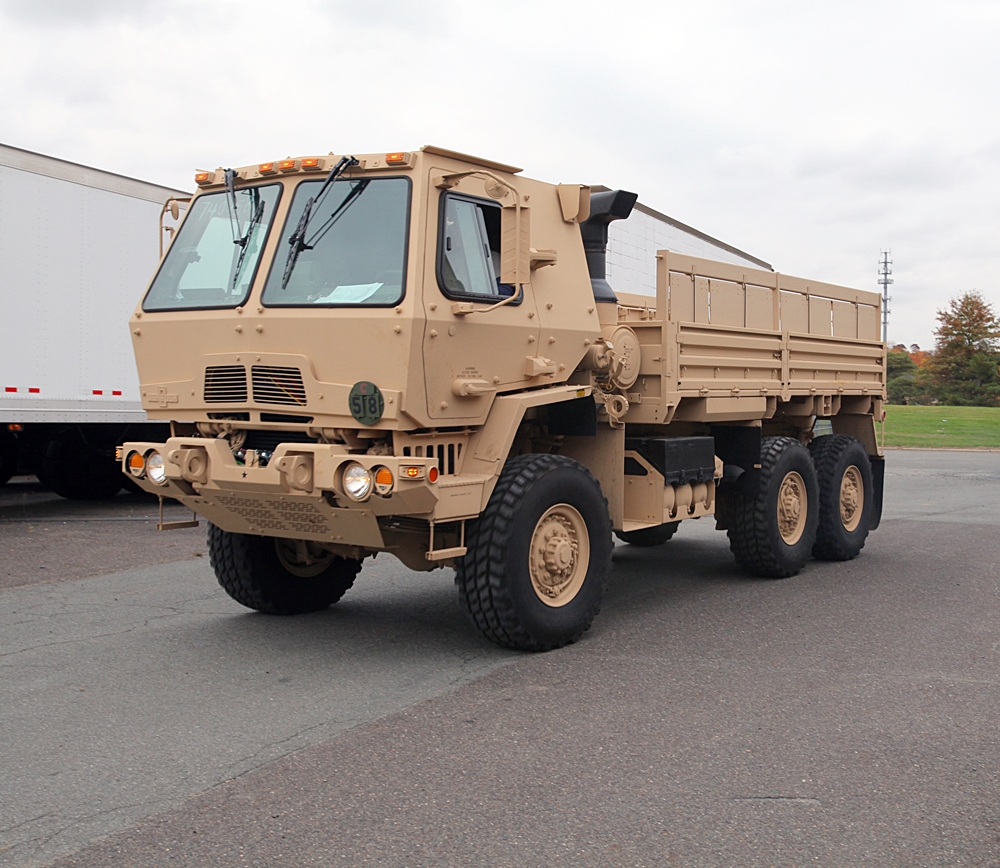

Yeah, it looks like a KW body, but think that may be a transplant or some kind of hybrid. Those front wheels don't belong.
Rear is a single axle w/ duals. Vs dual rear axles. Engine/cab isn't right for a 2.5 ton.
