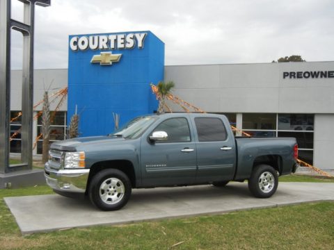

and don't forget the Granit Metallic:
kinda like a blue-gray
