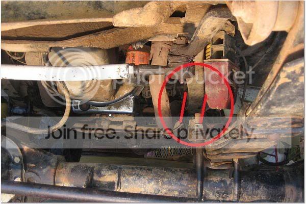

I think your axle is shifting.... look at the pictures below and note the angle of the shackle. Have you done a spring swap on the front?
