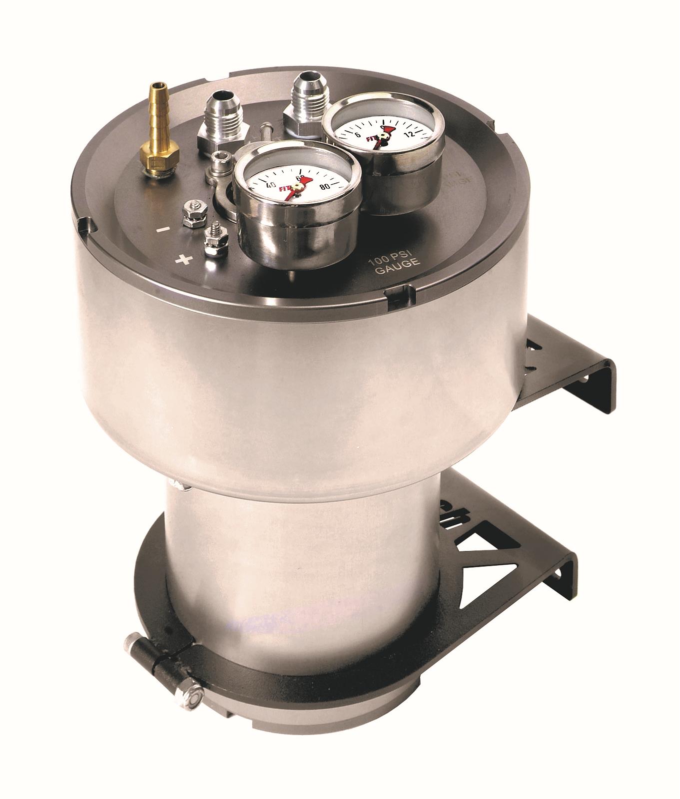

Is that your fuel pump and regulator? Is it mounted under the hood? Why isn't it back by the fuel tank?the ECU isn't the issue, it's the FCC (Fuel Command Center) that's being discussed.
Ah that makes much more sense.it's a small fuel tank with a high pressure fuel pump inside which is fed by the old mechanical fuel pumps that many older vehicles had. Some people are using these so they can avoid upgrading the fuel tank, pump, fuel lines etc.
Will it fit in between the grill and core support?
Yeah way too big.Maybe without AC. IIRC it's a little over 6" round
I don't think that I would want a small tank of gas out in front to get blasted in an accident.
