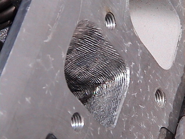

I got a little too carried away today with the porting, I started to grind down the raised area leading up to the intake valve. Now I need one of those 6" long carbide bits to get it smoothed out just right :doah::haha:
I have another question, I didn't see the machinist today, but the valve guide sticks down about .5" can they mill that off? It seems rather large and seems like it could disrupt flow.
I don't think you want to mess with that, it supports a lot of side loading on the valve.

I'm think that a square port intake to an oval port head would have a similar effect as the grooving
Heres my head so far, I'm not sure what I can do with the valve guide yet
Bottom pic is a comparison between the two valve sizes, see if you can guess which is the bigger one :D
I probably only have a few hours left, just finish grinding the exhaust and then polish, then finish all the combustion chambers.
the reason for grooving the intake is to create turbulence... better atomization.... thus why you only polish exhaust sides, not intakes...
I only went about 1.5" into the head, I'm going to focus more so on the aluminum intake. It will much much easier to grove.
