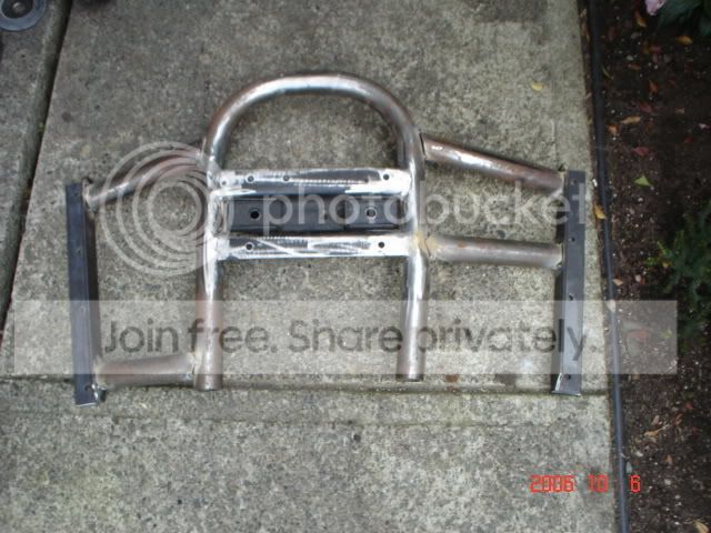

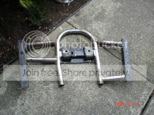

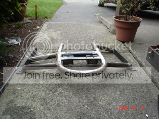

lunch time...and time for a couple of progress pic's.
Definitely not done yet. Still need the mount for under the NV4500. I have a friend coming over with another GM crossmember I can butcher to suit my needs...but he won't be here until after dinner sometime.
Most of what you see will be plated in with 3/16" A36 sheet steel.
Anyways, a little slow going... :dunno:
Rene

Looks good rene! im gonna need to build a crossmember for my 465/ 205 in my 93...not gonna be fun. i might have to steal a few ideas... Cant wait to see what it looks like all said and done.

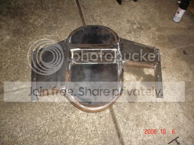

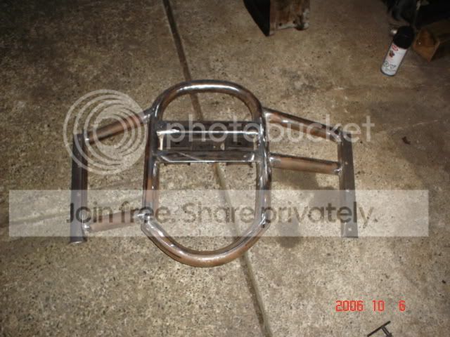

Almost done the crossmember now...couple more progress pic's.
I haven't welded the plating on yet, I need to get the thing up there and see if any of those pieces should be removable for access to stuff or whether I'll be able to reach around them...
I just need to add the mount for underneath the output housing on the NV4500, paint it and bolt it up.
Rene

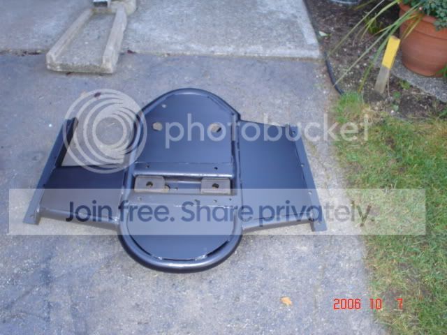

Finally done this part of the build. Technically I'll be done when the floor is back in...but that's sheet metal and nobody cares about sheet metal right??:D
Crossmember finally done. 2 full days to knock this out...of course that's working at home, single carport and about 10% of the tools I'm used to having at hand. Also trying to work around kids, neighbors etc etc. Overall I'm happy with the way it turned out...
And finally bolted up for good. Pic's are a bit dark...I'll try and snap a few better pic's tomorrow when there's better light.
Also got my triple sticks hooked up and adjusted to suit. The NWF kit is very easy to install and work with...and the shifting is very crisp (so unlike the stock 30 year old crap) :bow: :bow:
So, tomorrow i'll be onto some boring stuff like mounting my clutch/brake bucket, gauges (finally) and remainder of dash. Might do the U-joint steering shaft while it's all apart too. Then relocate the front shackle hangers as per Jekbrowns write up.
Currently waiting for my Bilstein 5150's to come in, as well as all my hydro clutch junk.
Rene
