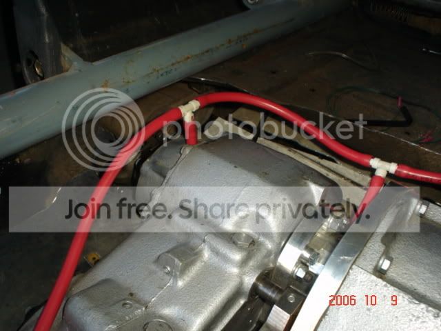

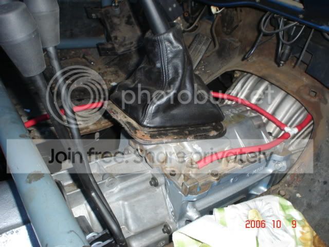

Did all my vent lines today. I used a 25' coil of 1/4" airline and some 'T's I found in the help section. The vent starts at the 14 bolt rear, up to a 'T' on the 205, to a 'T' for the 203, to a 'T' for the NV4500 and terminates in the engine compartment.
I need to add a couple of clamps here and there, and make a mount for some sort of inline filter on the firewall. I'll also run the same line up to the filter from the D60 front.

:bow: I was told the vent lines are for disapating heat rene. Im not sure if they came from the factory for that reason.. but you have all your components running out a 1/4 inch lines... if i were to do it id do 1/2 inch, although after thinkin about it... id keep them all seperate
let me know why ya decided to route them like that and maybe I will do the same..
btw, love those shifters:k5:
The vent lines are for thermal expansion. As the tranny, T-case, diff or whatever heat up the air inside expands. Without a vent it would build up pressure and puke lube out through the seals. 1/8" line would be enough to be honest...in fact the vent hole for the 205 is probably closer to 1/16" diameter. No need for a massive line like 1/2".
I ran them together so I could use one common venting location as high up the firewall as possible. This will keep the water out of everything if I do any deep water fording. 5 separate lines would be a bit messy IMO.
