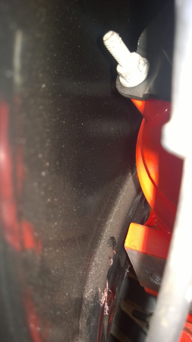

I have the same crossmember and ls mounts from TNA. They work really well! On mine I had to pull the engine all the way forward to clear the firewall.
Did you have to move the tranny forward at all to bolt up the block with the engine being all the way forward?
I used TNA's transmission crossmember as well so had to drill new holes anyways. It use to be a th350 / np203 and now 4l60e np241 so not sure if it moved anywhere from stock or not.
What holes did you have to drill? I bought the x-member and the LS mounts both from him. I thought I read somewhere that the newer x-member that he makes (the one I have) doesn't require drilling holes in the frame.
I think I have the older version of the transmission crossmember. I had it for a while and only recently installed it. The 4l60e is longer than the th350 so I think I would have had to drill new holes no matter what
I believe what @Rugby_7 is trying to tell you is he has a TNA TRANSMISSION crossmember in addition to his TNA ENGINE crossmember and the transmission crossmember is what he had to drill holes for hence he doesn't know if the stock trans crossmember could be reused in the original location. From your pics it looks like you only have the ENGINE crossmember.
Gotcha! I have a SM465 in the truck now and plan on keeping it there? I'm hoping everything will bolt up just fine in terms of keeping the gearbox where it sits from the factory.
Yessir, I only have the engine x-member and LS mounts. Didn't see a need for the trans x-member. We'llsee how everything goes when I get everything ready to bolt up.
Darren was saying (or I read it in a thread on here) that an LS rocking his x-member and LS mounts would allow the factory trans to stay in the stock location. I'm assuming the newer electronic transmissions may have the mount portion of it where the x-member goes in a slightly different location than the old cheby stuff.
