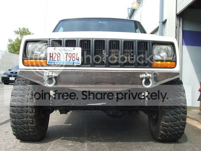

I think I'll be building front and rear bumpers that resemble the one in the photos below.
My first attempt at welding can be seen below also.
.35 flux core wire on 1/4" flat stock on 110v using recommended settings. I'm still working on the 220v install in the garage and I need a helluva lot of practice on fusing metal together.
