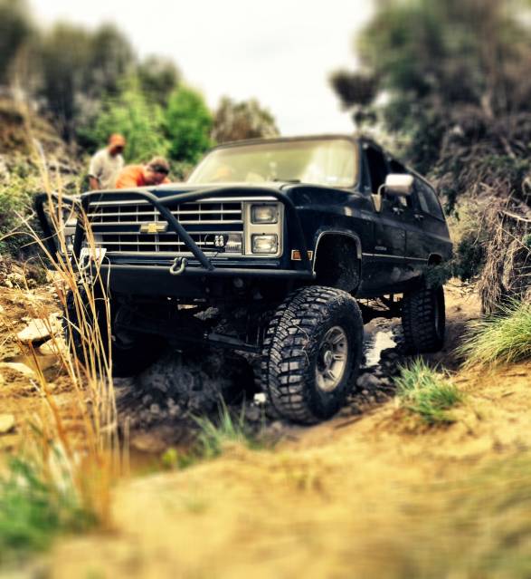

View attachment 230753 This is my first car.

Nice Sub! Good story too! :thumb:
Your pictures look cool... kind of blurry background makes it look almost fake!
