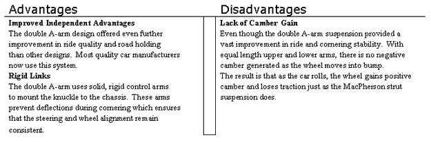

Another good read.
http://www.automotivearticles.com/123/printer_Suspension_Design_Types_of_Suspensions.shtml
Equal length control arms,
[FONT=Verdana, Arial, Helvetica, sans-serif][FONT=Verdana, Arial, Helvetica, sans-serif]After designing, implementing, and experimenting with the equal length double A-arm suspension it was vary apparent that all that was needed to make the double A-arm front suspension satisfactory for high performance use was to determine a way for the suspension to gain negative camber as it was compressed. (I.e. during chassis roll) The problem was solved by implementing upper and lower A-arms of different length. The resulting unequal length double A-arm suspension was born. [/FONT][/FONT]
