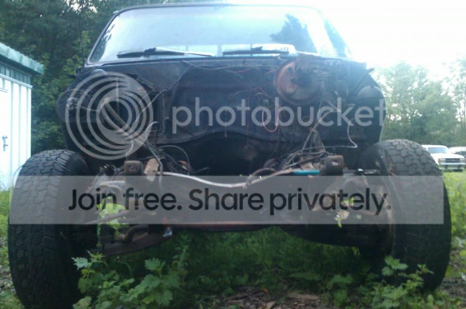

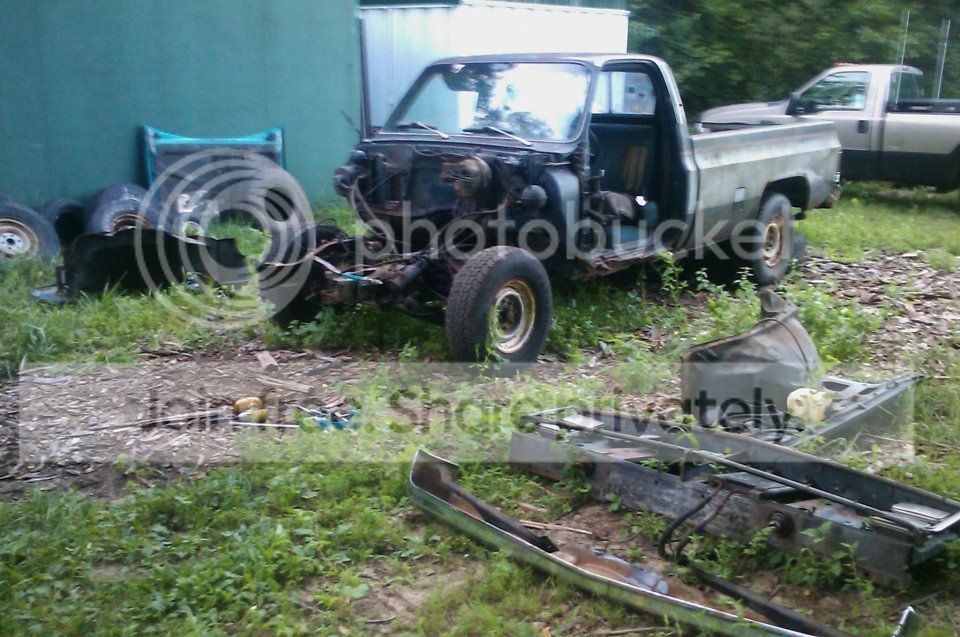

Oh yah forgot. When I got to the shop at 7, it looked like this half hour later :D
